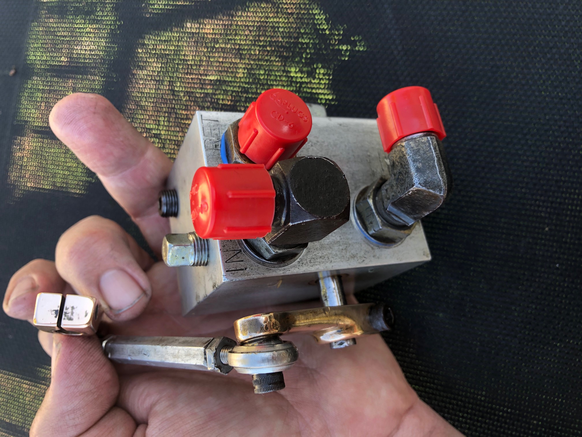

I got a call out of the blue from a good mate, and the chance to buy some McGee gear from an old Speedway gentleman. Hard to say no, but had to draw the line at a set of McGee injection to suit early Falcon 6 (even I have limits... mostly :mrgreen: ).

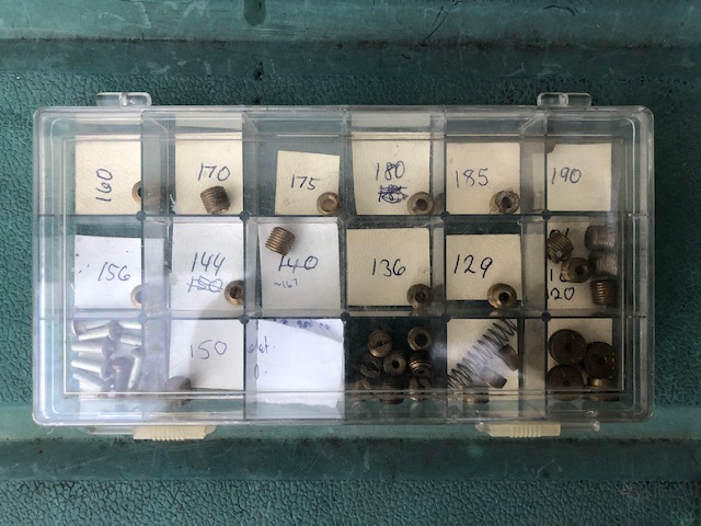

Box of assorted McGee pills. This will be damn handy for tuning the meth monster. Screw-in like Enderle, but different thread. Also has some adaptors to connect NPT hoses to McGee injectors.

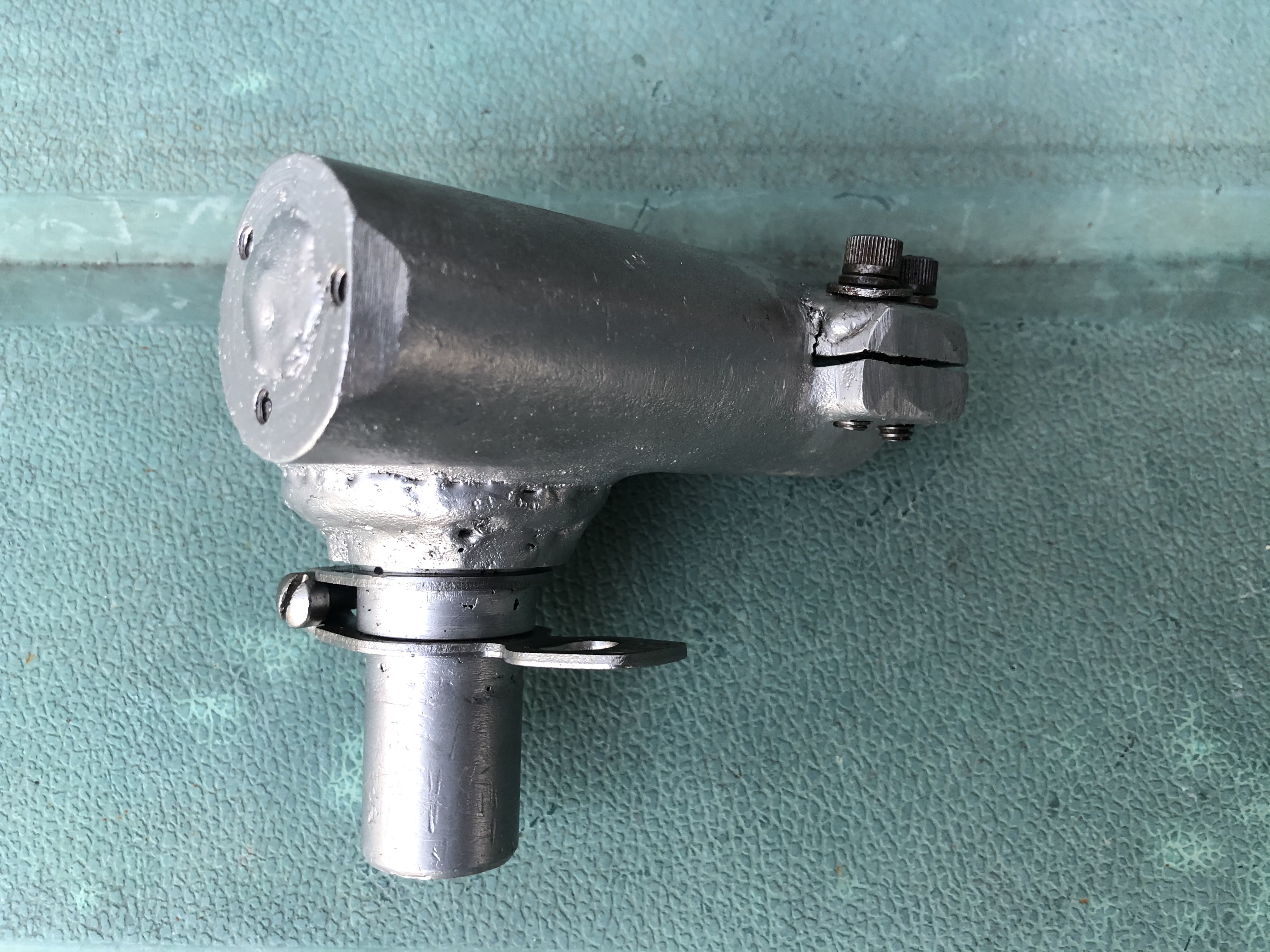

McGee angle drive to turn the dizzy sideways. Invaluable for the Repco heads, where clearance to the inlet manifold is nasty. This one has snapped the spigot and had it rewelded, just like my first one. Needs the driven shaft made up out of an old grey motor cam (see below).

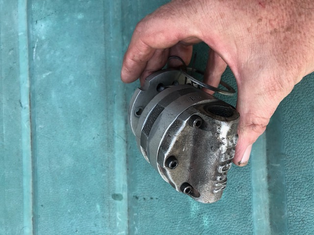

Hex-head fuel pump, red motor era.
