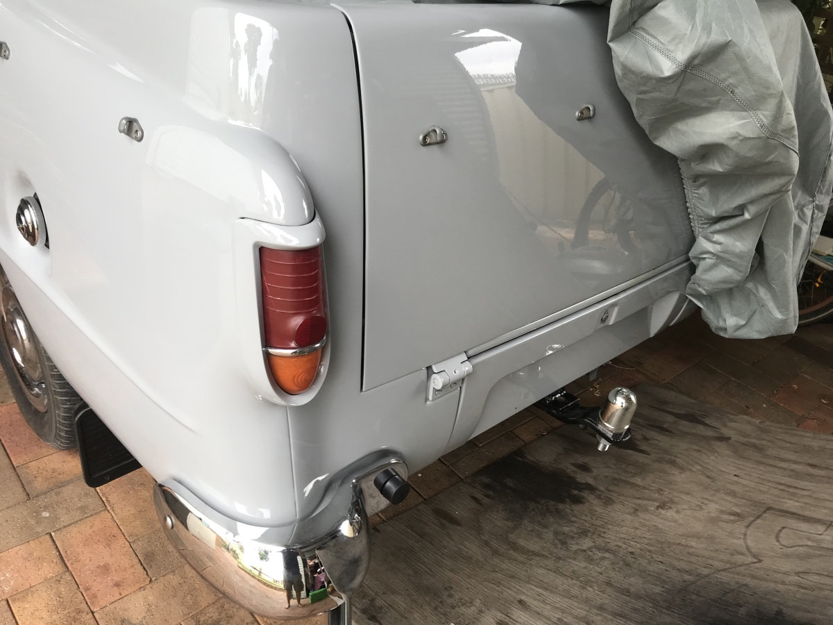

couldn't you use a 5mm nutsert and just screw the 5mm lift a dot clips from the webpage link into them ? Looks like a simple fix to me .....
Re: Harv's (Grace's) EK ute
Posted: Fri Feb 02, 2018 12:36 pm
Now that's good thinking!
... been looking for an excuse to buy a nutsert gun :mrgreen:

I'd be interested to see a pic of how those thingoes fit on the tailgate rods too. Mine forever seem to be in the wrong place and I need good coordination to keep them out the way when you close the tailgate without jamming your fingers.
Any chance of getting some updated pics?

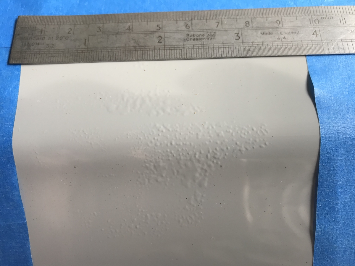

Have had some blisters come up on the drivers guard peak, about midway along the guard :( . Suspect it may be humidity blisters. Have sent some photos to the panelshop, will see how they go.

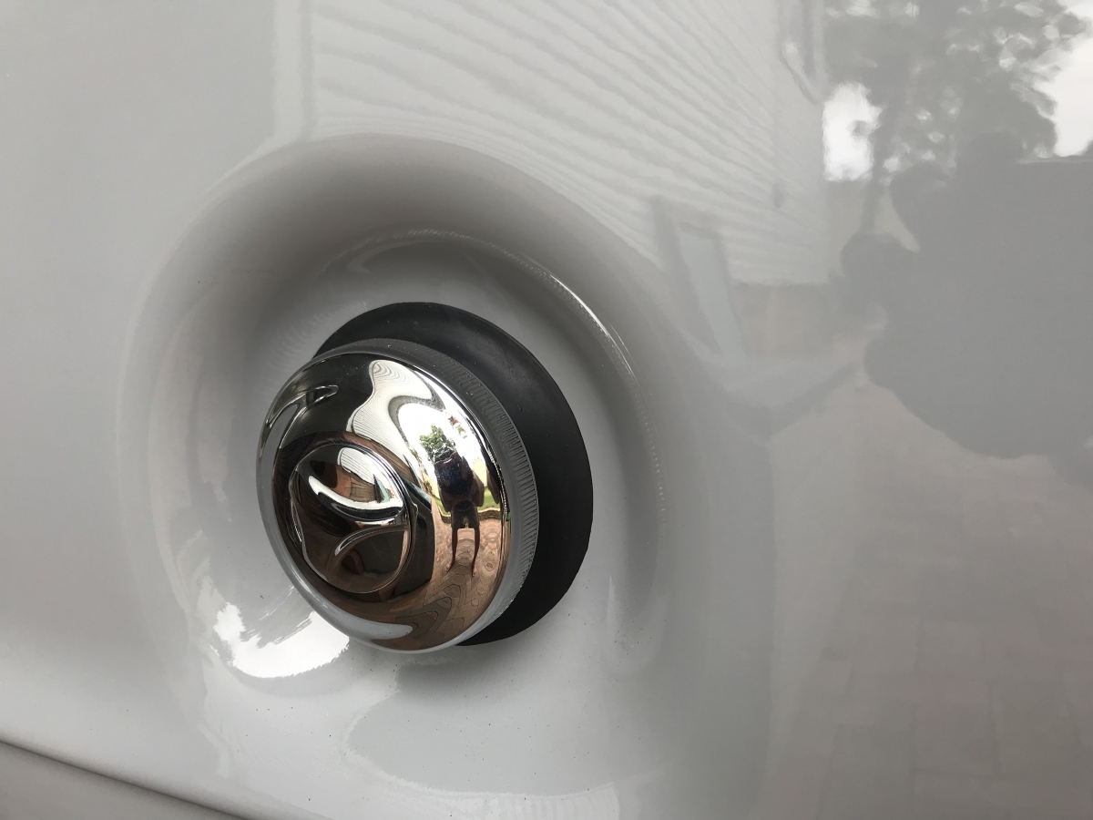

Some fiddly photos below for interest (I reckon that petrol cap looks cooler than penguin pee):

I would have thought humidity would be even across the surface like little pimples. That looks like the surface had some compound residue on it. They should fix it in any case one would think.
The petrol cap shot is art. Not to mention the bow legged selfie. Are you able to access the spare with the tow ball on?

Not sure about the paint... I don't know enough about painting. The conversation I have had with the panelshop so far has been pretty good.
Love the smooth, curved lines on the utes around the turret, rear quarters and petrol cap. Even in simple grey they look good. My bow legs on the other hand are not so easy to look at :lol: .
The towbar is giving me grief. The two small horizontal brackets that bolt through the subframe under the tailgate stick out just enough that they foul the sparewheel door. Not sure there is enough meat in the brackets to trim them... they may have to be cut off, and new brackets welded to the towbar. The towbar tongue has to come off to open the sparewheel door fully too. This is painful - have to carry a spanner in the cabin to get the tongue off to access the rest of the tools in the sparewheel compartment. I'm thinking about getting the brother-in-law to replace the tongue with a hayman-reese type square hitch, secured with a pin. Not sure I like the idea of a square hitch on an old car though.

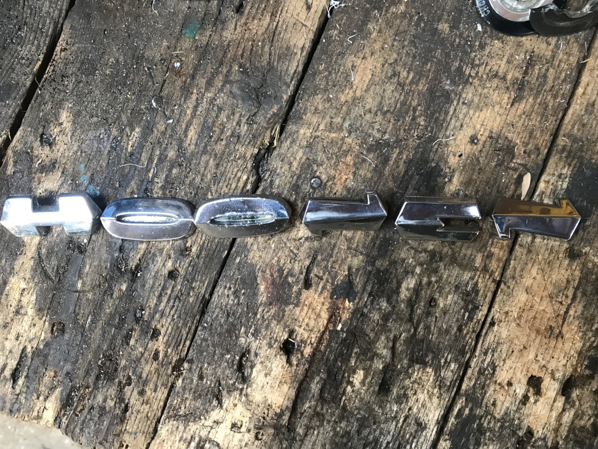

I bought some badge clips (small metal tubes) some time back to put the bonnet badges on the wagon and ute. Sadly, they are too big to use... gotta have another talk to Rares and see if they have the right size ones.
Thought about putting these on instead of HOLDEN though :mrgreen: :

That’s funny I’ve been thinking of doing that with the bonnet script just the other night.

I always wanted to put HOLDON badging on my ek !
Paint looks like trapped solvent and is common in 2 pack if that's what it is, it can happen when there is not enough dry time between coats or to thick a coat. The chemical reaction seals the top before the solvents can evaporate. Very technical this style of painting !!

Looking very tidy indeed. Let's hope it is just that small section of paint on the guard that requires atttention. Was surprised to see the tonneau cover clips mounted so far down from the edge. Unfortunately on my ute someone mounted them too far toward the top :thumbsdown:
Look forward to seeing some more pics.
