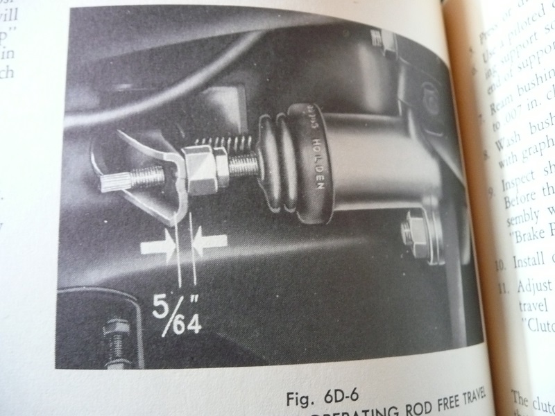

Thanks for your reply Greg. I think you're right, I think something is wrong with the clutch fork adjustment inside the bellhousing. Is that able to be adjusted? I am wondering that this car may have the wrong clutch installed at the moment.
I am able to adjust the push rod back far enough to have the desired 5/64" (nearly 2mm) play between the pivot ball and the fork, so I'm confident that will be ok but I am suspect of the fact that the rod has been shortened by someone. Probably trying to make the dodgy clutch work.
To answer your question, yes, the clutch fork feels to have no freeplay. That is: it feels to be engaging the throwout bearing in it's resting state, even with the slave cylinder off the car.
I am also suss as the images from the workshop manual show a lot more adjustment available along the pushrod for the slave. oz-ek posted the picture I mean above, you can compare to what my picture looks like. I was happy to write that off as my cheapie aftermarket slave cylinder body being a different depth, or something like that, but now I'm thinking I might take the gearbox out for a look.

That looks a bit wrong. Unless you have a very thick clutch setup fitted? I would try turning engine by hand and see if things change before firing up. If not then fire up in neutral with no clutch engaged. Might be a bit of loose facing stuck in there somewhere which is spacing the fork out from the thrust face.

I would be stoked if that was the case, but as it sinks in that someone else has modified the slave pushrod just to get some freeplay, I'm betting the wrong clutch is fitted. Too thick, as you say. I will undo all the bellhousing bolts and see if the trans pushes back from the motor a little... then go hunting for the cause.Errol62 wrote: Fri Jun 09, 2017 12:45 pm J
