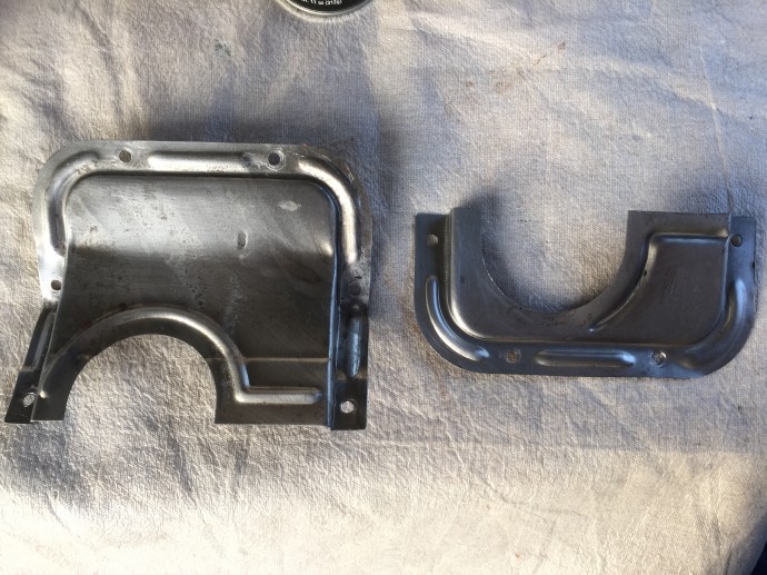

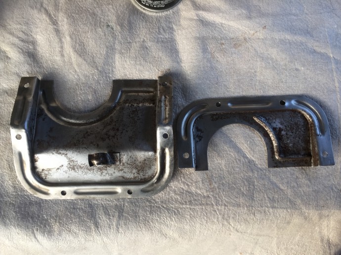

Been quite amazed at the condition of the metal in this old girl - these are the firewall plates for the steering column - soaked them in a CT18 and Shift-it bath over night and they came up clean as a whistle - best to use gloves though as it does kill the first layer of skin - LOL.
coat of chassis black and they are like new again.
