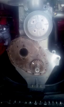

OK....Update..... my front engine needs to lower ( incorrect crossmember assy for the engine ) so the fan will not slice my radiator hose. I opted to swap the engine cover plate. This of course requires timing gear removal and associated components, so
My timing gear has arrived after being delayed etc...we all know the story....take your money then tell it will be late
Anyway, motivation is high to get back into it again!
Today:

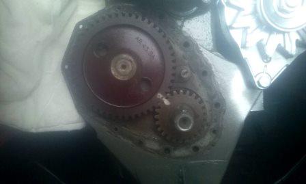

Harmonic balancer removed,
Timing cover off,
DIY gasket made from old one as a template
Cleaned the replacement front engine cover
Drilled to holes to accommodate existing and new front engine mount....
Continued tomorrow (bloody rain better let up)

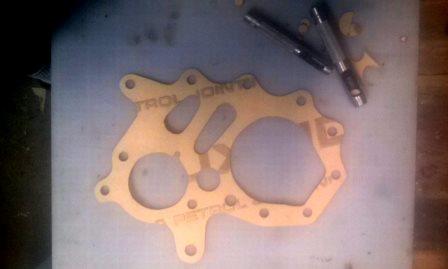

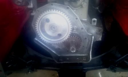

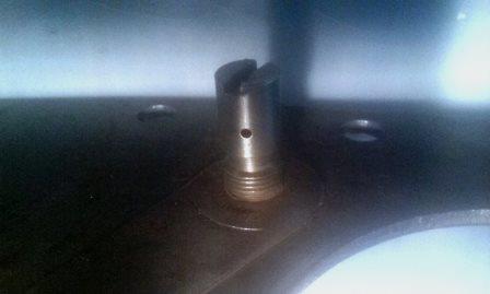

- Oil delivery hole (mentioned in the guide)
- CAM00494.jpg (19.64 KiB) Viewed 2958 times
- Cover plate to be fitted with drilled mounting holes
- CAM00491.jpg (40.88 KiB) Viewed 2958 times
- DIY Gasket
- CAM00489.jpg (19.87 KiB) Viewed 2958 times
- Timing cover off
- CAM00488.jpg (19.62 KiB) Viewed 2958 times

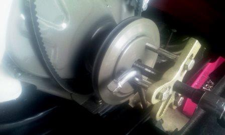

- balancer coming off
- CAM00486.jpg (21.72 KiB) Viewed 2958 times

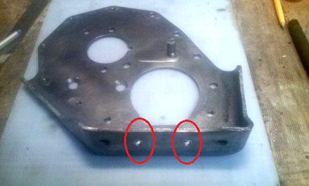

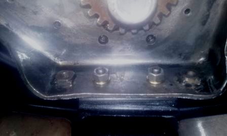

Well the engine sits lower and looks as it should with the front engine plate being replaced, it came of a 138 engine so holes needed to be drilled for the 132 engine mount. Pretty happy with the whole job, need to set mechanical timing. From what of I gleaned its rocking #6 cylinder, this ensures that #1 is ready for firing, the flywheel ball is aligned with the pointer and the rotor button is pointing to the mark on the edge of the distributor, representing the #1 firing position.
No real dramas expect a rocker assembly bolt sheared whilst torquing. ( drill and ezi - out should sort that )

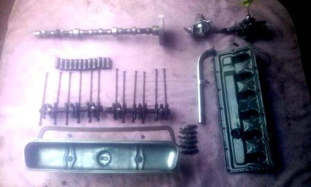

Rockers removed
Distributor and Fuel Pump removed
Side Plate and Breather Pipe removed
Pushrods and Lifters removed
Camshaft removed

- All the bits removed
- CAM00502.jpg (25.3 KiB) Viewed 2928 times

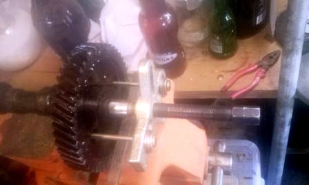

- Pulling the ring gear off
- CAM00495.jpg (26.32 KiB) Viewed 2928 times

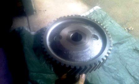

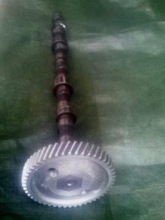

- New gear
- CAM00496.jpg (21.89 KiB) Viewed 2928 times
- New gear installed using a jack for a press setup
- CAM00497.jpg (23.71 KiB) Viewed 2928 times

- Holes drilled to fit eng mount
- CAM00503.jpg (20.69 KiB) Viewed 2928 times

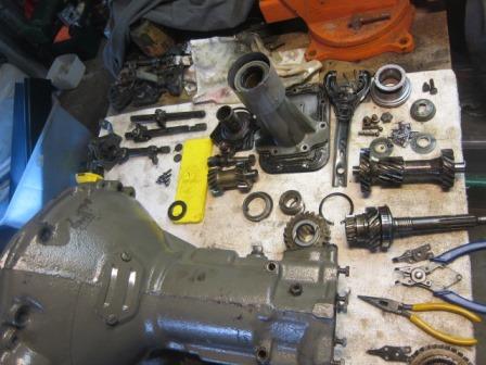

Selector lever, control and shift rods connected...minor adjustements needed ( a small problem with shifter lever on gearbox going into 3rd ) helpful replies are welcome !
http://www.fbekholden.com/forum/viewtop ... 26&t=21266

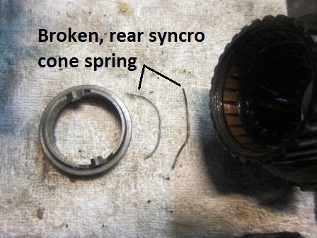

OK...I stripped the box and I reckon I found the culprit....A brocken rear synchro cone spring
It had caused the gear meshing to sieze / jam this action.
Now to rebuild the crashy!
