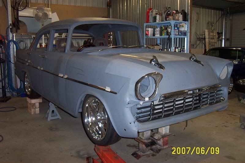

Hey guys,
Finally got all the central locking set up in the doors. Now to start with the full length electric windows.
Also have finished making all the brake lines.
Have gone against the 57 Chev door moulds that I was playing with and came up with my own look, which I think looks better anyway. Still looking for a pair of EK front door moulds if anyone can help out.
Im going to do the car 2 tone, white roof and side stripe but still undecided at the main colour. Maybe the photo guru's can show me some ideas with what Ive got.
Have just added a couple of pictures just to give you an idea of how it will look in the end with the side moulds, hood rockets and Chev headlight peaks.
Cheers all
Mal
Malcolm W.
Looking good now Malcolm. Side trim works fairly well as it flows with the car. I'm enjoying the updates.
southcoastkustom
Posts: 537
Joined: Tue Nov 28, 2006 11:20 pm
Location: Adelaide, SA
Post by southcoastkustom »
I agree Malcolm, she sure is hitting the spot for me too..I was originally sceptical of the gunsights, but they have been done poorly by others before you! I reckon she would look fine in an old sKooL musty green or dusty pale blu with the white roof and flash...but that's just my personal love of the colours of the era :roll: . Thoroughly enjoying watching your updates :mrgreen:
not too shiny thankyou.
