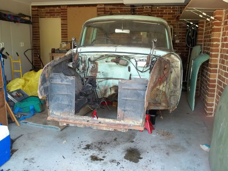

Just have to remove the doors, front and back windows, the side trim and wiring loom
and its off to the blasters in a week or two. :thumbsup:

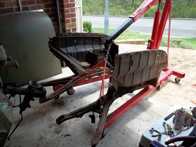

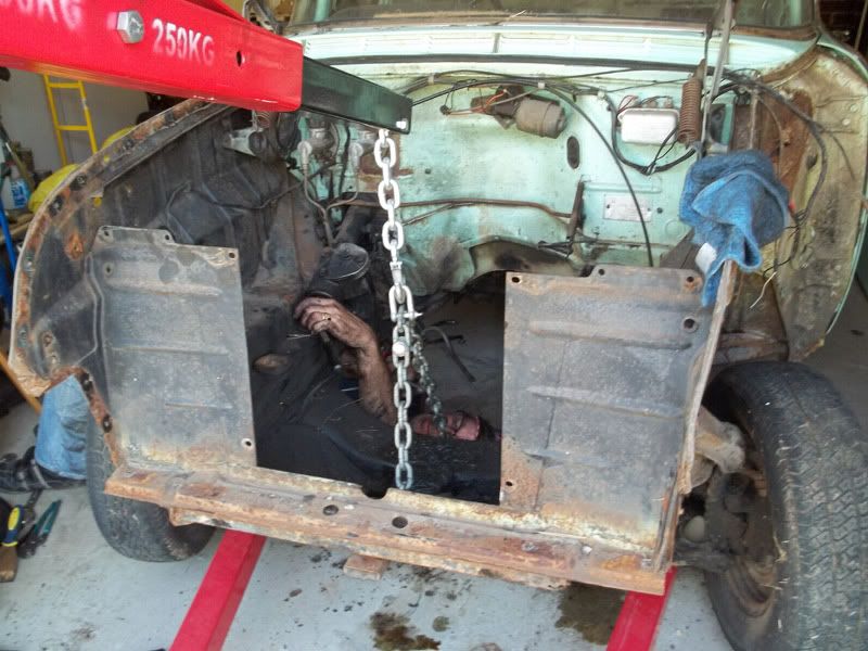

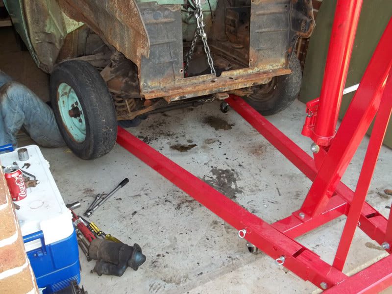

Using the engine hoist to hold up the front end while we get it out.
Using the engine hoist as a trolley for the front suspension.
Need to get this cleaned before the EPA come around. :lol:
Before we removed the front

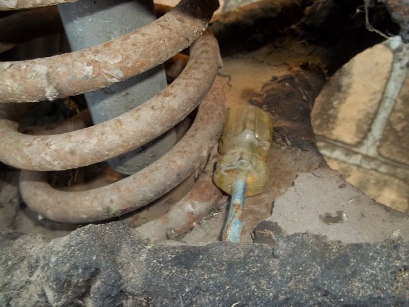

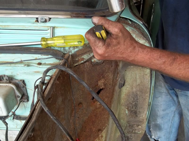

Mmmm lost screwdriver, wonder how long thats been there?

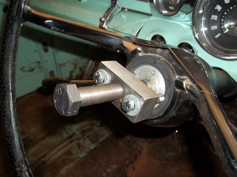

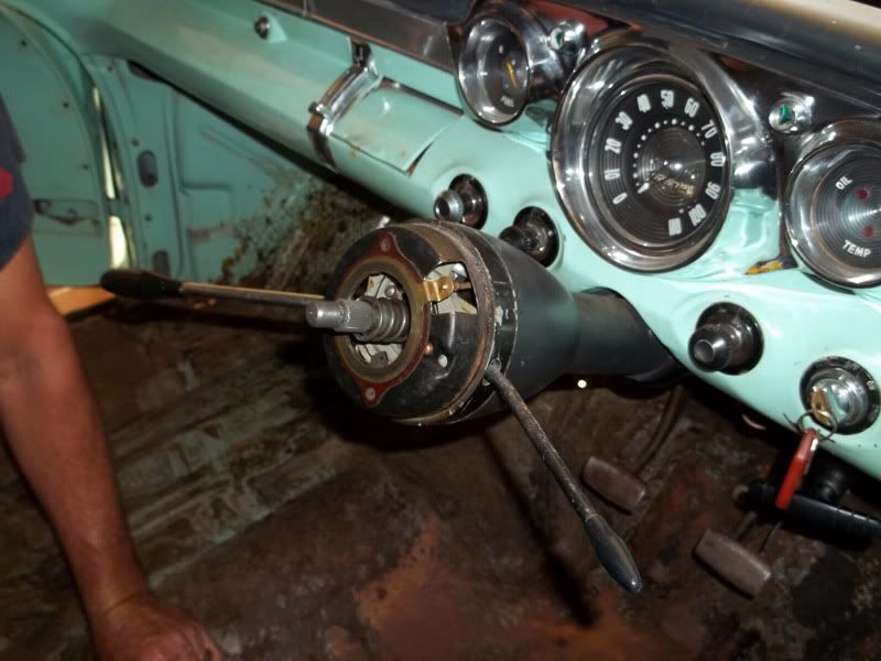

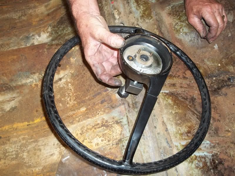

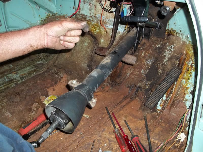

removing the steering wheel
another pic to remember.
The little pin is broken on the wheel but I have a good one

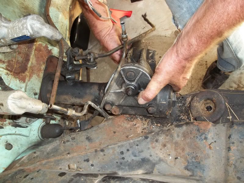

Playing with the steering box so we can remove the front.
Had to dig through this to find the bolts!

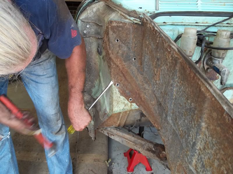

suprisingly after removing the inner guard there was no rust on the firewall
Same on the drivers side inner guard.

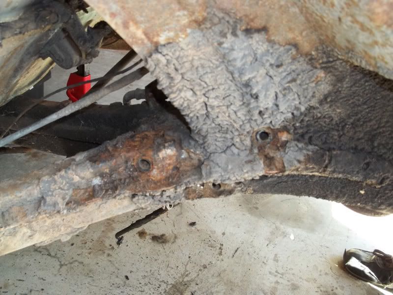

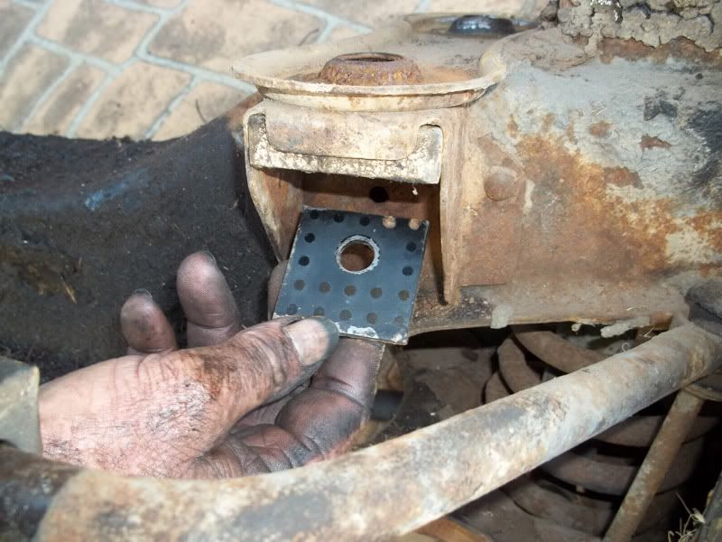

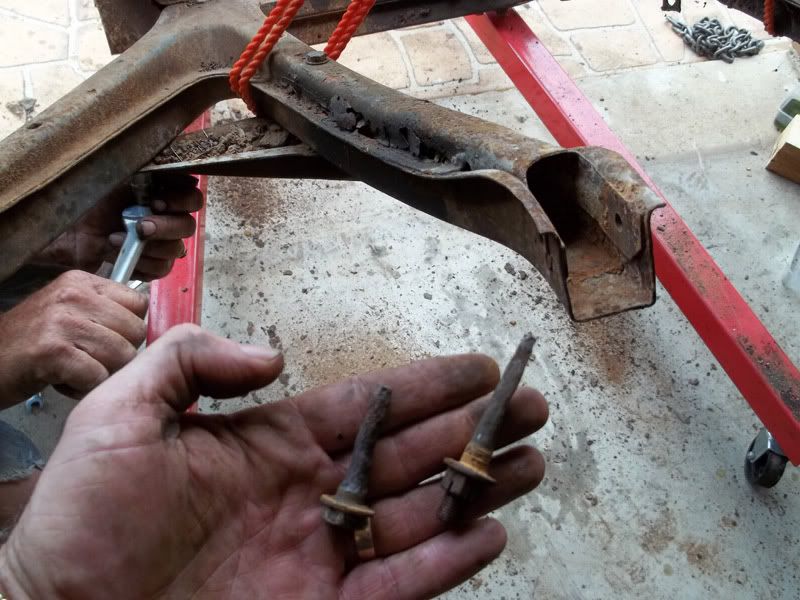

these came out of the bottom Y all the damage is on the passangers side.

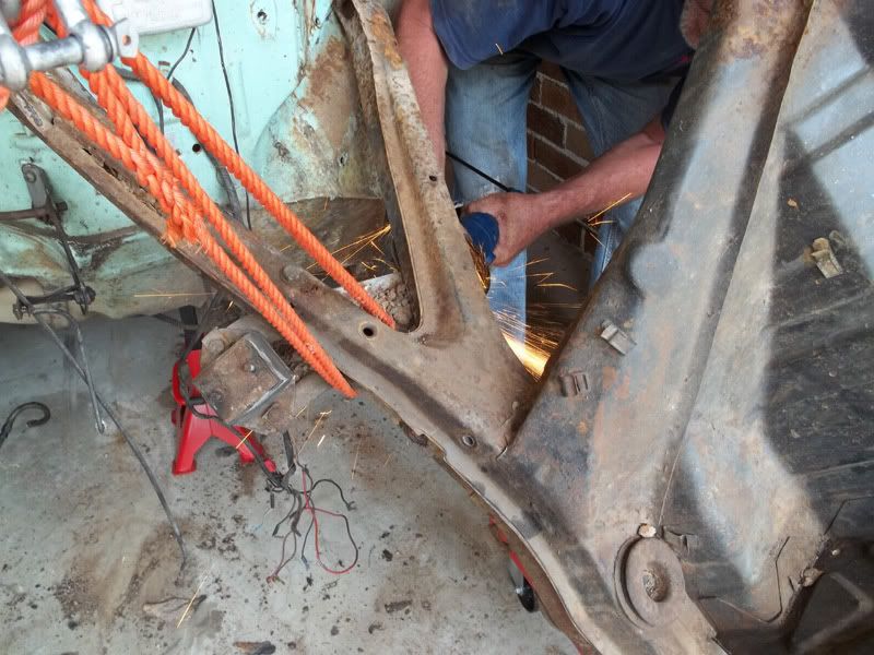

The front end free at last, 3 hour job
That connects to the steering box!. bugger. deal with it later.

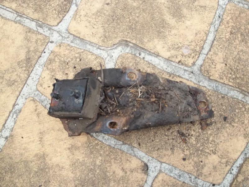

One of the rear engine mounts, check the dirt in it.
as above

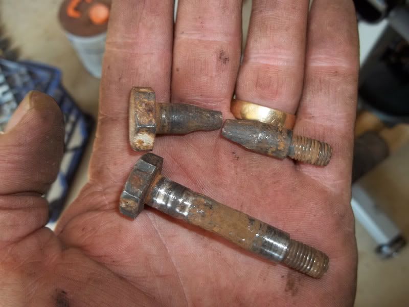

Some bolts we had to cut off.
steering coming out.

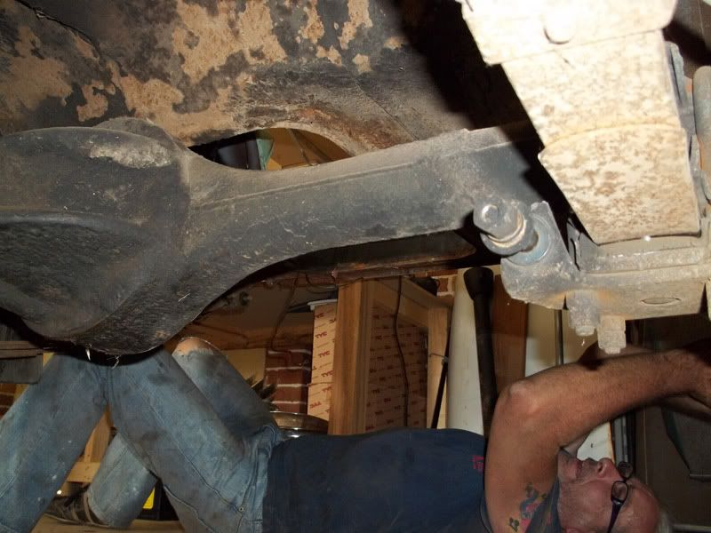

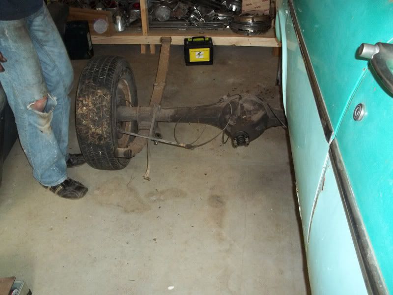

Unbolting the rear springs

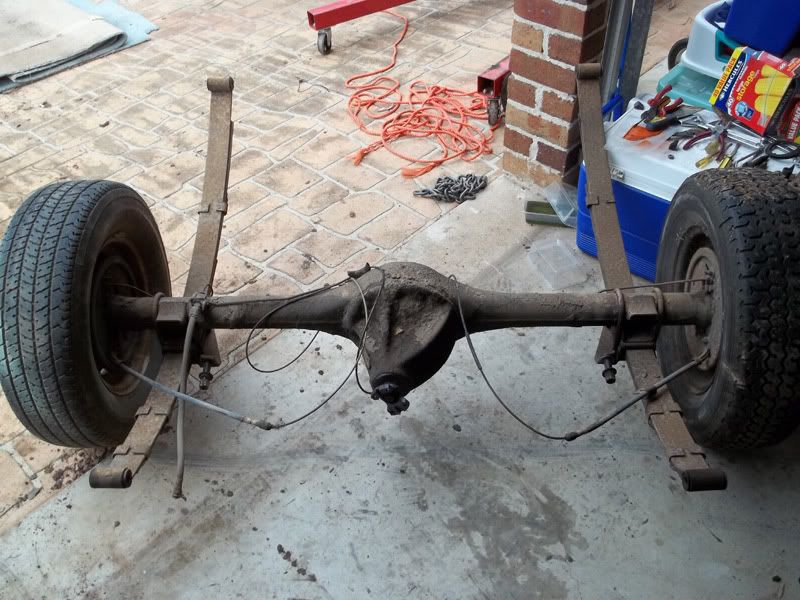

Pulling the rear out.
Rears out at last.

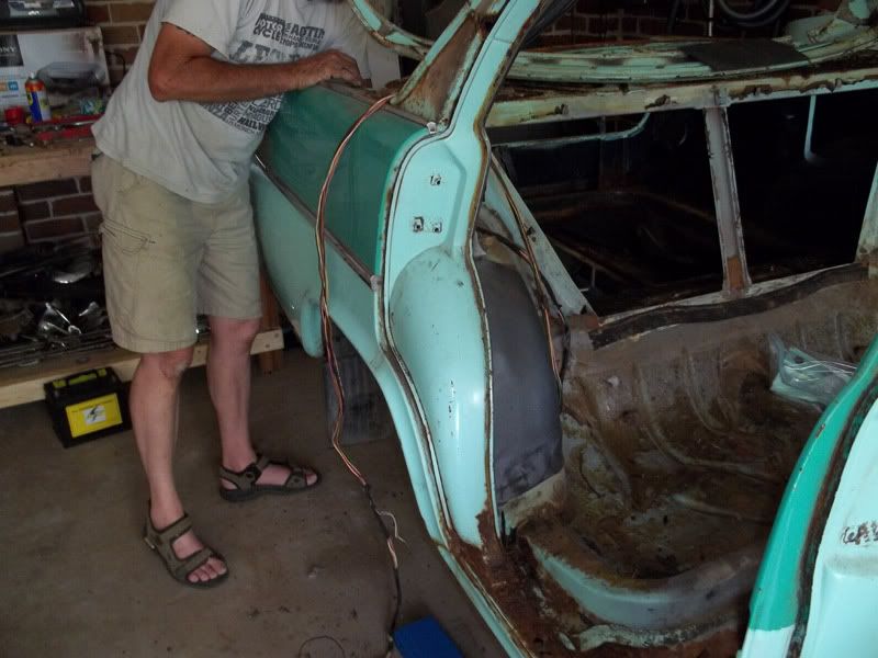

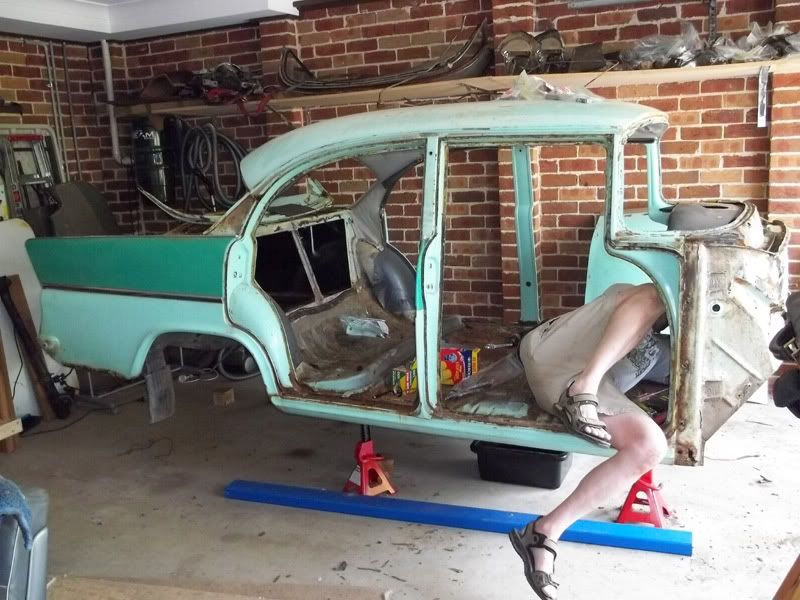

Update day three 05/01/2012
Well almost finished it today just the side panel stainless trim to remove and the interior.
Thanks to my mate Graham with all the tools I didn't have, couldn't have got this far, so fast, without them. 8)
Another 100 pics taken today and I'm sick of plastic bloody bags and tags. :|
We found some hidden rust but not as bad as we thought it would be.
Looking at Stewarts "Old Timer" thread I was of no allision of what we might find. :P
Also a lot of today was done twice one on both sides of the FB so it was a far bit of work
And the doors, well there's 4 of those.
Ok so I've had the car for 5 months and this is were were up to, enjoy the pics. :D

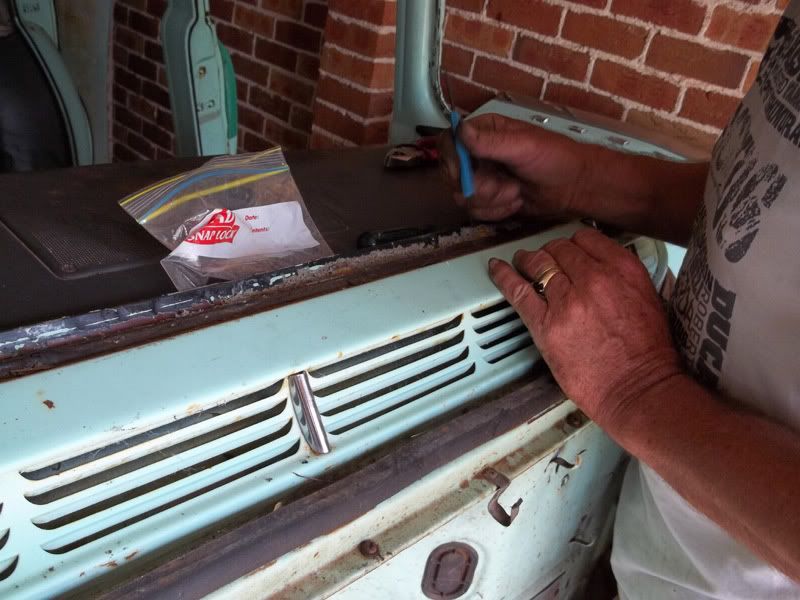

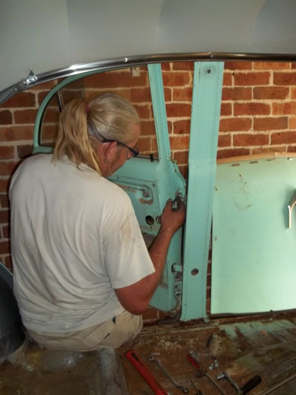

Stripping of door rubber.
Graham removing another door.

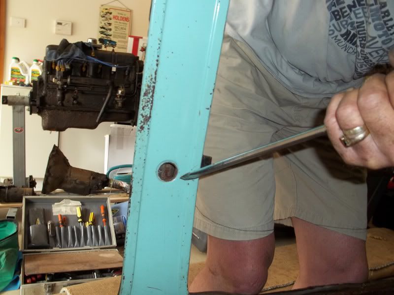

Phillips head was screwed on this one

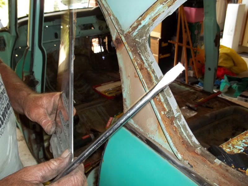

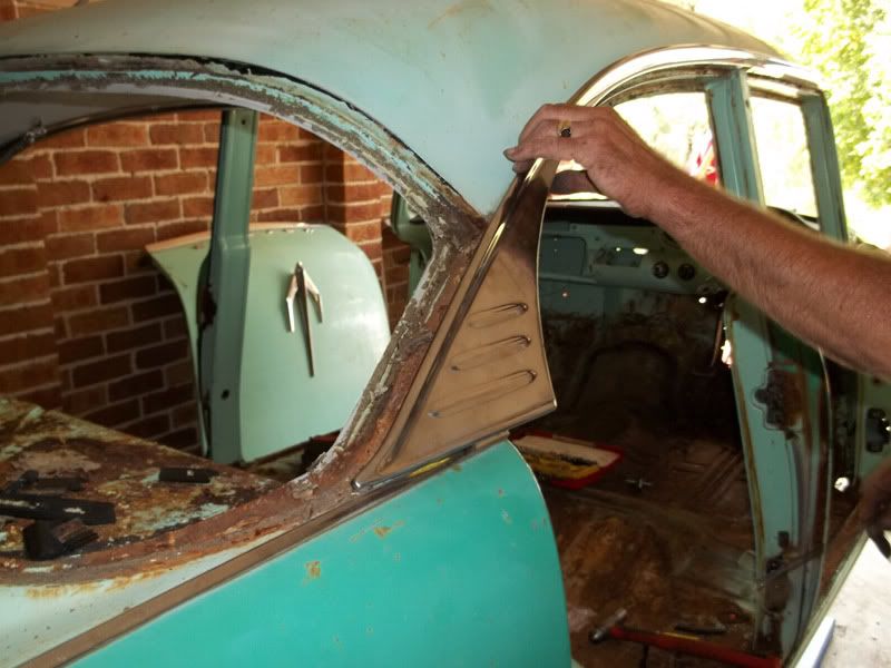

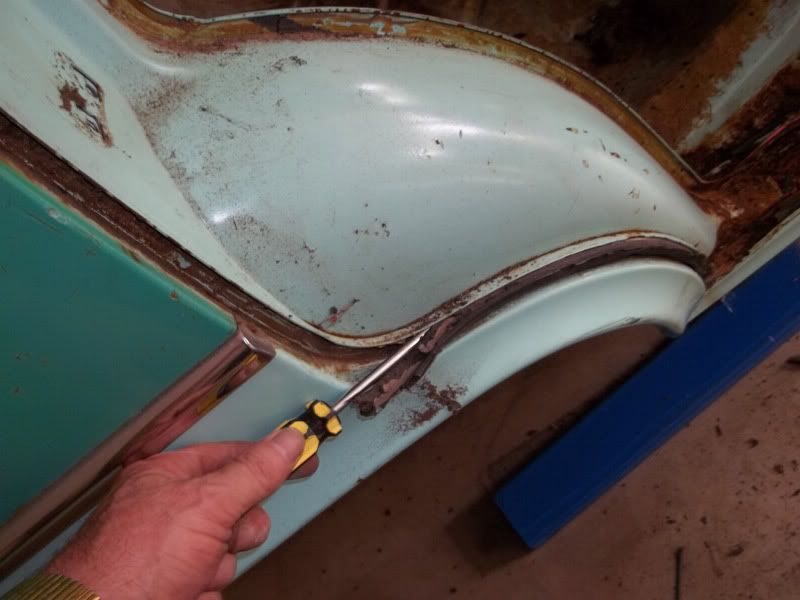

Removing one of the stainless steel dress parts

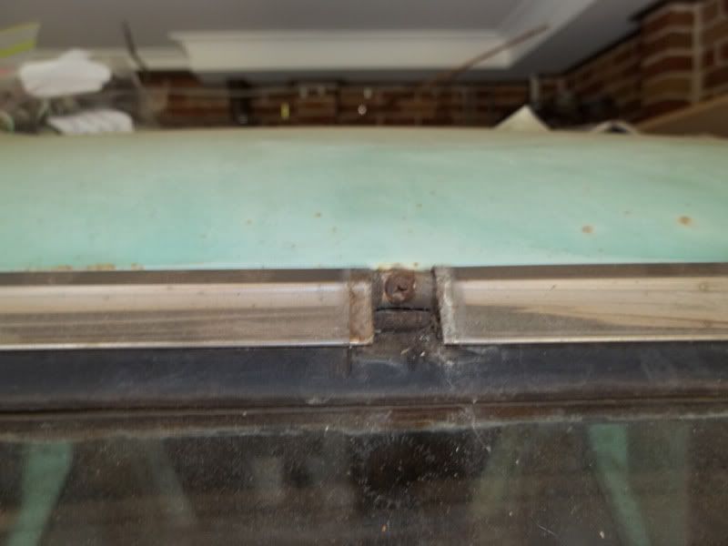

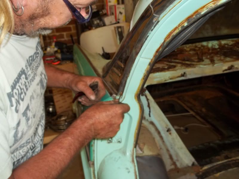

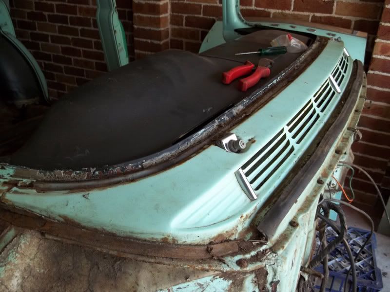

Carefully unscrewing the roof gutter strip

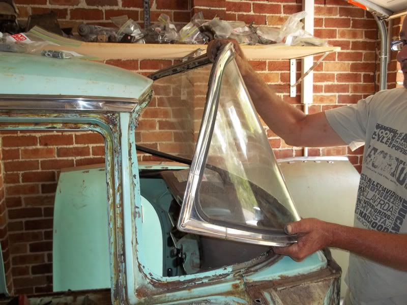

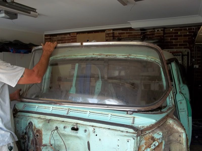

Starting to remove the front windscreen
Not forgetting this screw
It's out!
Stop Graham I'll take that shot from another angle!
One windscreen put away
Looking the part now,
Back window removed
It's put away also

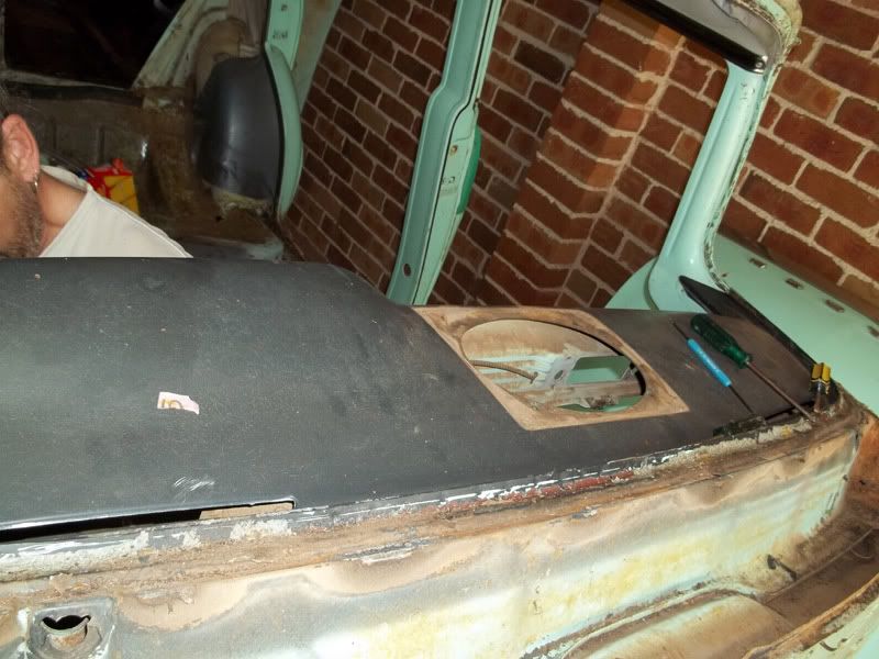

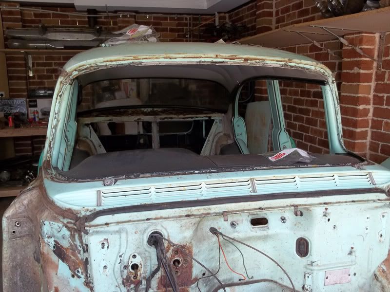

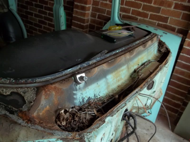

Couple of pics of the back window opening.
Removing trim.
Another piece gone

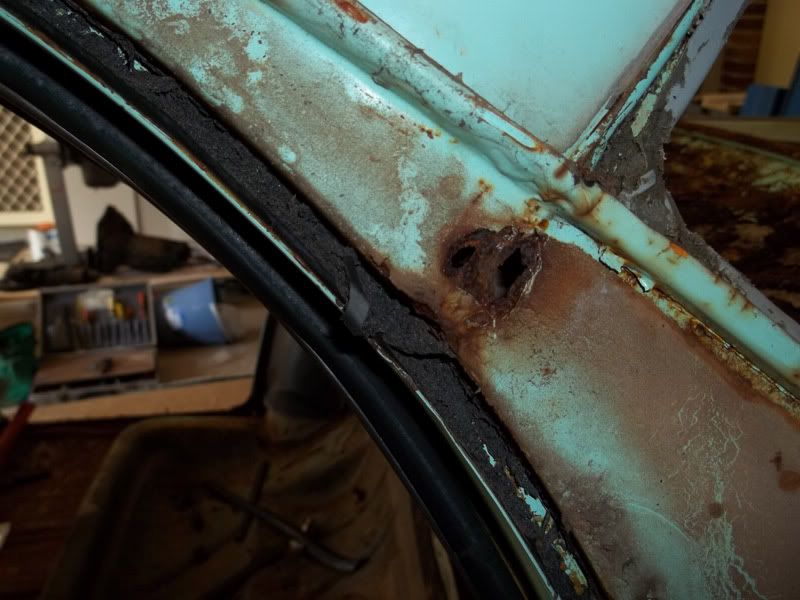

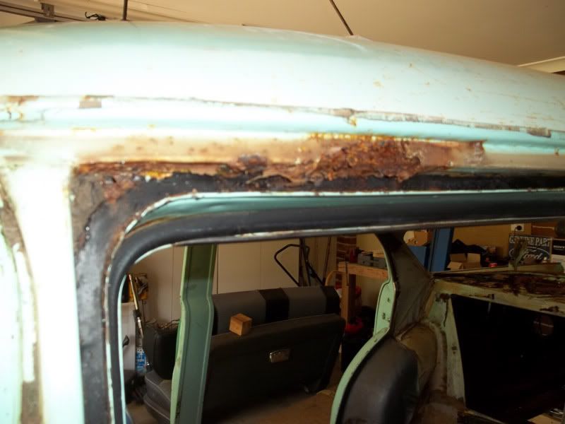

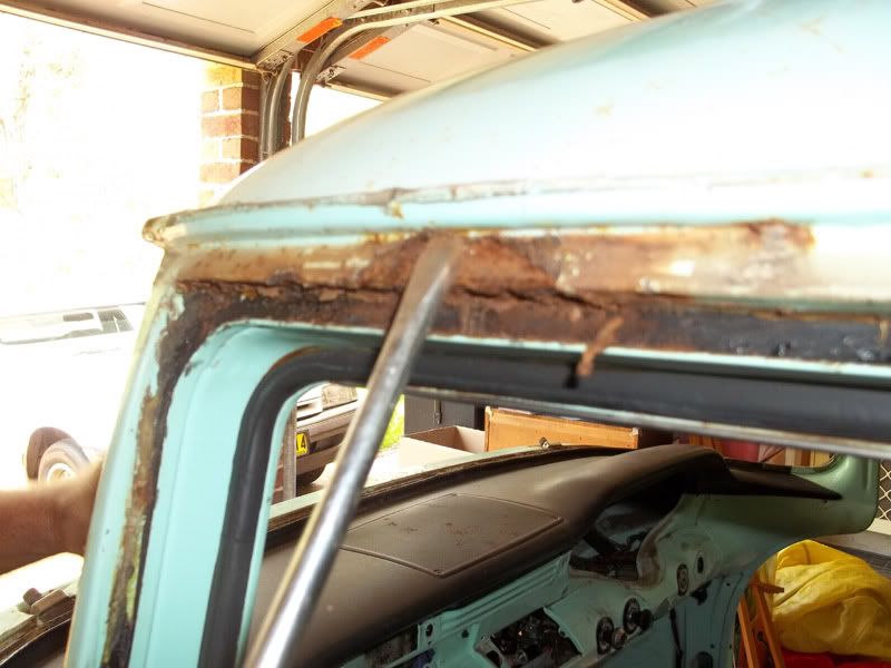

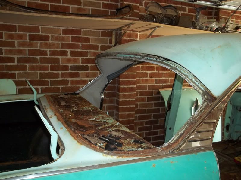

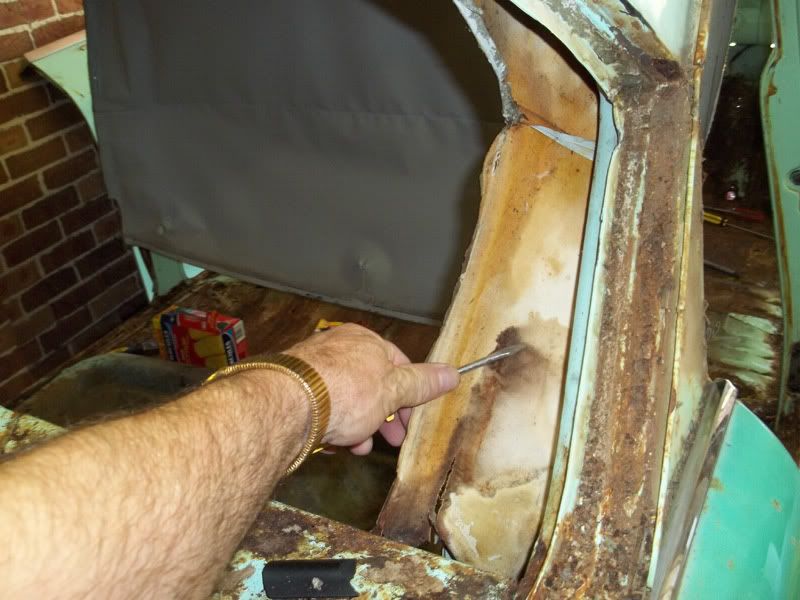

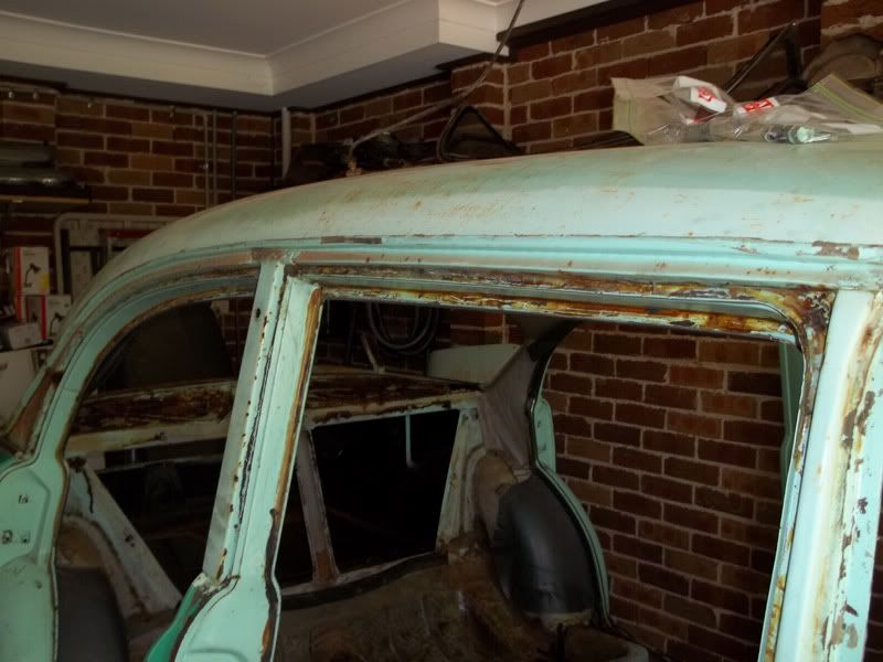

Rust were the body joins the roof, same on both sides.
Only rust on the roof section is here.
Another pic.
Other side clean as a whistle

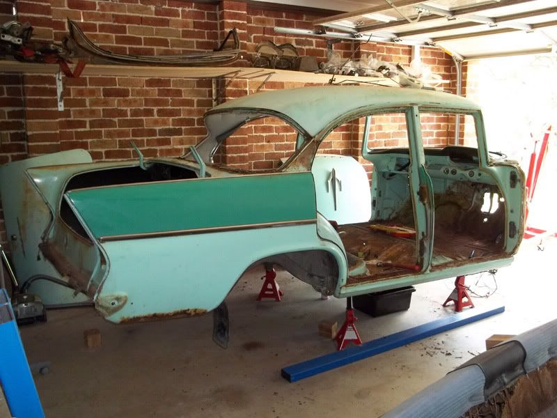

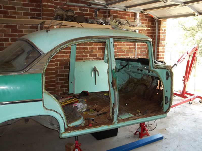

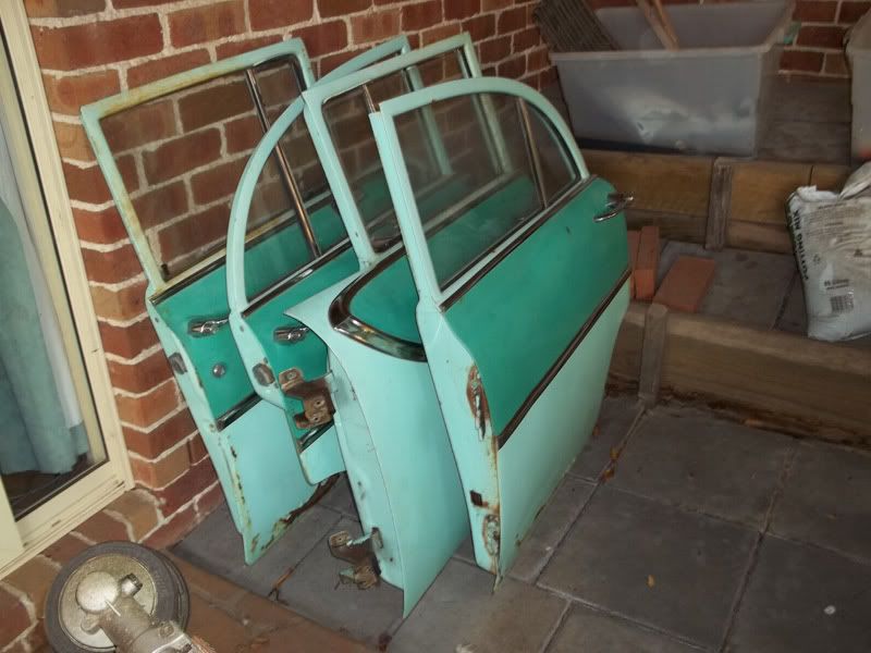

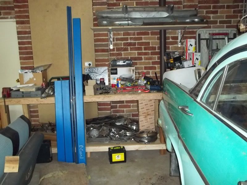

Doors put away, place is starting to look like a wreckers.

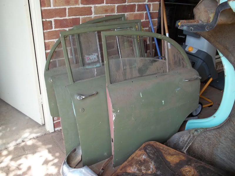

Replacement doors "rust free" of a FB Standard
Looking cleaner now.

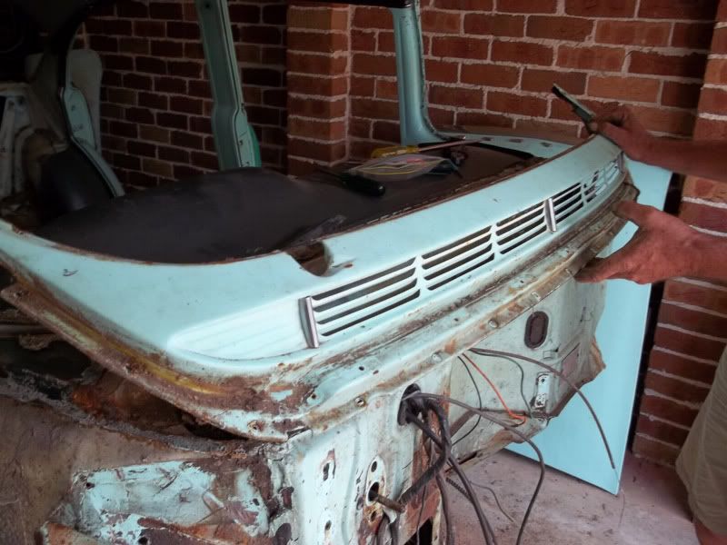

removing the screws to remove the air cover
easier to remove than we thought
Removed and hints of overspray show the damage that was repaired.

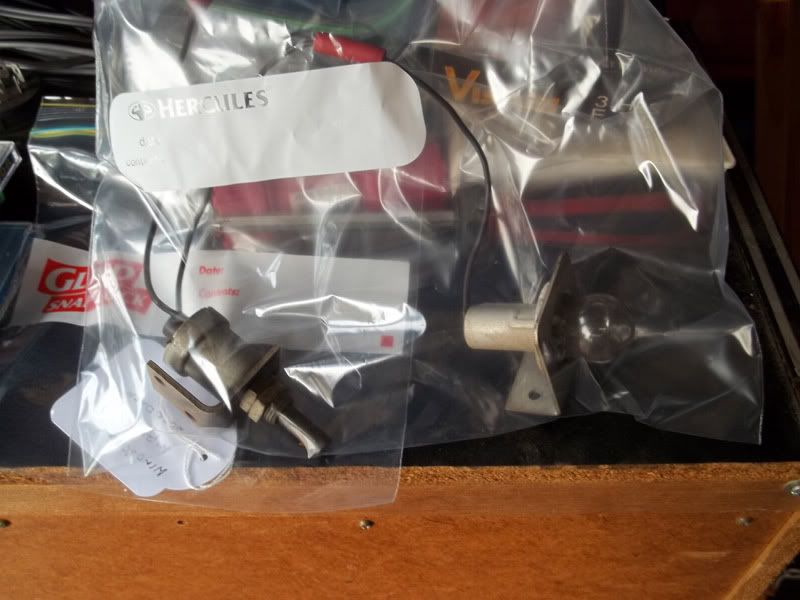

What's that Graham, a boot light, cool.
Boot light, we think it's an aftermarket option.

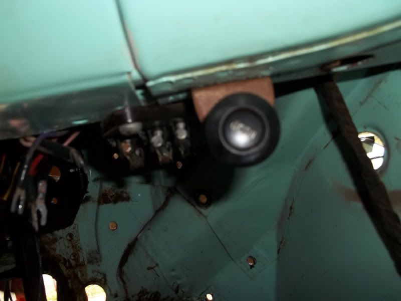

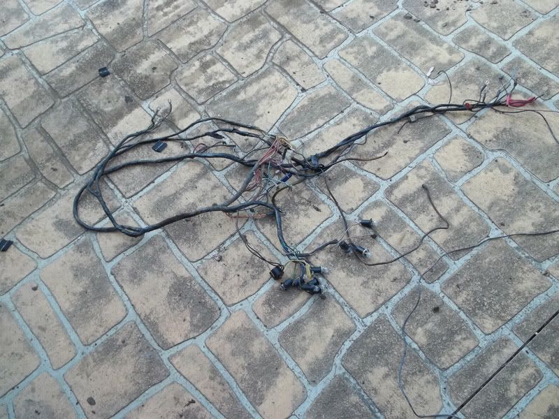

OK Wiring harness coming out.
Front wiring harness removed.

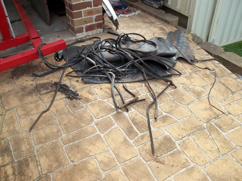

Door rubber that was taken out.

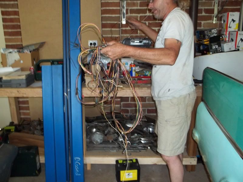

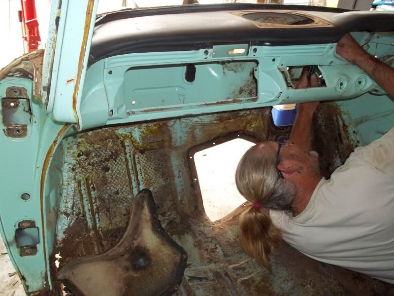

Graham with the rear wiring harness, thank god he's a electrial enginner.

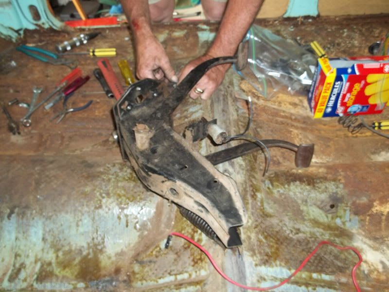

What up?. Oh we missed something?. Ah, the brake a clutch assembly
And there it is!

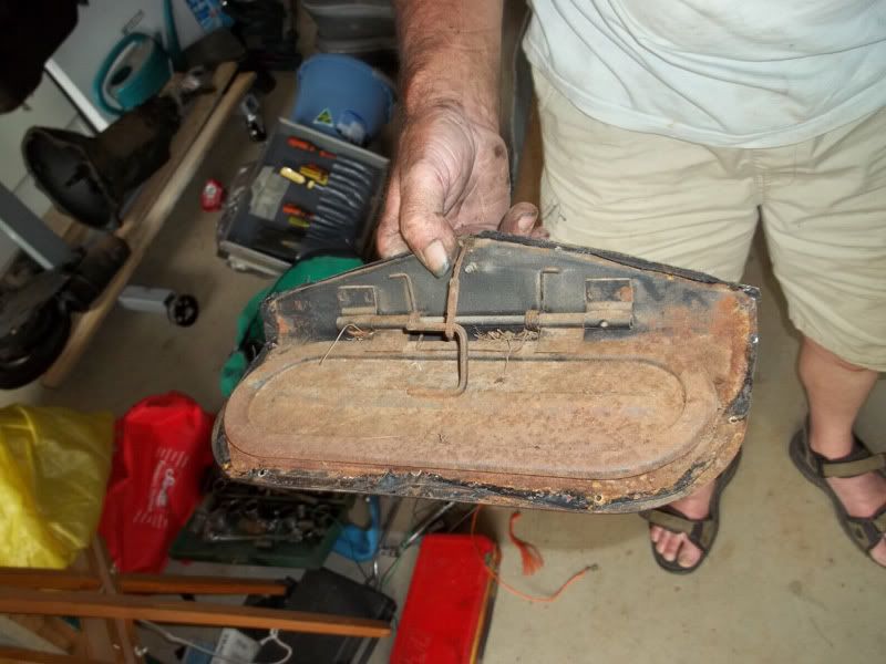

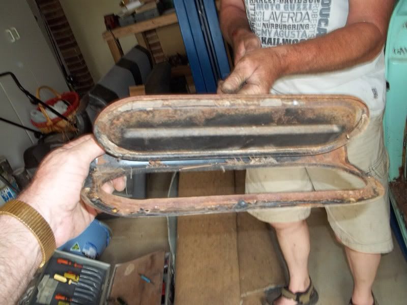

What now?.. Oh the air vent.
and there it is
And it still opens.

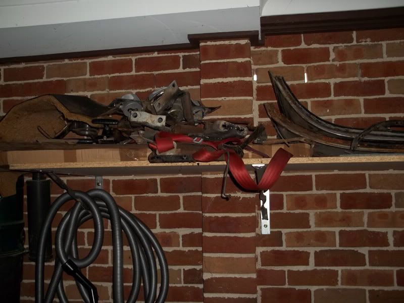

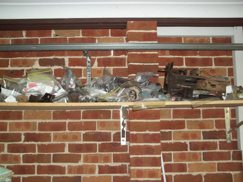

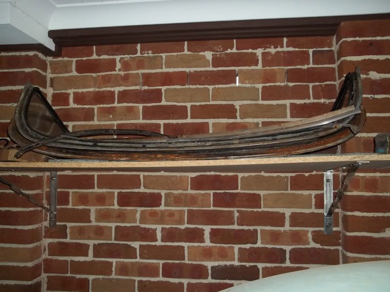

All bagged, tagged and put away.
Glass put up and out of the way.

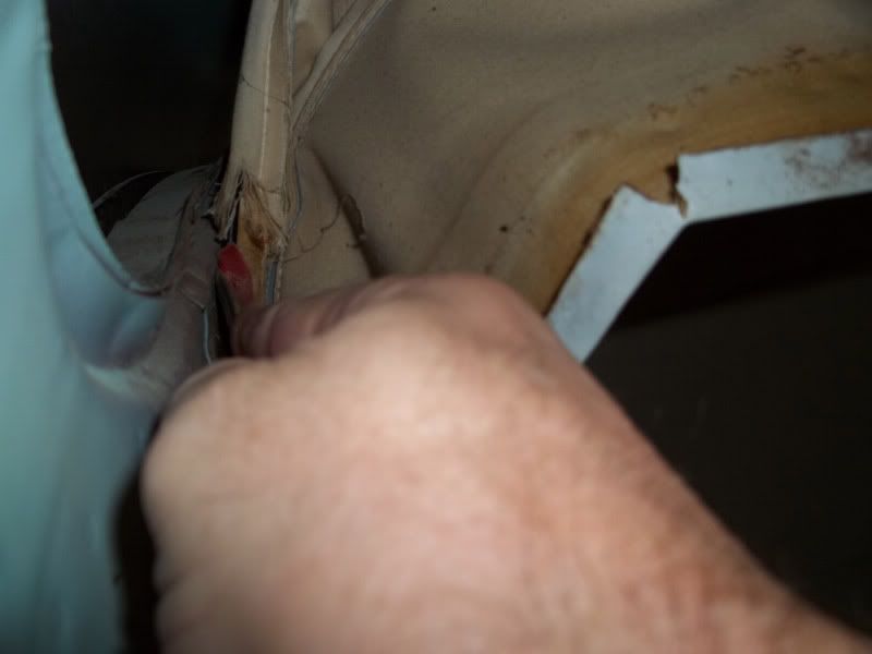

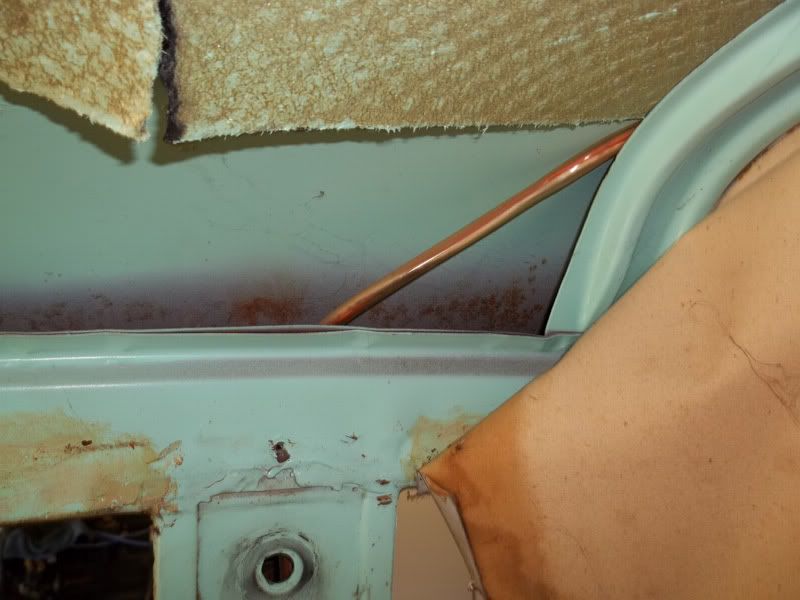

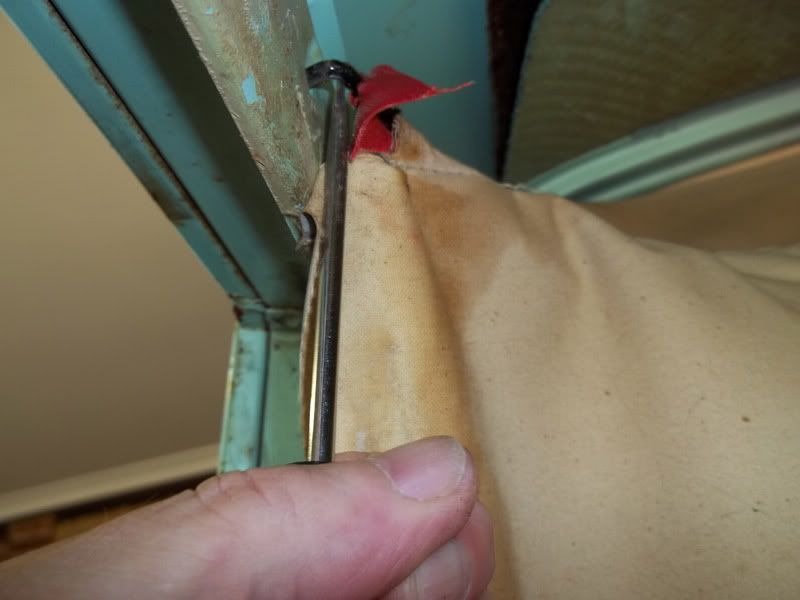

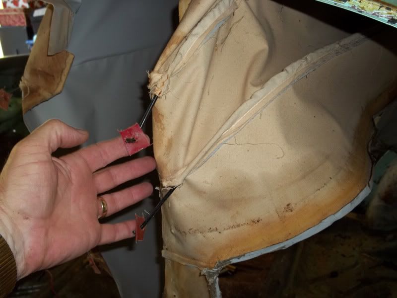

I started removing the front headlining and what do we find
More bloody stuff to scrap off..Stewart what is this crap?.. :?

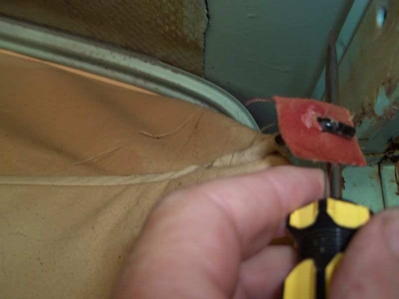

Removing the second clip holding the headlining up

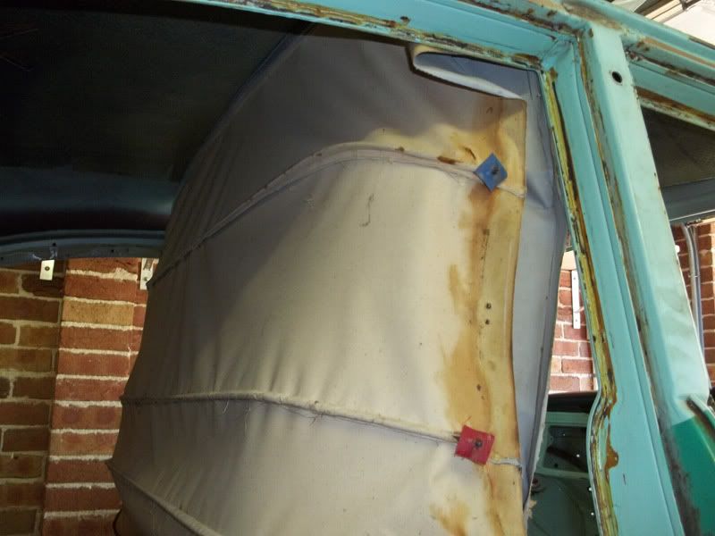

Same of the other side, funny little red tag.

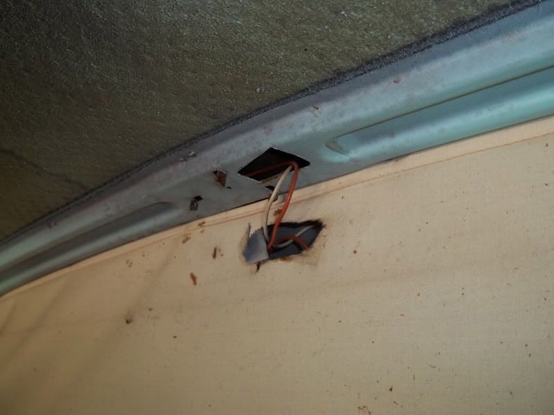

Not forgeting to leave some wire for the dome lamp.
Yep more wire, we are putting some stainless down there before blasting.

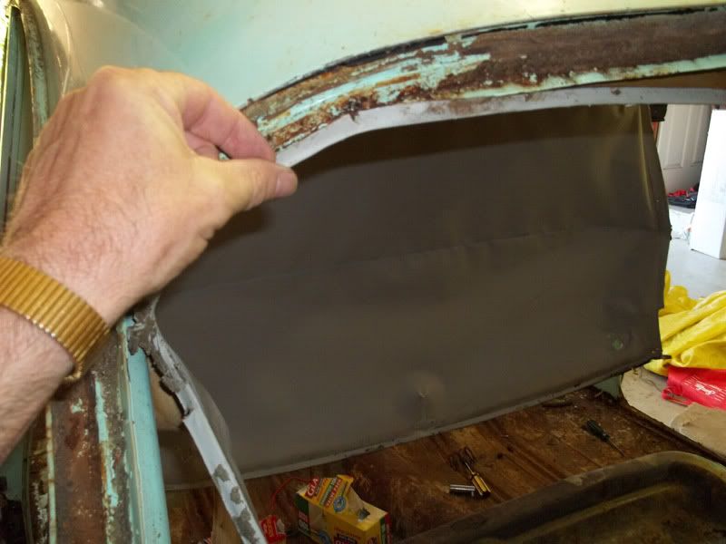

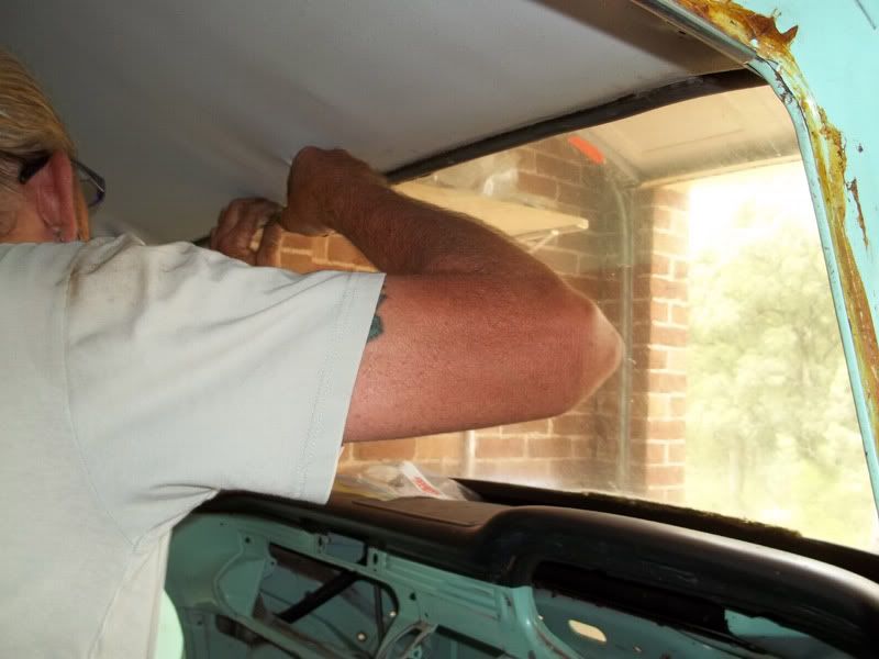

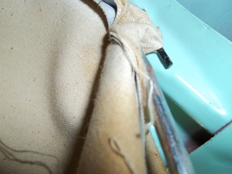

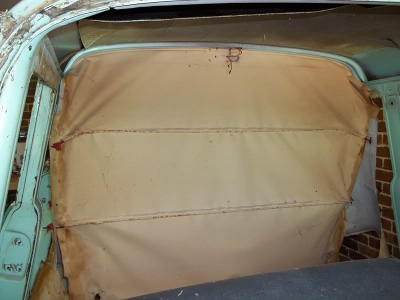

Gentlry removing the back part of the headining, not as good as first thought. Cotton rotten.
Front down starting on the back
Removing another clip
There's two clips at the back very close together.
OK Down both front and back
View from the front.
The first clip to remove on the centre part. not easy.
Another view of that clip
You have to prise back these clip a little to get the wire bracket off.

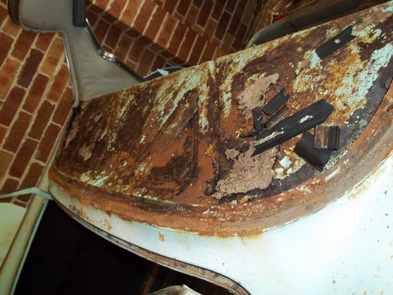

God I hate this stuff. Note is has surface rust were the sound deading was stuck.
But none were it wasen't.

samprinci
Posts: 1111
Re: Wayne with a 1961 FB
Post by samprinci »
nice work Wayne.. Love-in the progress pix.
Do u or any one else know what those little blue & red tags are on the clips ??? :? :?

I strongly recomend you paint strip the car back to metal before you get in blasted. The last couple of cars Ive worked on have had the roofs buckled around the inner roof cross rails. When they blast it pushes on either side of this rail and dents the roof.
Either that or cut the rail out , get it blasted and then reweld iot back in.
At least if the main panels are striped they will not need to put too much pressure to clean the panels. Good luck with the resto.

samprinci wrote:Do u or any one else know what those little blue & red tags are on the clips ??? :? :?
My guess is for determining which ones go where. Whatever you do don't pull them out and if you're replacing the headlining swap them one at a time to ensure they go back in the right spot.
Each of those bars are a particular length and only fit in their respective spots.
samprinci
Posts: 1111
Post by samprinci »
thanks DR... I thought as much. funny / simple the little procedures they had on the production line, to help guide them
So I guess Wayne??? if u want to keep that originality?? I'll leave those tag in then ???
