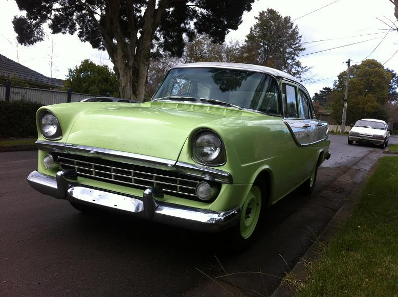

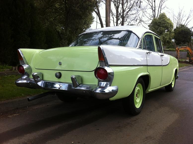

Big day today. For the first time in 6 years, the project is out of the shed. :D, and moving under her own power first time since I started. Drove her up and down the street, very happy with the way she runs. Not bad for a roughly mapped ECU. The fine tuning will come with more driving. Took her out to get some photos for the Insurance company. Just got to get the 28 Day permit from VicRoads, then in for a noise test, weighbridge test then to the Engineer for final inspection. Also a roady in the meantime. Funny to drive this thing up and down the street, remembering how I felt when it was a bare metal shell on the twirler, with huge holes where the floor, hump and inner sills belonged! She might look fairly stock in the pics, but the illusion goes when you start her up. :ebiggrin:
Happy days!
