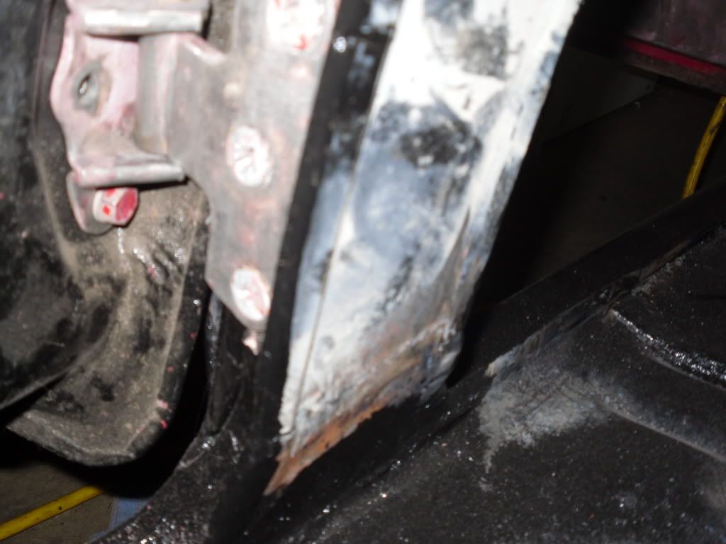

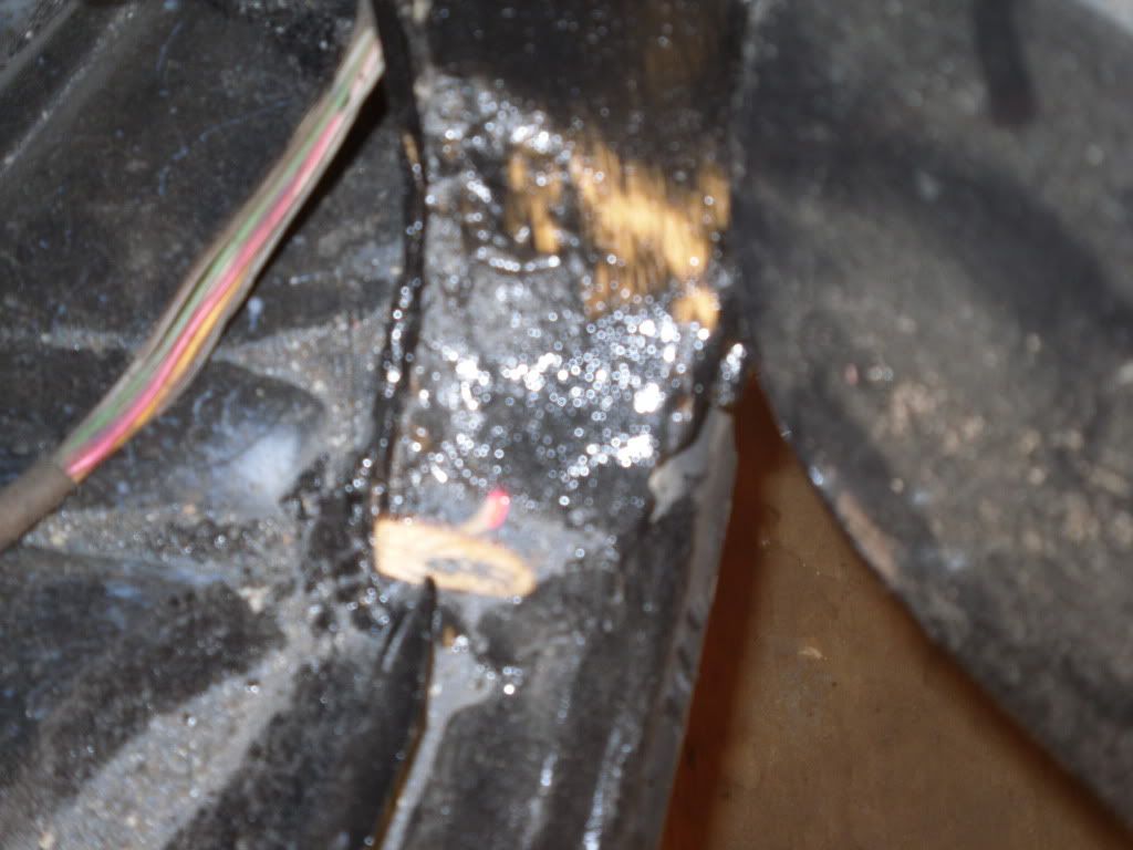

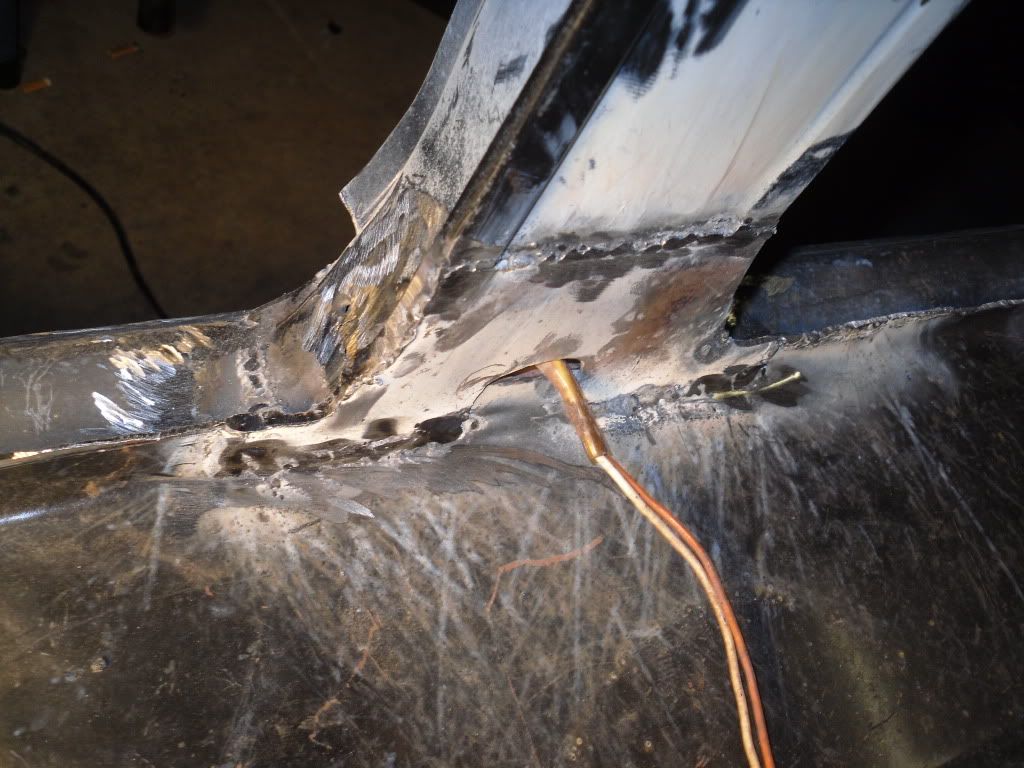

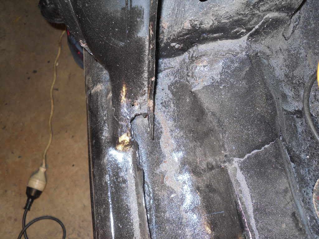

anyway I am finished welding all major pieces, drivers sills, pans under the rear seats, rear subframe ,rear 1/4s filled some holes and welded some patching under the boot rear.

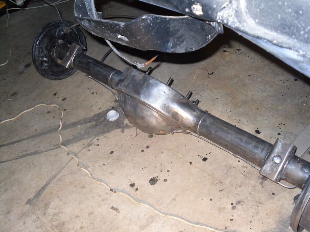

I have also dropped the diff out cleaned up the housing ready for a coat of Red Hot Holden Red VHT engine enamal also painting the tailshaft to match.

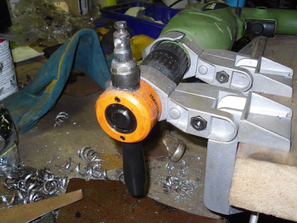

See my favourite new tool the Professional Nibbler I picked this up at the Sydney easter show cost a couple of hundred bucks but has helped me cut out every bit of patching metal with ease.

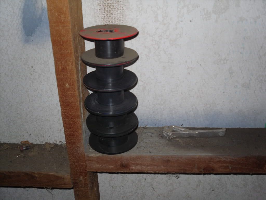

How much welding have I done do you say???
That much welding!! And they arethe ones that I kept.
So Where am I at Now?

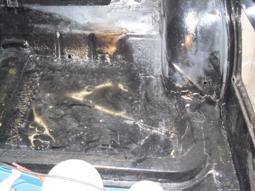

OK I have started sanding back the POR 15 that I painted on to stop surface rust and will be filling all low sections where I have welded, sanding back then high filling. Grinded back all high sections of metal (Duckshit) from welding and ready to start this week.

Diff centre 9inch has gone today to D R Diffs to be rebuilt with a 3.50 to 1 ratio it had 2.75 to 1 ratio but that was more suited to highway cruising I want something that can be dragged at nostalgia drags and still achive mild economy on the highway. This is a screamer not a cruiser.

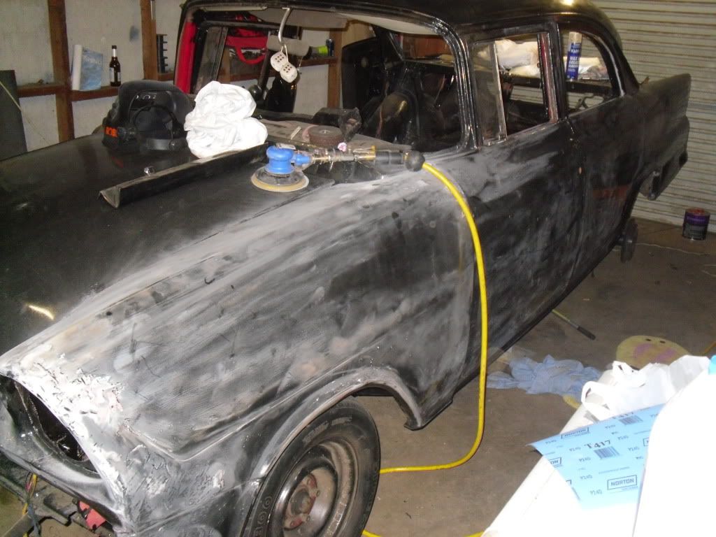

Photo as of 530pm tonight

I used about 3 rolls of wire before I moved on to a big roll and never ran out again :wink: .

baker12 wrote:See my favourite new tool the Professional Nibbler I picked this up at the Sydney easter show cost a couple of hundred bucks but has helped me cut out every bit of patching metal with ease.
I have one of those nibblers, but not the drill clamps you have to hold it to a bench :idea:
It would make it so much easier to use that way :wink:

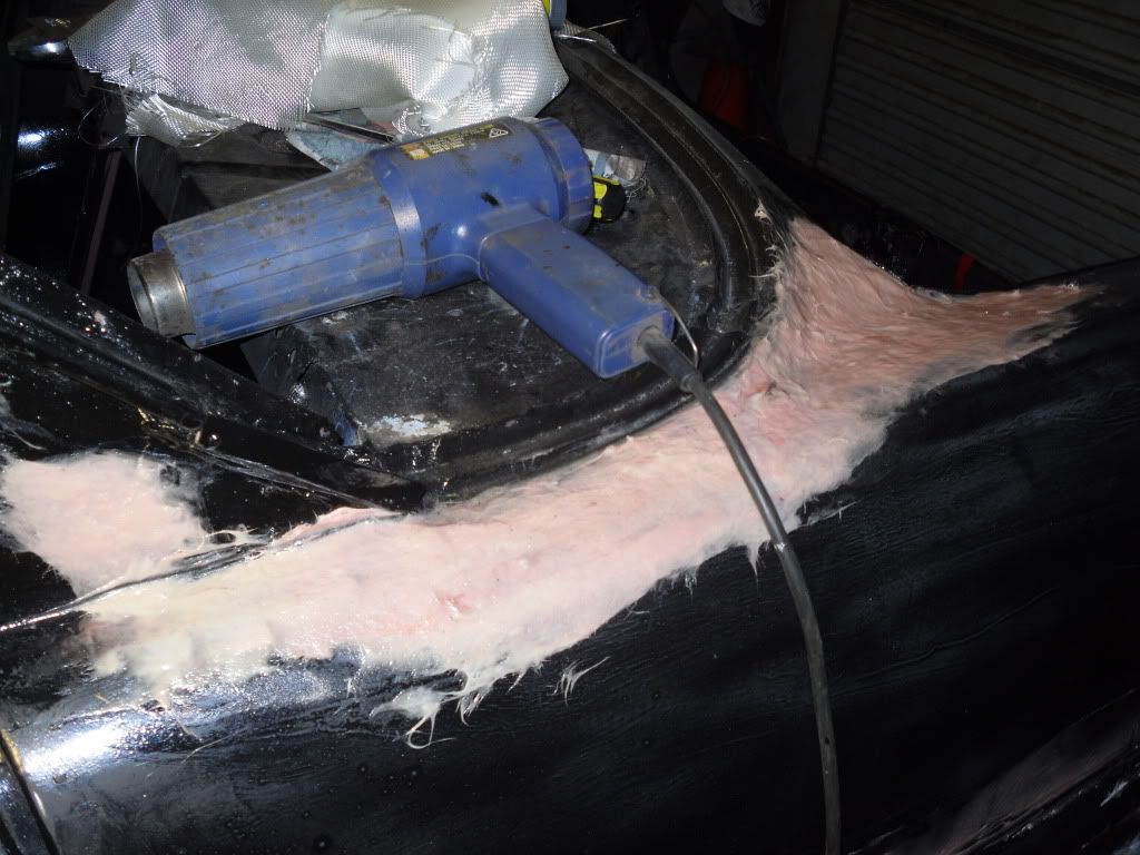

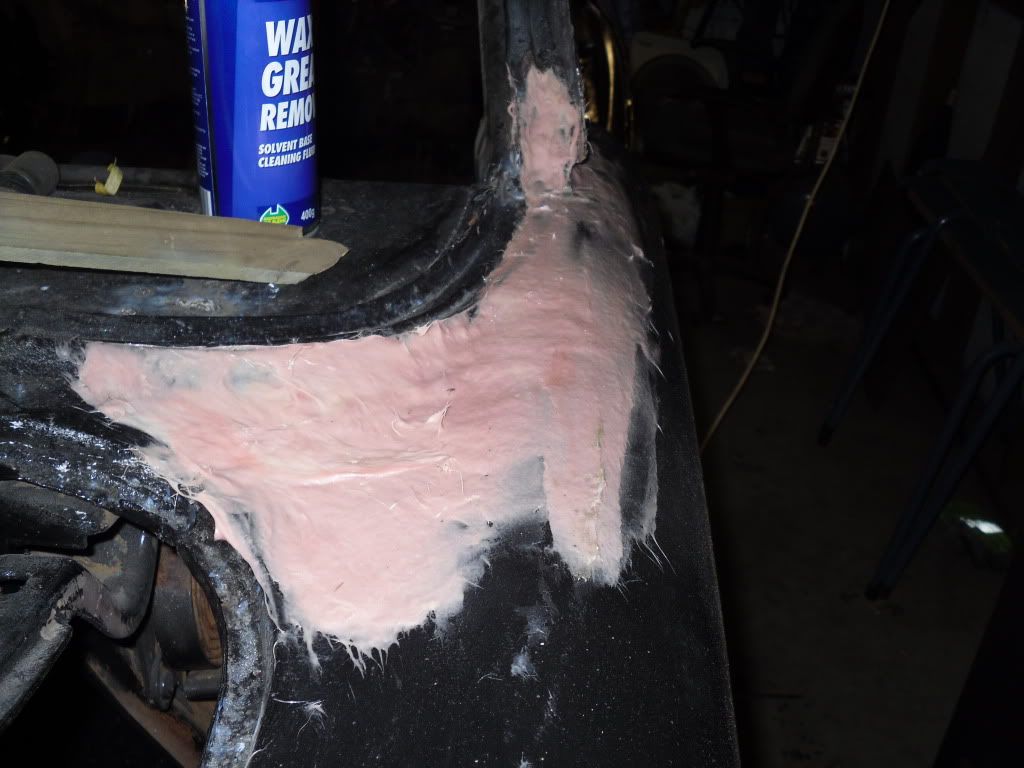

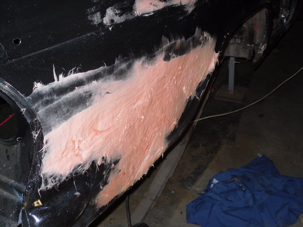

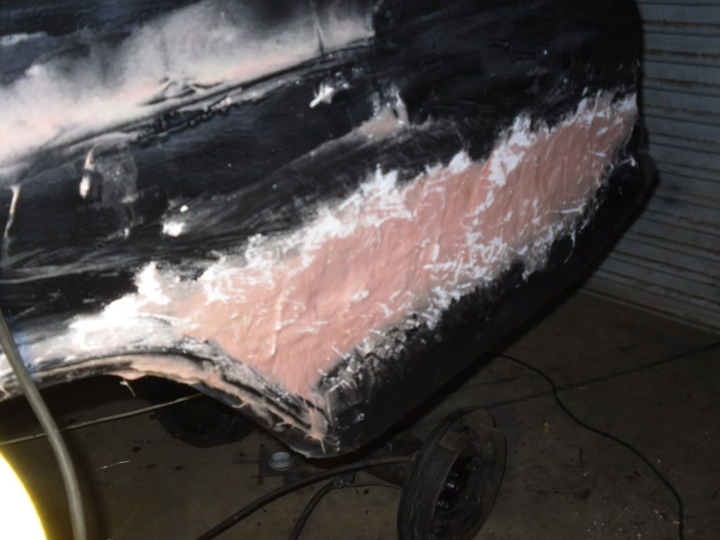

Started filling rear 1/4s today with fibreglass filler to smooth out low spots before I put on high fill, looks like shit now but with some filing and sanding will smooth it all out nicely.
I have deliberatley put more than I need on so that I can achieve a uniform finish and maitin the original lines, except with metal behind the bog this time.
One of my mates said you shouldve used lead! I gave it some some thought until an old panel beater I drink with at the pub said "If lead was that good why dont they use it now" so I chose the fibreglass filler.
If anyone is sydney right now it is friggin freezing and blowing a gale so my shed tonight is off limits have a go at my shed companions you can only see its arse end but the old possum is f#$fin freezin
RAMBO is keeping guard.
So tommorrow night give the filler a good sand and file and top up with fine filler.
These are the only areas I need to fill so next step will be the high fill after a good rough sand then POR15 again then primer and paint.

Posts: 4271
Re: MI60FB
nothing wrong with bog used propperly, the thing with lead is cost, it's health risks and the time and skill involved in useing it,there's plenty of mega dollar cars coated from front to back in bog before the paint's laid on
