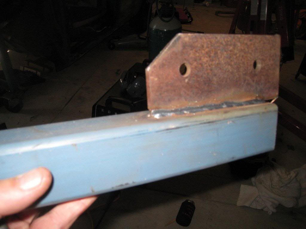

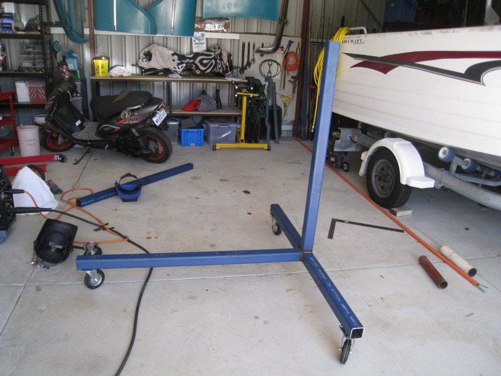

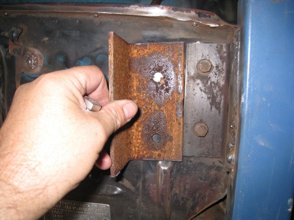

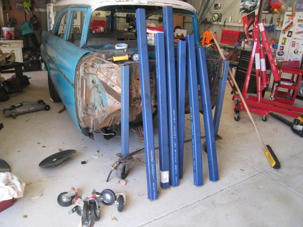

G Day All
Happy New Year, trust the festive season served everyone well.

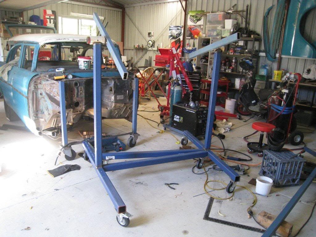

Finally got some shed time today and managed to build the rotisserie.
Only took a few hrs thanks to Midalia cutting up all the tube to length.
Its built for an EK /FB or similar and the brackets bolt onto the firewall & rear bumper supports.
Hell of a lot cheaper than buying one.
Hope to get the wagon on there over the weekend.
Will come in handy as I just bought a ute and a sedan.
Gazza
Gazza

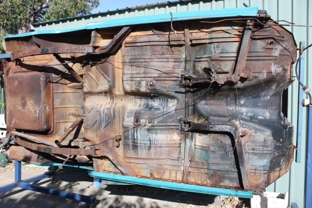

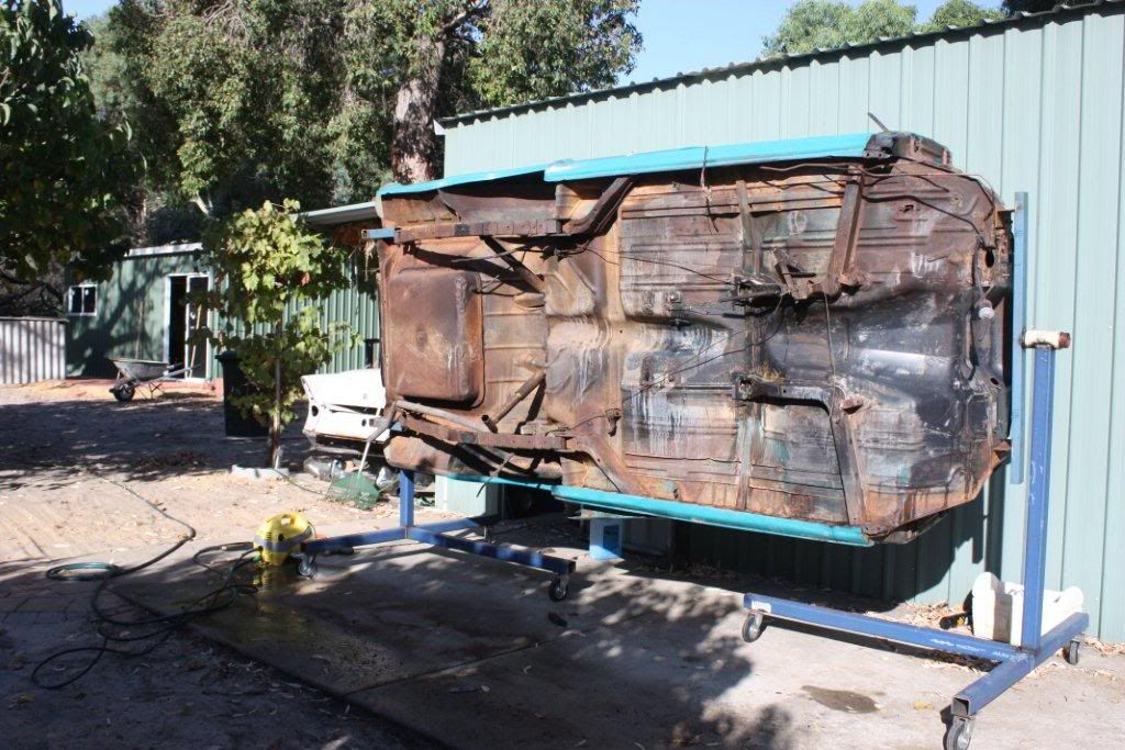

The heat finally let up a bit today so a day in the shed
Got the wagon rotisserie modified (bit top heavy) now works a treat. The looks like a good base
Water blasted 50 years of dirt and grime off, great job for a hot day. Tested the sand blaster it works a treat.
Will blast and paint the under carriage and fit the chassis kit over the next few days. Not sure weather to use POR or KBS leaning towards KBS as its local.
Will post more pics once done.
Gazza
Gazza
