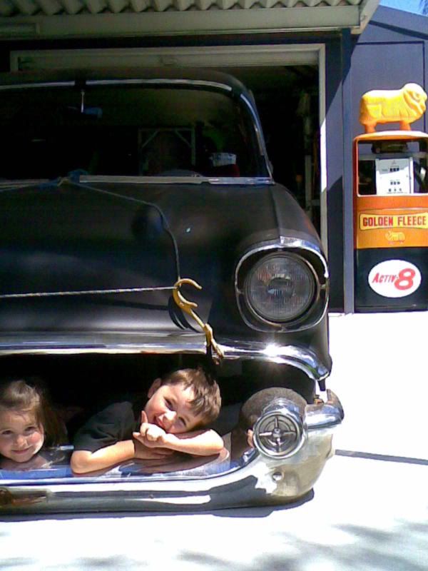

well aher ahum I don know exactly but Ive got the paint from these bowsers ready to go .
In this pic they arent clear coated but when cleared look the same colour as that plymouth .
