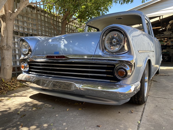

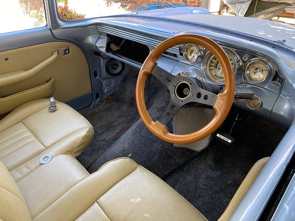

I decide to have a cleanup in the shed as I have stuff everywhere, so I push the ute outside.
First issue is the front is too low as I had little steering before the tyres rub but love the stance. I have a blue outdoors carpet for the tub. Finally got the power windows wired and the door cards installed. Also made a air cleaner as that is the right size. AS you can see there is no centre arm rest in the Mazda BT50 seat. The upholstery guys said I did not ask him to did so he covered it over. Not happy
Ammo is happy with it so far.

Looking fantastic

Re: Ammo's Ute
wiper motor is up near the glove box. Fitted a Commodore, using only the low speed with the switch in the ashtray.
For those who wish to do the inner hinges on the tailgate, I used the upper hinges from a wagon, cutted and modified.
I did have BMW push out cup holder above the ashtray but it seems I need more work to get it sorted.
I will need to check the bolts on the added front panel as this was one of the area's I was working on when I cracked my head.

Re: Ammo's Ute
Love the overall look you have there Rog, door cards look great.
