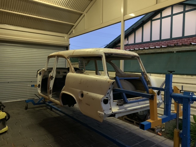

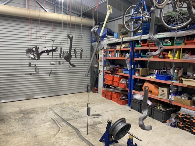

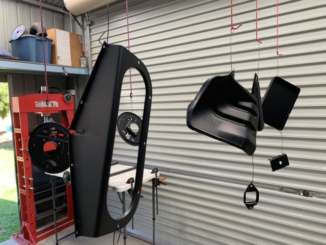

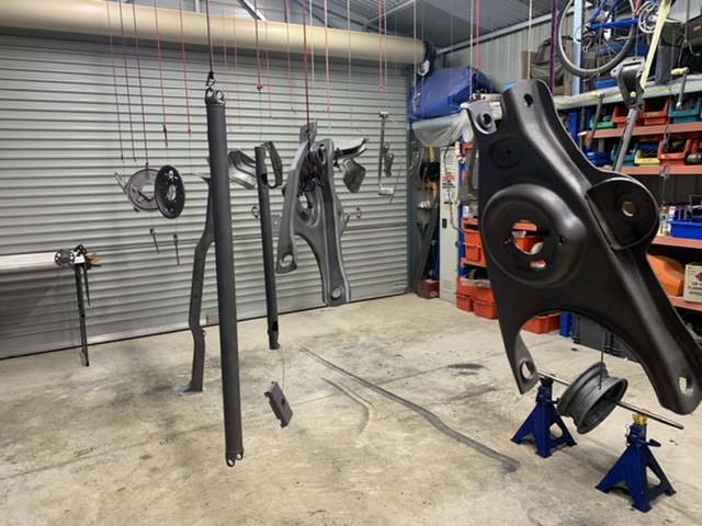

Cleared the wagon on the rotisserie out of the shed today to get some painting done on all bulk of the components.
Everything all clean and hung ready for some paint tomorrow
Drew

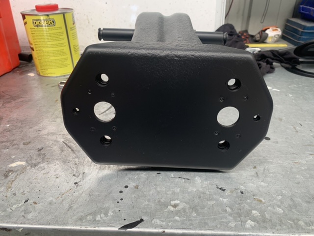

Post by FbSTDwagon »

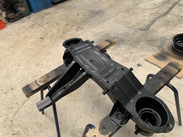

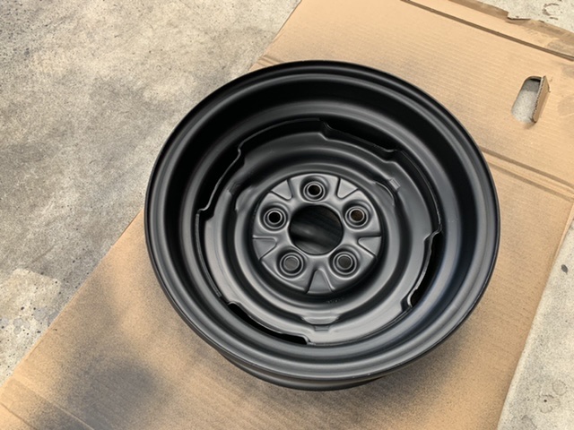

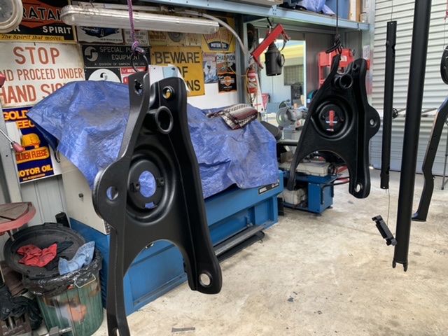

All etched and coated in GMH black.
Beautiful!
Drew

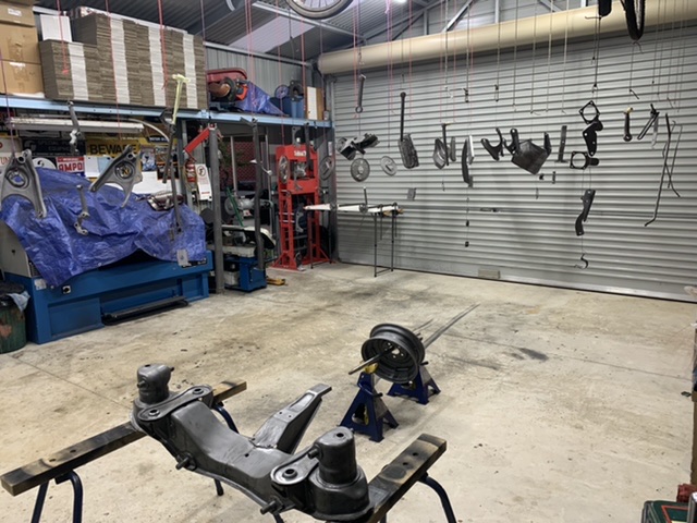

EK DAZ
Posts: 438
Re: FB Standard Wagon
Post by EK DAZ »
Looking good, Your lucky to have so much room.

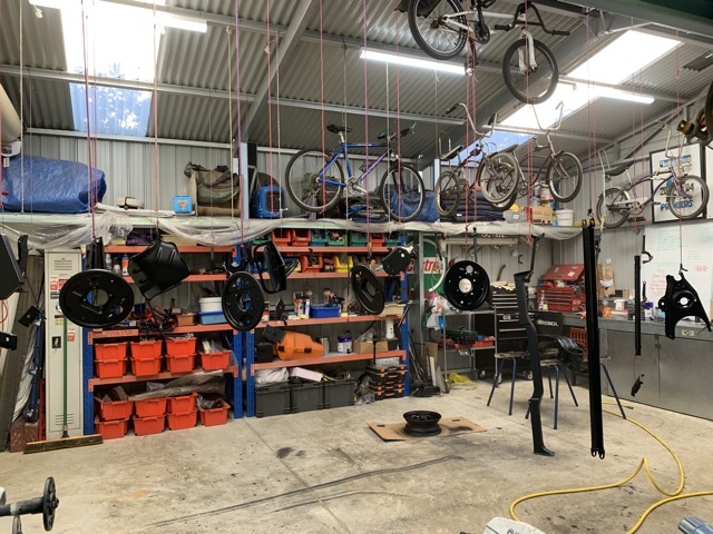

EK DAZ wrote: Mon Nov 29, 2021 3:47 pm Looking good, Your lucky to have so much room.
Funny you say that… I think I need more!
Drew

Brett027 wrote: Mon Nov 29, 2021 5:53 pm It is about at this time Harv has something to say about space.....😁
Deep space???
Drew
Posts: 2468
No. Lack of it. 😄
Posts: 5686
Deep space… the area under the car that dropped bolts roll into. Too deep to reach without a stick.
Lack of Space: the stuff I am jealous of, but grateful for what I have. I’ve done my time on dirt floor sheds and driveways in the mud, so fibro and wriggly tin is not too bad. I’ve got 3’3” room fore/aft, 1’3” either side and 1’10” to the rafters. Plenty.
Posts: 13935
Trust me - the more space you have the more stuff you end up with , and then you have bugger all space .........

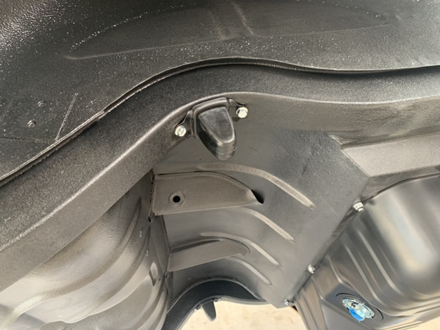

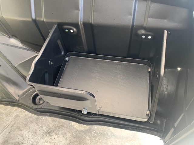

It’s so good to be on the assembly stage, such a buzz to be bolting some small parts back up.
All the planning and work is finally showing some results.
Little wins like diff bump stops, battery tray and the PITA hand brake cable pivot
Drew

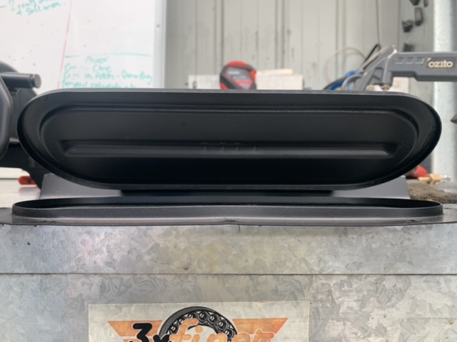

Next is the assembly of all the under dash components.
Does the brake pedal assembly need to have sealant on the face which bolts to the firewall?
And am I best off assembling the pedals on the bench due to the big spring that need to be fitted?
Also what have you guys used to make a new deal for the vent flap?
Drew
Posts: 5686
I haven't used sealant. Definitely bench-assemble. Use some sticky-back foam strip to seal the vent door.
