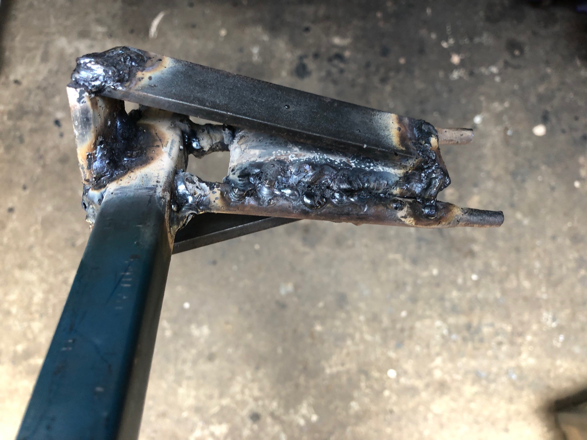

Dug out the pin wrench I made last time, and tripped over the welder (still sitting on the floor from my traction bar misadventures). Figured I'd brace the pin wrench up, and maybe make it rigid enough to prevent having to use the cold chisel.
I've committed every form of welding sacrilege known to man, and then some. Undercut, lack of fusion, blown through holes, gas porosity, slag inclusion... if the boily brother in law sees this thing, he will have kittens. It did pass the "cant break it in the vice" test though :mrgreen:
If youre gunna be dumb, you gotta be tough school of welding.jpg (499.26 KiB) Viewed 1196 times

I have a joke business on Bookface called FAB Fabrications - I put up pics of whatever bodgy/ugly/dangerous shit I find on the web on there - this pic I believe has made the cut and will soon be making an appearance :ebiggrin: :ebiggrin: :ebiggrin:
I dips me lid to you sir :lol: :lol: :D
Re: harvs ek 327 wagon
Posted: Tue Dec 21, 2021 1:57 pm
If it removes the filter, I'm gunna chrome plate it and write Sidchrome on the handle :lol:

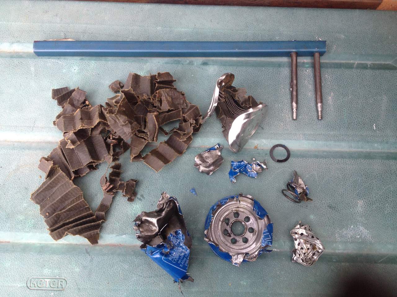

That's what I tried last time, back on page 9. The punched-through screwdriver had enough torque on it that it tore the bottom out of the canister, with the o-ring still holding on. I had to break out the rest of the canister in little chunks, then tried the pin wrench up the drainback holes. Bent the pin wrench. Ended up with a cold chisel, tapping the oil drainback hole edges to get it to spin. Check out how much damage the cold chisel did to the drainback hole at the 8 o'clock position in the photo below.
Learnt three new swear words that job.
