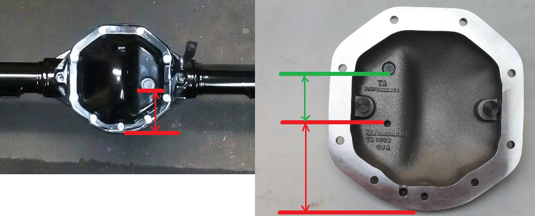

The young bloke had blown an axle at the drags back in Q1, and I had beefed up the diff to 31 splines and a Harrop centre. It needed to have 500km gentle (slower than 80km/h) run-in miles. Took me since June to clock that up pooting around western Sydney (hard to clock up miles when you are locked in no further than 5km from home, and for essential trips only). Got the 500km up at the start of the journey, and could finally hear Captain Kirk (Mr Scott, Warp Factor 9... or at least 110km/h) on the freeway. Managed to blow a bit of diff oil out the breather, though suspect I had it over-full. The GMH diff cover plates are normally used as the level indicator - top the diff up until it overflows. The diff got a TA Performance ally cover and girdle in the recent rebuild, and I suspect the fill hole is a lot higher than factory. Stupid me then topped it up to the higher level. No drama pooting around, but at 110km/h enough speed to throw the excess out. If anyone has a standard BW75 or 78 diff cover to hand (VL and later Commodores with live axles) I'd love a measurement on the fill hole height (from the bottom of the diff) please.

Some more thinking on my diff overfilling. The image to the left is the standard BW78 cover. You fill that till it overflows (red line). The image on the right is the TA Performance cover, which I filled until it overflowed (green line).
Me, being dumb-dumb-not-so-smart ignored the little overflow allen-head plug at the correct level (green circle). I was worried it was part of the stud girdle adjustment (red circle) so didn't touch it. Should have looked harder at the internals before sending it to the diff shop for the overhaul. I followed the TA Performance instructions and filled to overflowing... just not at the right location.
Ta performance cover.png (964.3 KiB) Viewed 2494 times
Waaaay overfull. Looks like I need to pull the little allan plug and drain her down.

Posted: Mon Nov 22, 2021 12:30 pm
just a tad overfull :lol: :lol: :lol: , should be able to decant the excess and do your next 2 diff oil changes for free !!
