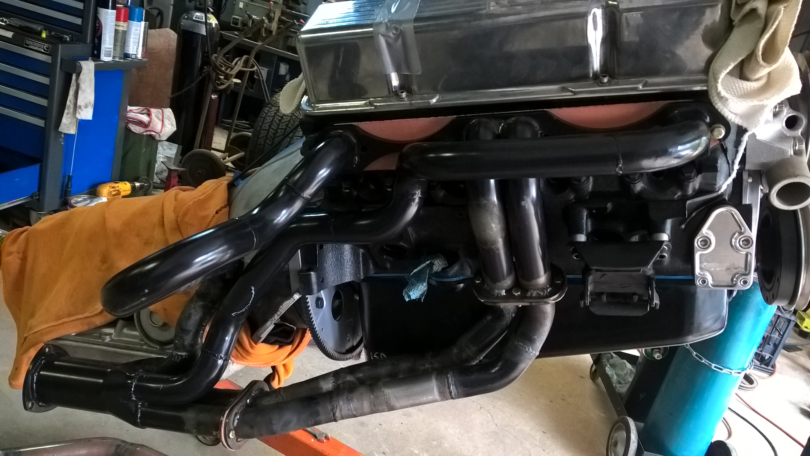

Bloody hell this car is doing my head in !!
I dont think I can say any words beginning with F as I've worn that part of my mouth out.

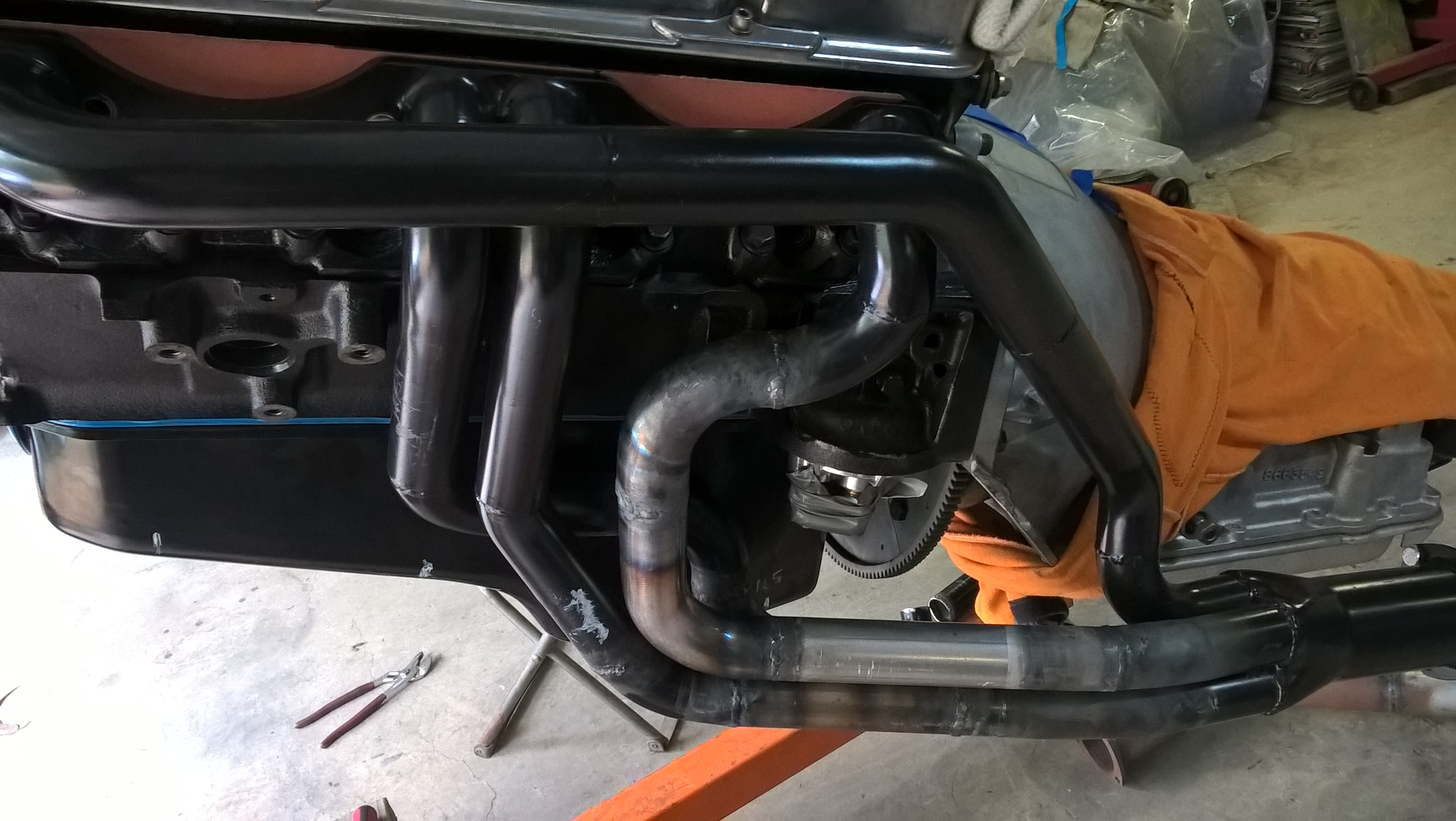

So my original design extractors went below the torana outriggers but when I moved the front end caster the outriggers came
with it 30mm lower as a matter of fact and that means extractors now dont fit F*%#%^&&((*&^^^ !!!!!
Chop chop grind grind weld weld you all know how this goes.

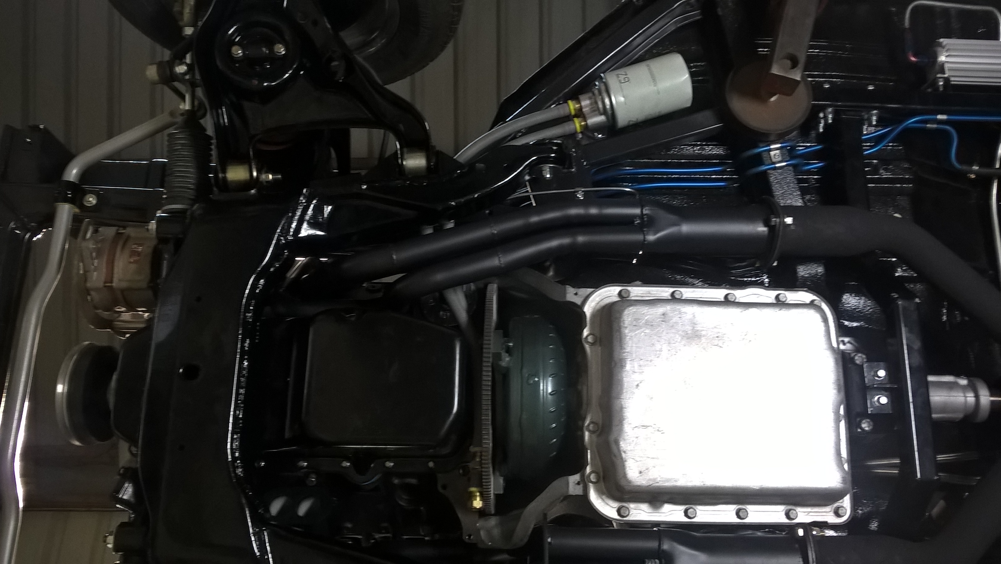

Pipes now go inside the outriggers and the frame so this means no room for the oil filter or starter removal. I ended up making a removeable section on the drivers side and will now use a remote oil filter on the passanger side. In actual fact the exhaust is
now neater and doesnt hang as low. Will I everfinish this bloody thing !!

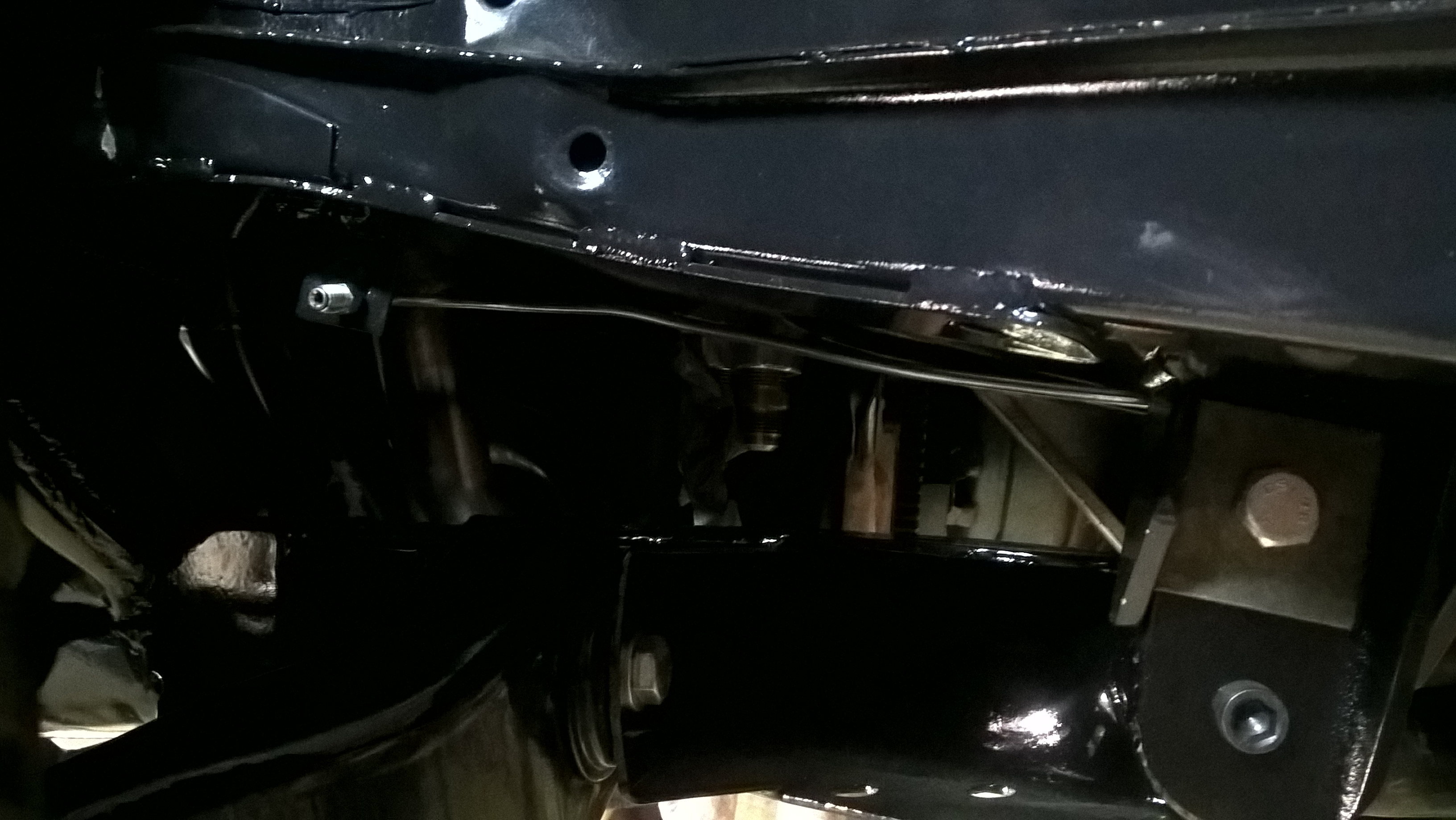

Last shot is the gap where my oil lines will come through, starting to run out of these gaps, ha ha ha
This has taken me over a month with the motor in and out several times but its done now, off to the ceramic coaters again
tomorrow and no looking back now, will pull my finger out this summer with the paint and hopefully some good news progress.

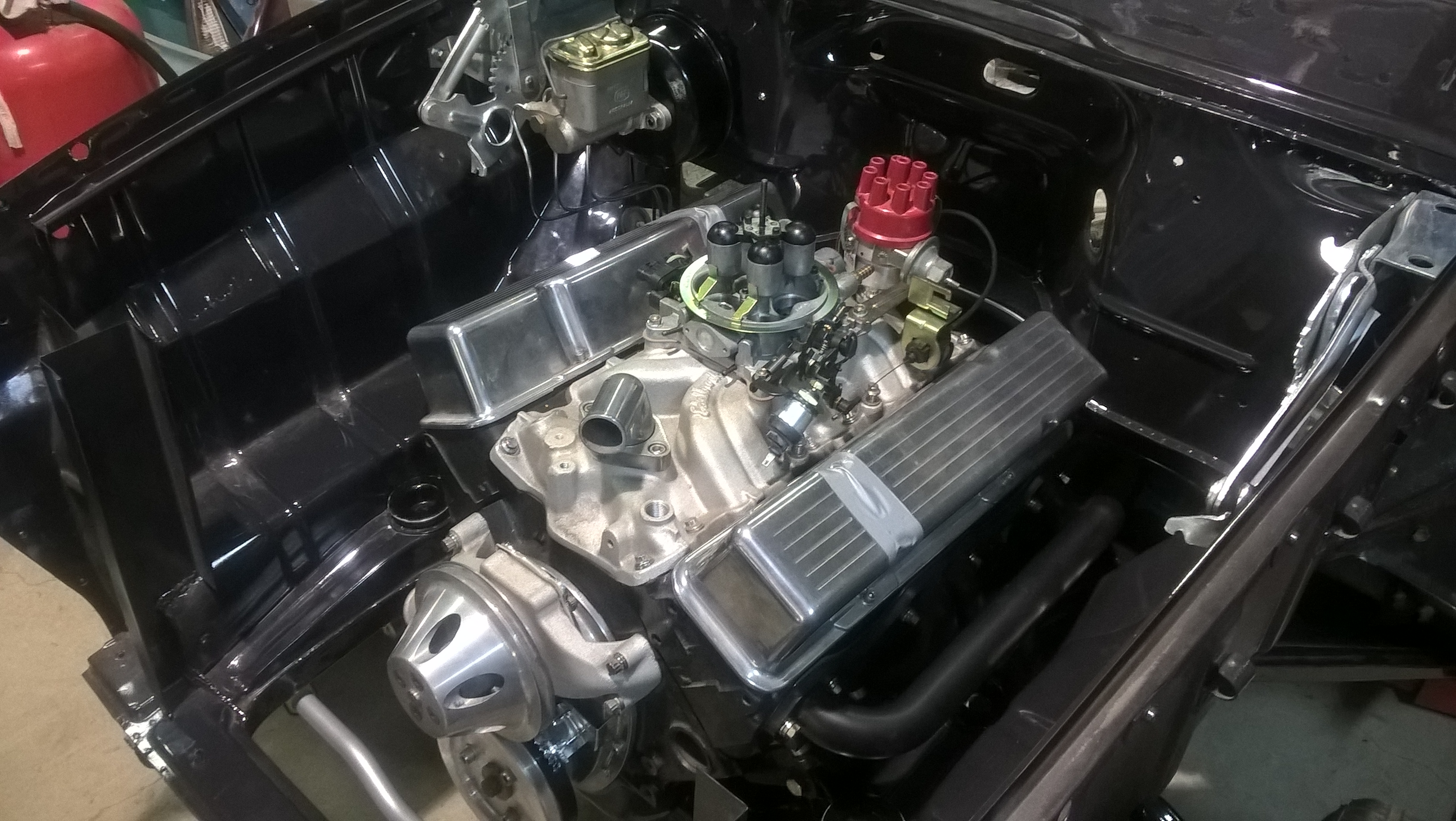

Posted: Tue Nov 27, 2018 6:11 pm
by EK283

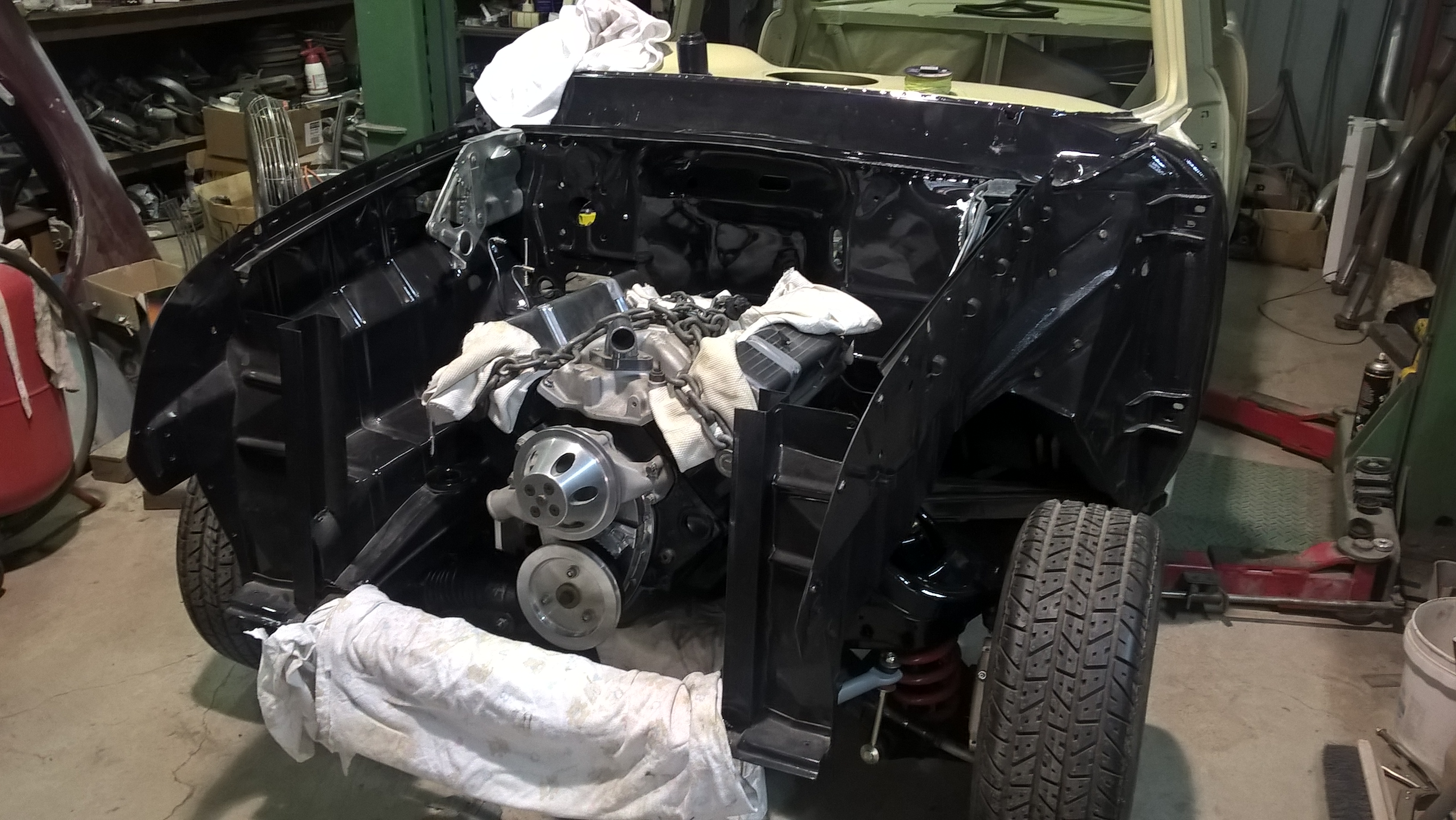

Its in and staying in until I blow it up !!

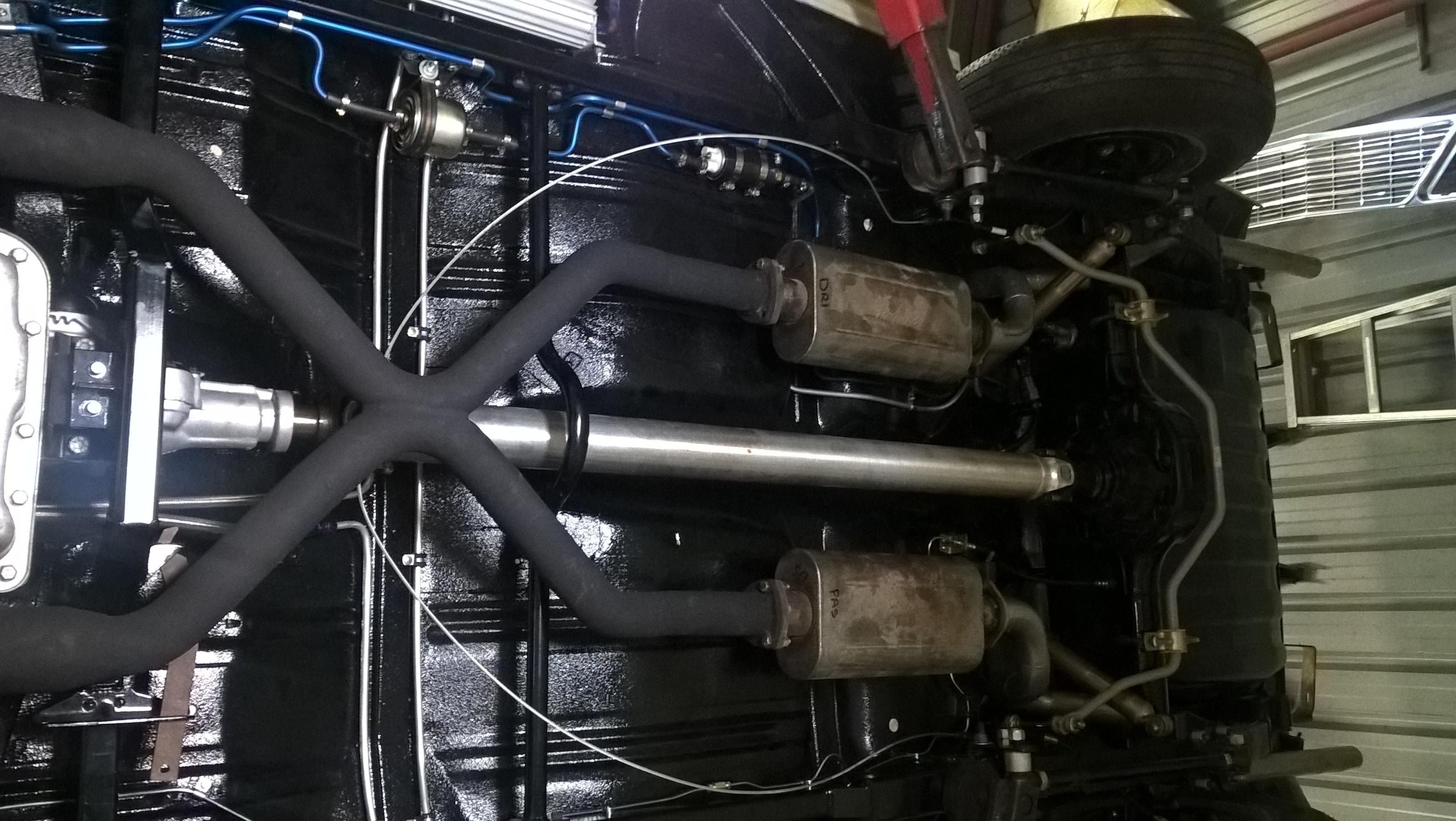

Pushed hard last few weeks so I have nearly finished everything underneath.
Got to paint some fiddly bits like handbrake bracket, alternator bracket etc, hopefully tomorrow.
Will get back to the body this weekend.

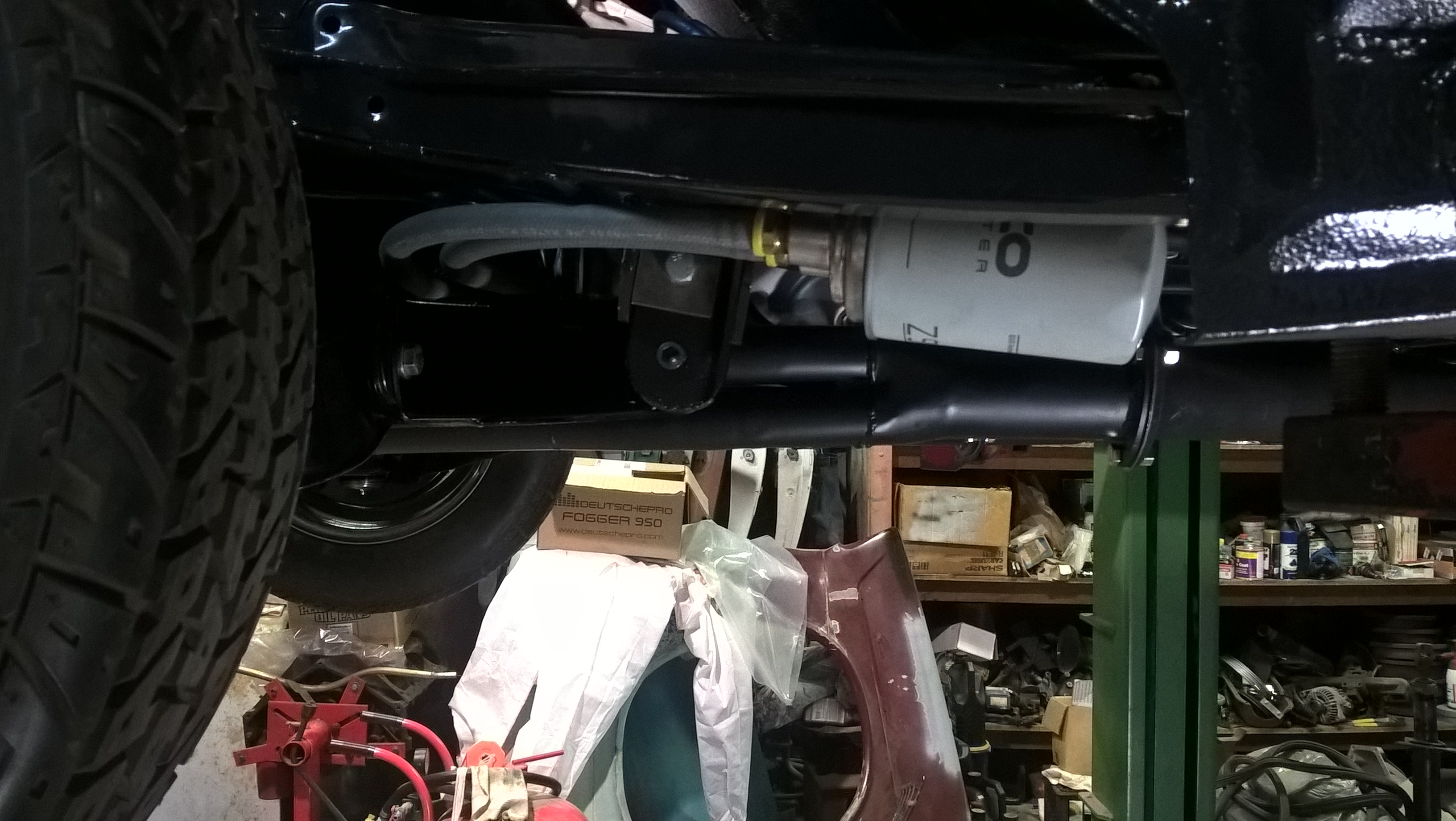

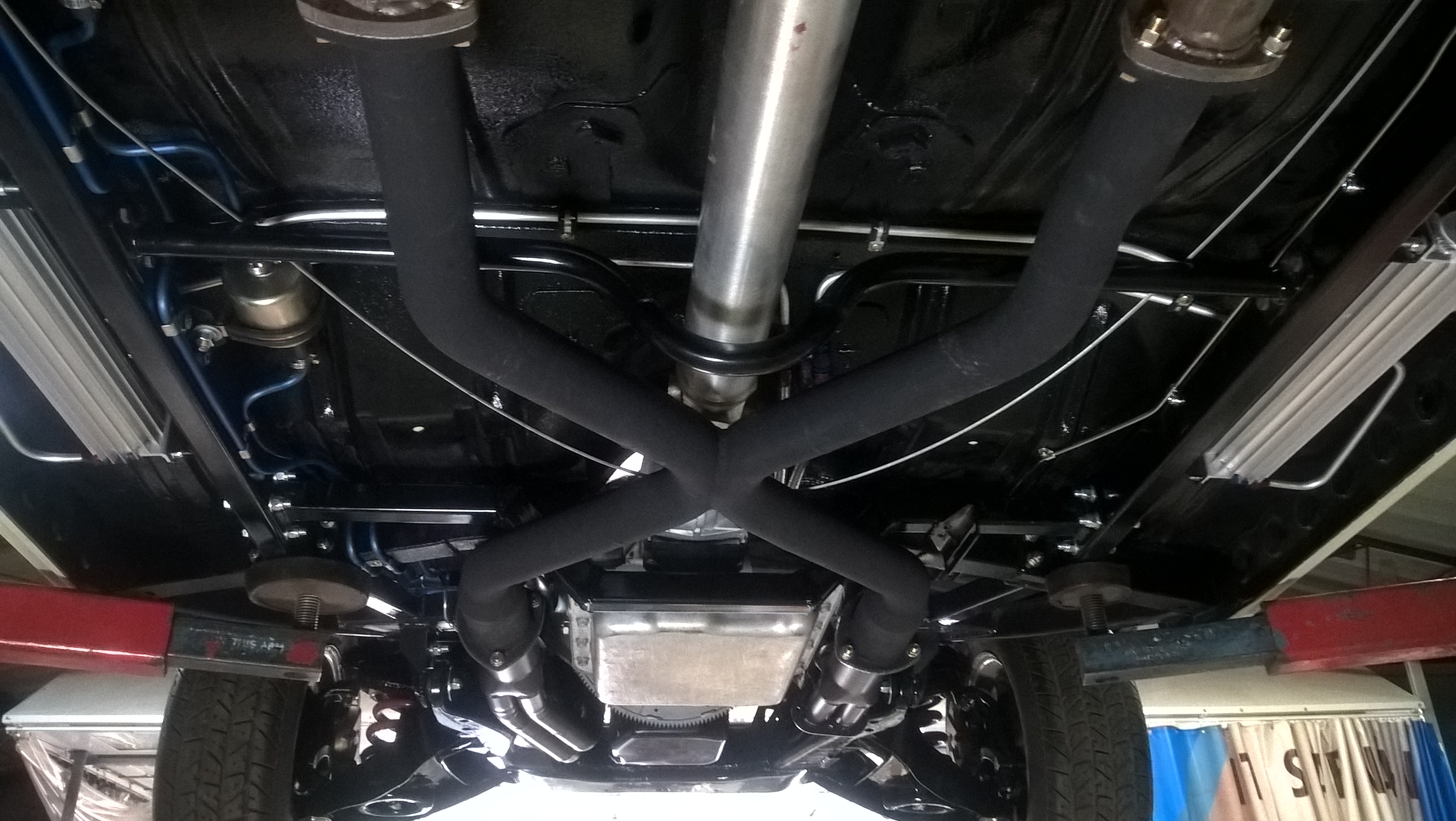

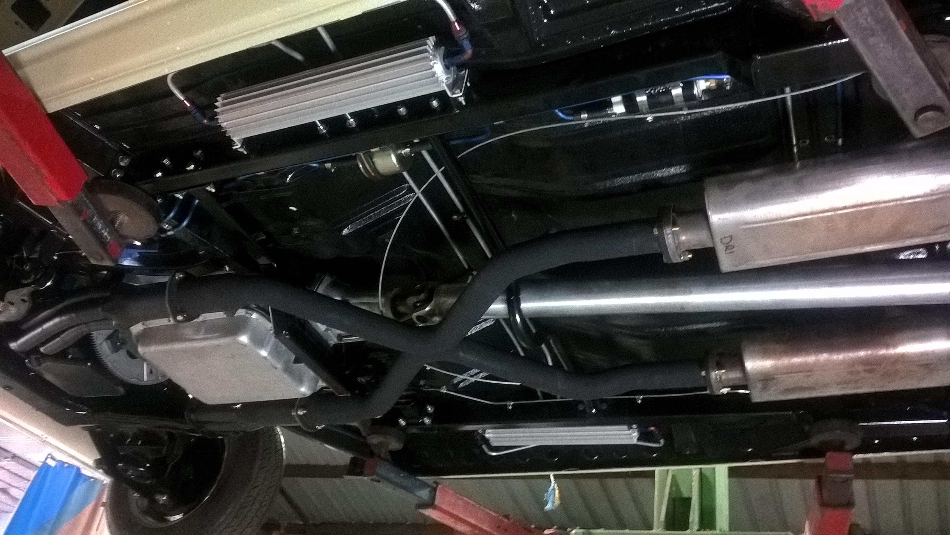

Another few hours in the shed and I have installed my remote oil filter.
Its the only place I can put it cause there just isn't any room, unless I run 100kms of hose.
I will probably have to put a guard to protect it from the road stones etc.
The future oil changes should be a breeze and this something that made me put it in this spot.
With the torana front there is minimal spare space, especially with the exhaust, I just hope this is all worth it ?????
Its been so long even my so called stainless mufflers have surface rust on them, I have used them before to be fair.
