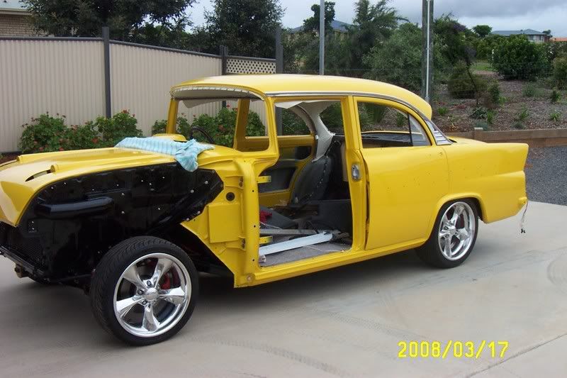

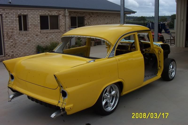

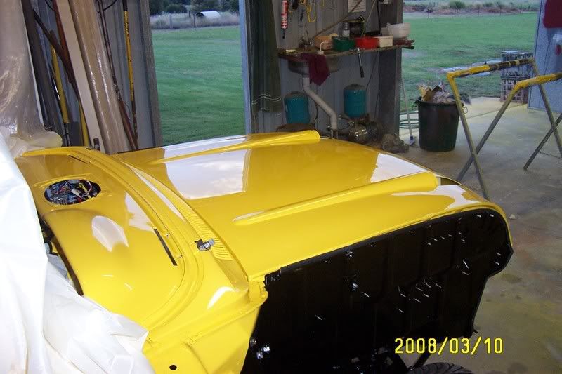

Ok, a few more panels painted. Got the outside of the bonnet & boot painted and also rear doors done.
Only the 2 front doors and front guards to go and all the painting is finished.
Hopefully will have them painted by the end of next weekend.
Then the fun starts of putting it all back together.
I do love the yellow and chrome together.

hey mal,
HOW GOOD DOES IT LOOK, HEY...
yeah... the chrome does look amazing on the yellow...
i dont know how you sleep when your soooooooooo close to finishing it, it'll be sad when it is finished as its been great fun & very educational watching this build...
thanks
matty martin
go the wagons....

the bonnet looks schmick with the chrome bits on it!!
i still reckon you need to swap the front tyres from left to right cause those groves should run the other way ....

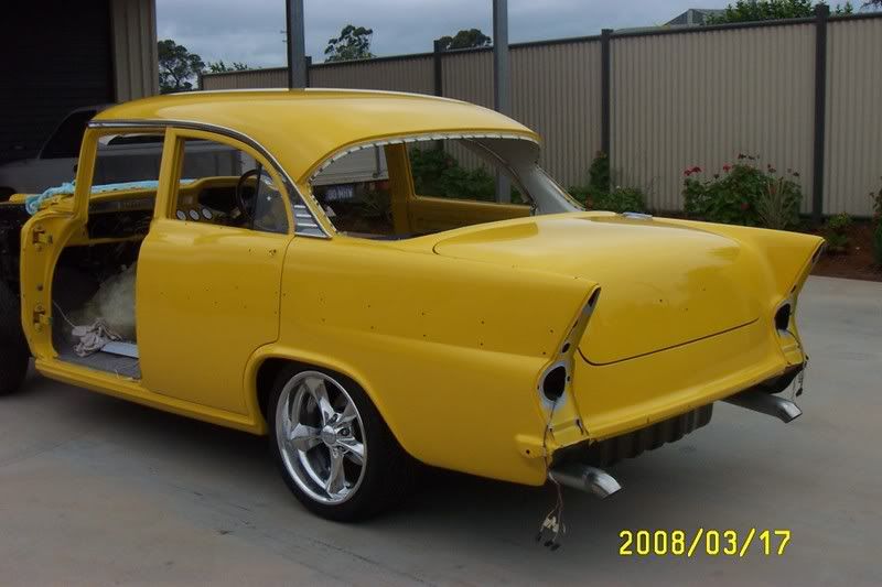

Slowly working my way to the front.
Fitted the boot rubber & lock, all works good. :)
Fitted the rear door rubbers, got them from Rare Parts. I was really dreading putting the doors on,
as the last FB I painted and fitted door rubbers too, you couldn't even close the doors. They were rare spares
rubbers, but that as about 6 years ago also.
The Rare Parts rubbers are brilliant :shock: still can't believe how good the doors shut. Although I did have
to do a bit of cutting and shutting with the rear door rubbers as there not a real good fit that way.
Anyway, rear doors are fitted. Front doors are rubbed down ready to go on the weekend. Now starting on the worst
panels, the front guards. :?
Looking forward to Friday as I start my 2 weeks leave. Hopefully I
should be able to put a real hole in things by the end of that.

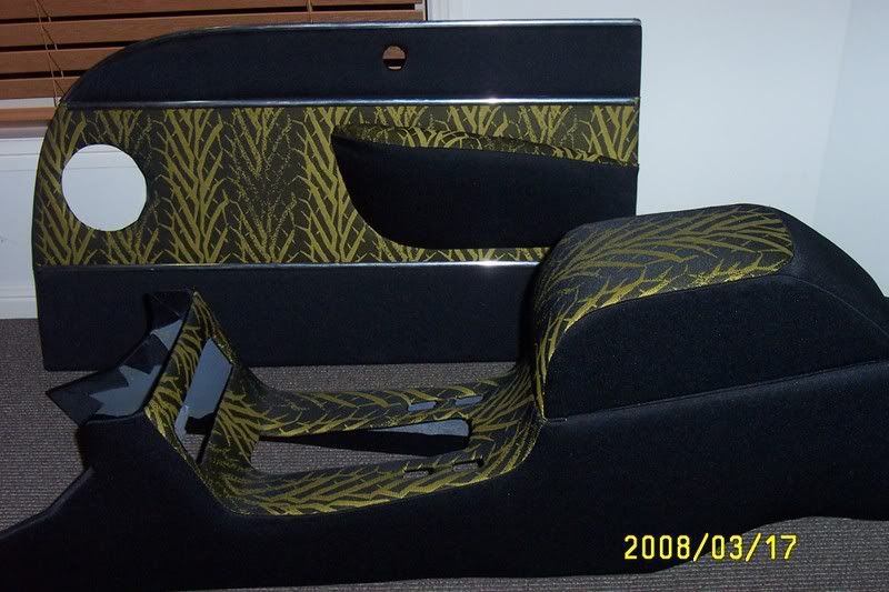

Oh shit, nearly forgot, I've just added a picky of some of the interior
finished and ready for fitting.

love the interior, i've never seen one of those consoles look so good :)

Love your interior scheme - I feel it will just cap off what has been an exceptional project..............
