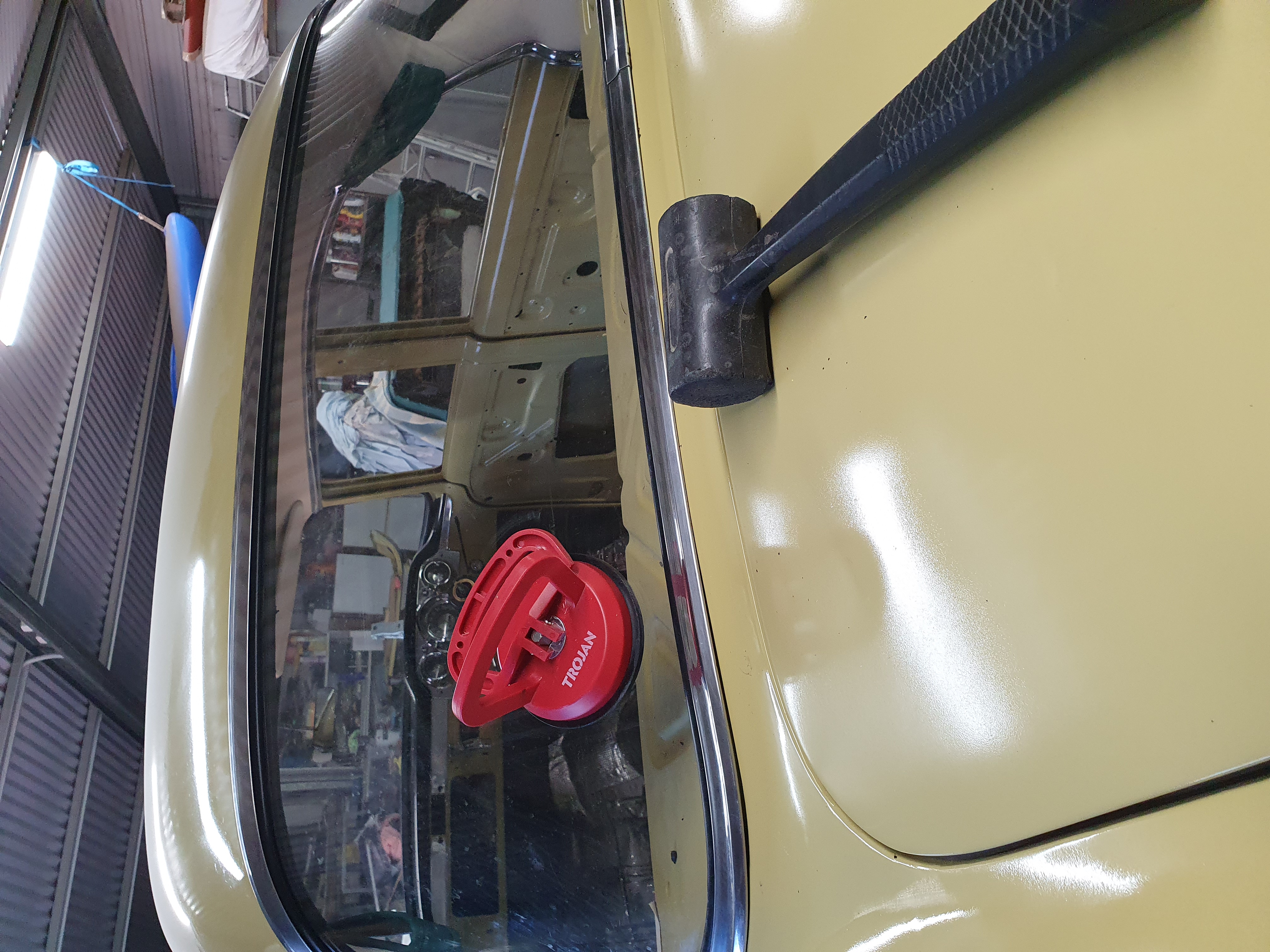

Spent a few days on headlining, windscreens and bits and pieces of interior. Having lots of trouble with rear windscreen, taken it out once to have another go and may well have to take it out again and refit it tomorrow. Top and sides fitting perfectly but bottom is stubbornly 1/4 inch away from sitting properly in the channel.Will have another crack at it tomorrow. Frustrating time all round. Front windscreen is sitting nicely fortunately.

Got it in this morning 😀. Aimed the heat lamps at it to warm it up and went to that big hardware place and bought a suction cup thing for glass while it warmed up. Splashed a lot of soapy water in the rubber and channel and it finally seated after about twenty minutes of juggling. Put upwards pressure on it using the suction cup which is a lot more effective and safer than hands pushing on it, and that and lots of tapping with the rubber mallet persuaded it to finally go all the way in.
