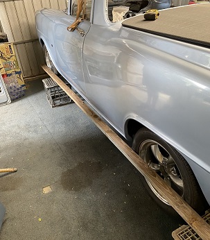

I have been playing with the steering arms, that is reshaping these to clear the tyres and match up to the steering rack.
I'm happy with the results so fitted wheels and did a redneck wheel alignment. :roll: :roll:
redneck wheel alignment (1).JPG (56.63 KiB) Viewed 1110 times

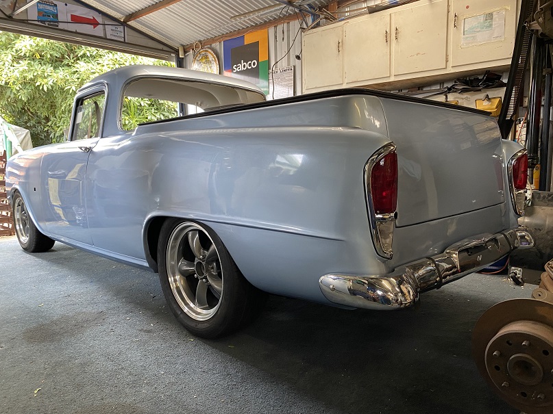

All good so I thought until I dropped the ute down on it's own wheels.
Front tyres hitting on the guards. I will probably down size to 15x 6" :esurprised:

Re: Ammo's Ute
Posted: Wed Jan 03, 2024 6:49 pm
Wow mate! Larry and I may have to pay you a visit next week. Tail lights look awesome! 8)8)

Roger, remind me what front brakes you are running ? If they are HQ or Commodore you might get away with those rims if you go to P76 rotors ??
Re: Ammo's Ute
Posted: Wed Jan 03, 2024 8:45 pm
by Mick
maybe just the pic but wheels also look out at the top? :think:

Redneck wheel alignment, no way !
I have gotten sick of the deer in the headlights look when you rock up to aligner and ask for a wheel alignment so I do all my own now.
Its quite easy if you understand the values and it can be done with simple tools, I also have wheel alignment degree plates which was the dearest expense, but a string line a level and some know how it's fun and rewarding. Wheel base, toe in/out camber and caster can all be done on the floor.
Anyhow Roger those wheels look good, I have 15x6 on the front of mine with P76 discs, it rubs ever so slightly on the drivers side, the guard is a bit different in shape but you cant tell just looking at it.
I like the look of the car and colour and yes the tail lights do fit well.

I'm using VS commodore brakes with 15" wheels so clearance issues with calipers. I have the Stub Tech 50mm drop spindles
Off set is 15+ not the normal commodore 43+.
Looking at the photo the wheels do seem a little out at the top. Something to check tomorrow.
Thanks for the comments guys.

Posted: Wed Jan 03, 2024 10:18 pm
by In the Shed
Looks great Roger, love the tail lights and the fit you have got with the tailgate very sharp. :thumbsup:
