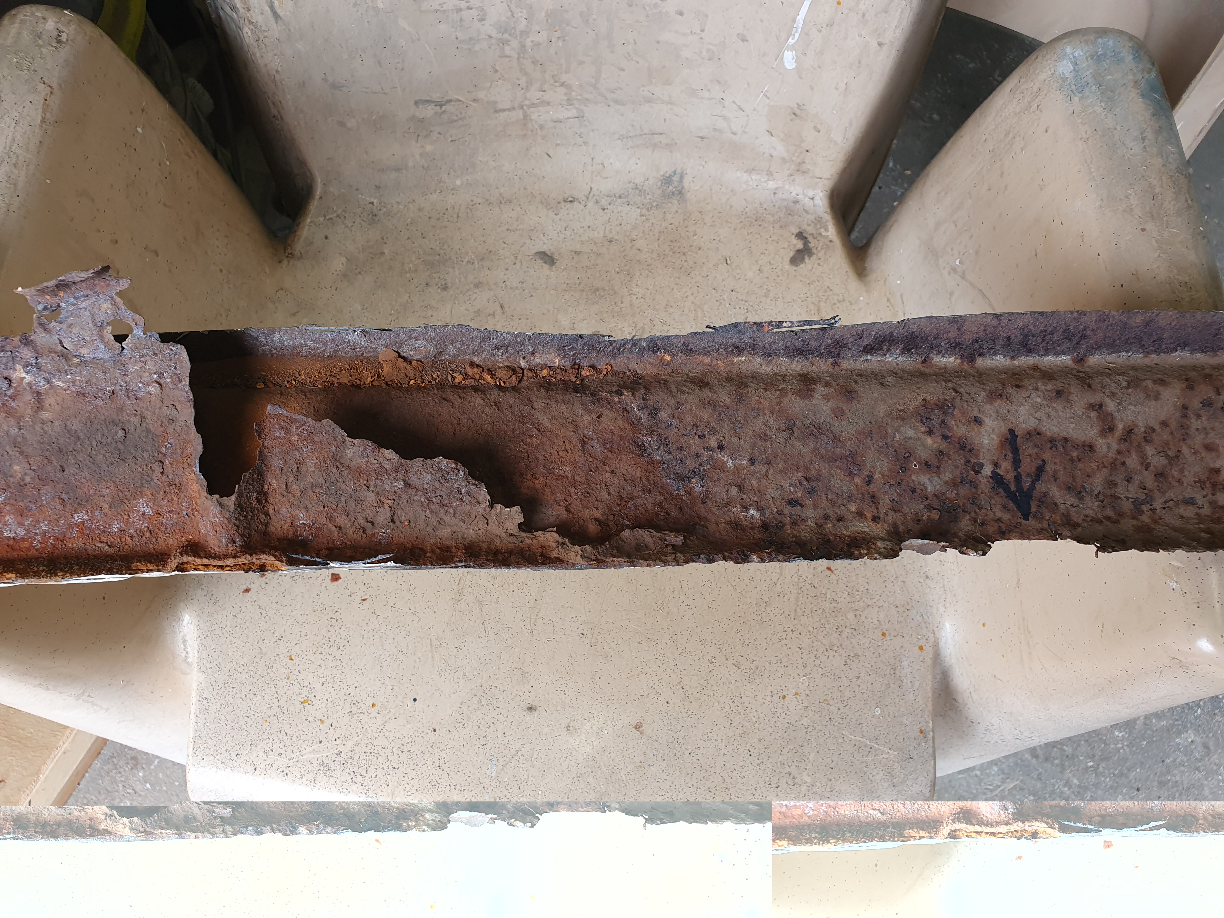

There aren’t any centre sill sections being produced. Out of sight is out of mind. What I did:Image
Four or five cut outs along the bottom for drainage.
Just to prolong this discussion a few more minutes: what you appear to have have done Clay, is what I have done- supported/strengthened the inner sill. The thing I am raising is that Holden braced the outer sill from top to bottom, not strengthened the inner as you and I have done, albeit in different ways.
Is it an issue? Probably not given FC FE utes didn't have this brace at all, but... the support of the B pillar comes from the outer sill pad.
