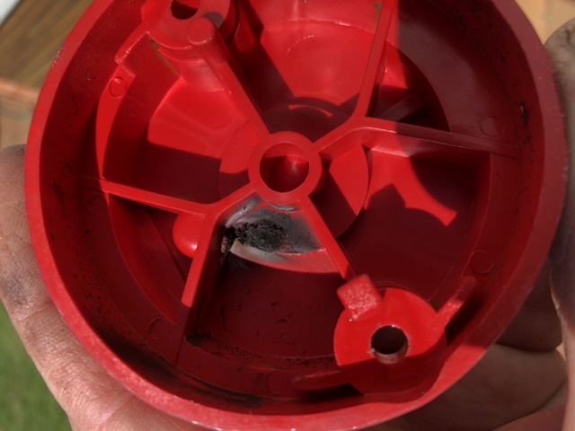

Had a good conversation with the dyno bloke, and settled on an ignition upgrade. Bought an MSD Streetfire box. It’s like a simple version of the 6AL type boxes... think of it as a massive capacitor. Sent the dizzy to the gentleman, who removed the internal module (yep... it was fried) and wired in the box. No more electronics in the dizzy. He ran it up on the dizzy bench, all good. Coil resistances spot-on.
Got the bits back, and wired it all up. Going by the size of the power leads, this thing must draw some serious amps. Put it all back together, and kicked it in the guts.
Nothing.
No spark at the plugs.
Checked wiring. All good. What idiot tidied it all up in split loom, making it hard to check?
Checked power. All good. No LED on the box though.
Made sure earths were clean. All good.
Realised I’d mounted the box on the wooden glovebox. Maybe the box chassis needs to be earthed. Tested, and yes the box chassis is isolated from the box’s big earth lead. Ran a seperate box chassis earth. No success.
Doubted myself, and thought I might have been 180-out. Turned dizzy. No success.
Re-read instructions for eighth time.
Followed MSD test procedure - big fat spark out of the coil. Nothing at the leads. Looking hopeful... problem is in the dizzy.
Called the dyno bloke, who did the right thing and dropped over this morning. Retain all the checks. Pulled the dizzy apart, and the big rotor had crapped out. Big burn marks under the assembly, short to earth. Remind me never to act as the earth path for that capacitive discharge box 😳
Off to buy a new rotor tomorrow. Hopefully noise by the afternoon.

Harv wrote:Had a good conversation with the dyno bloke, and settled on an ignition upgrade. Bought an MSD Streetfire box. It’s like a simple version of the 6AL type boxes... think of it as a massive capacitor. Sent the dizzy to the gentleman, who removed the internal module (yep... it was fried) and wired in the box. No more electronics in the dizzy. He ran it up on the dizzy bench, all good. Coil resistances spot-on.
Nothing.
Called the dyno bloke, who did the right thing and dropped over this morning. Retain all the checks. Pulled the dizzy apart, and the big rotor had crapped out. Big burn marks under the assembly, short to earth. Remind me never to act as the earth path for that capacitive discharge box Image
What a journey Harv - hope it’s sorted today for you
Re: harvs ek 327 wagon
Posted: Sun Oct 11, 2020 11:20 am
Wonder why it did that. Let’s hope it’s a one off. Maybe the unearthed box?

Not sure. When I pulled the dizzy out a week or so ago, the rotor central steel "tang" that contacts the central coil lead was bent. Suspect it was bent when the engine was being rebuilt. Not so bent that it wouldn't work, just not square. The dyno guy straightened it out by hand. The tang is held on by a screw. Maybe he tightened the screw, or the bending flexed it. The screw is blind, but it looks like the bottom of the blind hole has cracked. Power from box to coil to central coil lead to tang to screw to crack to guts of dizzy to earth.
