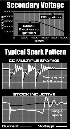

It's got an electric fuel pump, and I fitted a safety switch to it (Peel Instruments CP30) years ago. When the ignition is first turned on, the little black box runs the fuel pump for 2.5 seconds to prime the bowls. It then looks at the coil low-tension negative post, and is looking for the pulses as the coil fires. The car starts, nice pulses on the coil negative, and the little black box turns on the fuel pump. If the engine stops, the pulses do too, and the little black box turns off the fuel pump. It stops the fuel pump feeding a fire during an accident.
Turns out the little black box doesn't like to play with the MSD ignition box. The little black box is looking for a peak of at least 3V, and then a trough where the coil voltage drops right off. The MSD box is a capacitive discharge unit. It gives multiple spark signals to each plug, very rapidly. As far as the little black box can see, there is no "trough" in the coil signal, and hence it will not let the pump run.
Capacitive discharge ignition voltage.png (36.31 KiB) Viewed 879 times
Bypassed the little black box, and off it went. Runs well. Spoke to Peel Instruments, and they reckon I can take the little black box lead off the coil negative, and wrap it around one of the high-tension plug leads 7-8 times. The spark plug zap will be enough to induce current in the coiled wire, simulating a signal to the little black box. Because the little black box is only seeing every 8th plug firing, it will think that there is a pulsing current. Haven't tried this yet (it seems a little dodgy, and to be honest I'm happy having the damn thing running again), but may get my tinfoil hat out later in the week and try.
