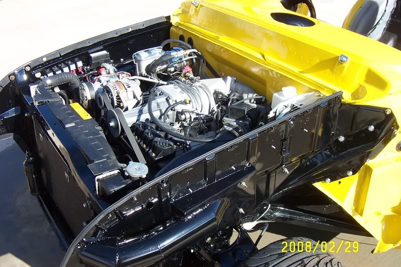

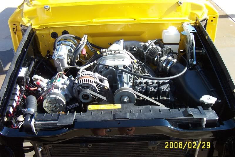

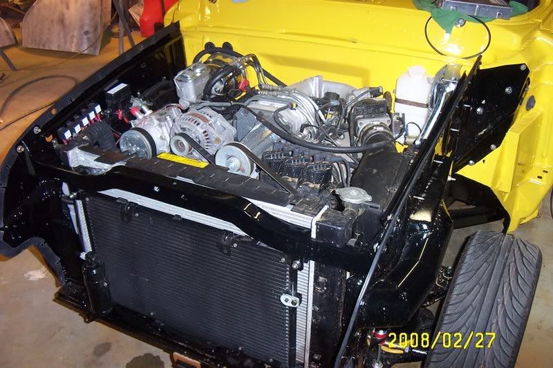

Hey all,
A little bit more done, but mostly sorting out mechinical stuff.
I went to add coolant and more came out the seam of the radiator
than I could pour in. So another $220.00 for a new radiator tank
to fix the problem and it now holds water.
Another EBAY bargin, the radiator was ment to be in perfect condition :lol: :lol:
Anyway after many hours of stuffing around :x trying to get air
out of the system it finally all works. It was a case of lots of reading
of the manual to sort things out.
So I've just added a couple of pickies of the engine all in. Just have
to get the A/C gassed up now. Some things are sent to test you I
tell you, after fitting all the A/C unit under the dash, when I turned
it onto high it vibrated like you wouldn't believe. :shock: So just
before I started to pull it all out again I took off the front fan cover,
a job in itself and there it was a fukcen self tapper that had fallen
into the fan. Once removed it was perfect. :wink:

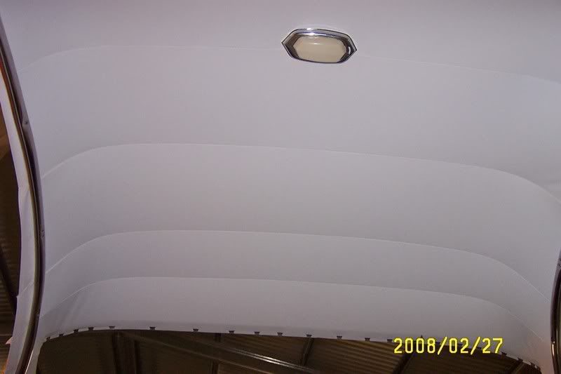

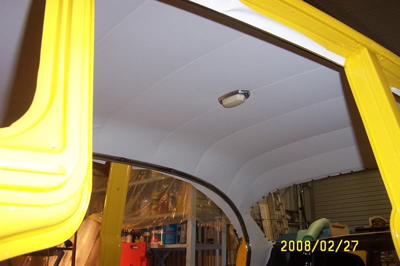

I also rust proofed the body prior to fitting the hood lining. For the
rust proofing I used fish oil with a mixture of very light oil. Boy I
hate rustproofing :x
Once that was done and a couple of days passed for all the shit
to run out I fitted the hood lining. Reasonably easy job to do, I
put it in place one day and held it there with bulldog clips to get
a few of the creases out. The next day I glued it all up and still held
it with clips. The following day it stretched out a bit so I retensioned
it all up again. Only have a couple of small rinkles now that time will fix.
