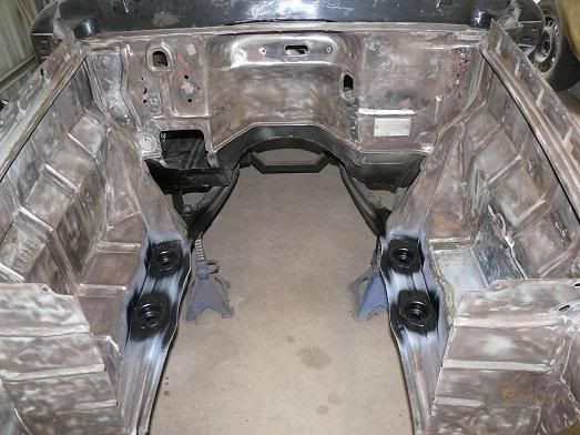

Hi Rick. Not too sure about 14" rims - I'm thinking maybe not, but I'll have a look tomorrow & give you a more informed view. In between time, here's a few more photo's of where we're up to. Cheers, Steve
Engine bay: Paint stripped and superfluos holes filled for painting:
Front end bolted in:
and back on her wheels ( at long last);
Next will be paint the engine bay (if it ever stops raining up here!) & slip the donk back in - hopefully to stay.
