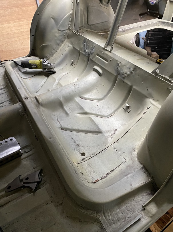

I have started on the 4 link and need an extra arm and hand to hold the brackets in place
Set the sedan up on my blocks at full " low " position, got one bracket under the diff using a small scissor jack and then use a block of wood to prop up the front lower bar.
Push and pulled it into line with the view of tack welding, wrong - no room to weld.
So I made more room. Now I can get the to the brackets.
The patches on the floor, were from chassis rails that I did some 20 years back with a gasless mig.

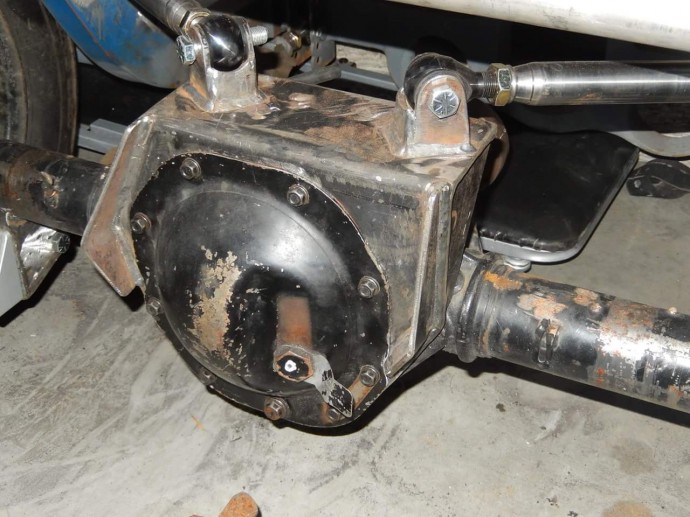

If it helps this is mine. I made a custom mount for the two short arms which allowed them to mount centrally above the diff.
- IMG_2258.jpeg (111.93 KiB) Viewed 8019 times
- IMG_2257.jpeg (109.58 KiB) Viewed 8019 times

Good work Roger,
For consideration, where you mount the brackets to the chassis rails use a plate first then weld the brackets to that.
It helps spread the load on the relatively thin holden metal, Taz has custom rails so no issue for him.
Your engineer may also request it.

Re: TT Sedan
Thanks Taz for the photo's as very bit of info helps when do this for the first time.
You are correct Greg, the engineer has requested I use 3mm plate when I when onto the chassis rails.
I will likely weld the plates on the front upper brackets on the bench then weld the 3mm plates to the rails.
