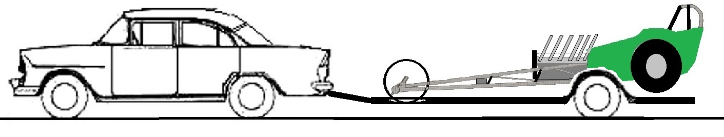

Got measured up so that the chassis will fit. Getting exciting.
The overall length ends up almost exactly the same length as an FB sedan. Artist's impression below for scale.
FED to scale.jpg (77.81 KiB) Viewed 1862 times

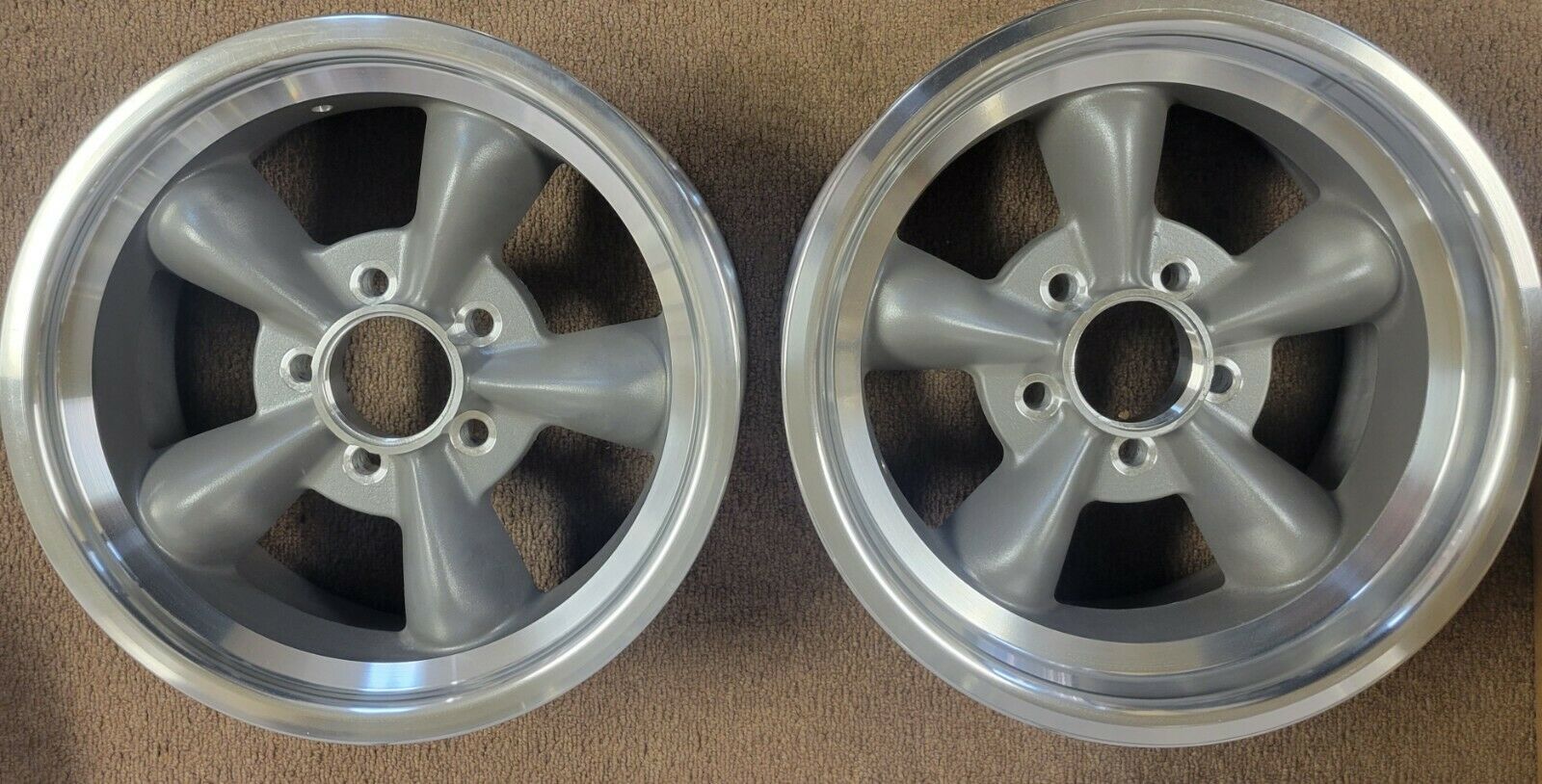

Got this one from ebay to replace the one I robbed from the motor formerly destined for the van Image
You can get them new $178. I paid $120, had I known.Image

The diff housing goes from Craft Diffs over to the chassis builder this week, so I better get a little more serious with the wheels.
From the photo above, the wheels that interested me were American Racing Torque Thrust D’s. Can get them in chrome, black or grey (sadly no gold), so went with grey. Looks close enough to old magnesium wheels. Aiming for HQ/Chev stud pattern (easy enough to find lots of sizes in that pattern) and 15” diameter (to clear some Commodore disks on the diff). The disks aren’t overly traditional, but I’ll make a concession for safety (the idea of ending up in the sandpit at the end of the quarter mile does not appeal). Went a little overboard with width – could have run 8”, but decided on 10”. It will not be short of tyre, but figure if I (or a future owner) upgrade the engine then the diff/tyres will be ready for it. Was surprised that Purnell Tyres in Queensland was a lot cheaper than most of the major suppliers (and so far pretty good to deal with too). With the wheels sorted I can then get the diff shortened to the correct length once the initial fit-and-fiddle in the chassis is done.
Wheels are no good without tyres, so aiming for some 28/10.5-15 ET Drag slicks from Mickey Thompson. Rocket ended up being the cheapest for these. They are a moderate compound, as with all that width I don’t need anything overly sticky. The guidance from MT is that with the low FED weight I can aim for around 7psi tyre pressure. These tyres can run tubeless, though have a very thin sidewall and will leak down… maybe lose 5psi over a week. No big deal for me, and simpler running without the tubes. They reckon if the inside of the tyre is coated with dishwashing liquid before mounting then the leak rate is a lot lower. Drag tyres run the risk of spinning the tyre on the rim. Not much likelihood with the low power I’ll make, but if tubes are run then there is a risk of tearing off the valve stem. The solution to that is to run tyre screws… pretty much 8 or so tek-screws put through the rim into the tyre bead (ok… maybe not quite tek-screws…. Moroso do a fancy version as a self-tapper). Sounds archaic but is pretty common drag practice. I’m figuring I could do without that hassle too. So plan is to run no tubes, and see if the tyre deflation over time is acceptable. Mark the rim and tyre with a paint line and see if the tyre slips much on the rim over time. If it slips, I’ll fit screws, and while I am at it fit tubes. Drag tyres are supposed to be balanced, with MT recommending either bubble balance or static balance (no road force balancing). No idea why road force balancing is not allowed, but shouldn’t be too hard to static balance.
