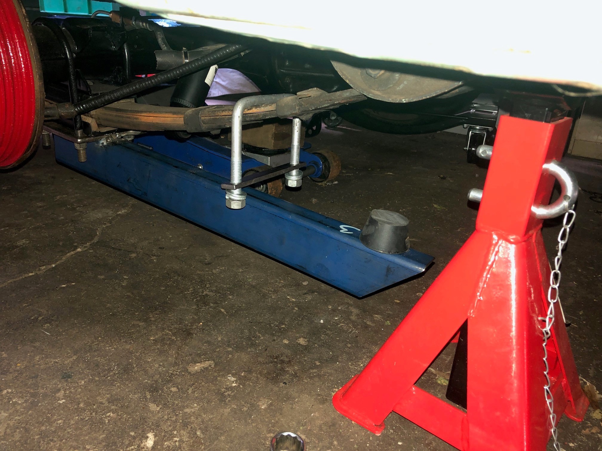

This time, the right way up.
traction bars second go.jpg (874.49 KiB) Viewed 6311 times
(... not that I'd tell anyone, but I checked three times before tacking them again, and had to bolt them up to make sure before reposting a photo :oops: ).
The u-bolts aren't tight, but you get the idea. Big gap between the snubber and leaf spring eye. That reactangular u-bolt should hold the traction bar pretty close to the spring, but is way off and just floating in space in the photo. Needs a wedge at the diff saddle clamp. Nolathane bushes on their way, will see if I can butcher them to wedge it.

I'll need to be a little careful though on the thickness of anything between the spring and the traction bar. Rough measurements a while back show that the bottom of the traction bar RHS tube sits pretty close to the ground. It's touch-and-go whether that bottom edge is lower than the 13" wheel rim. If it is, then the traction bar will bottom out during tyre deflation... and the engineer will get upset. I could always cut that edge away and box in the RHS again, but trying to avoid that if I can.

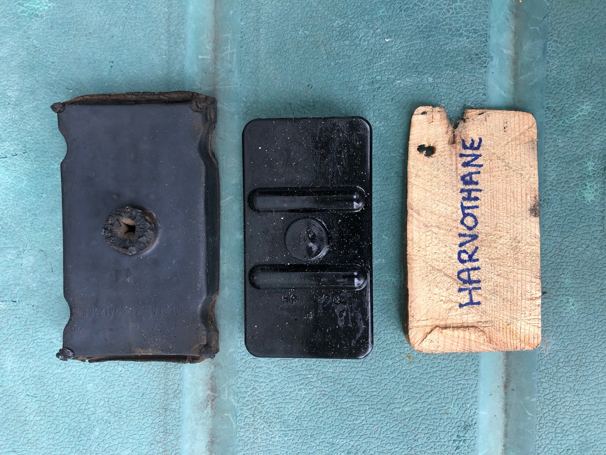

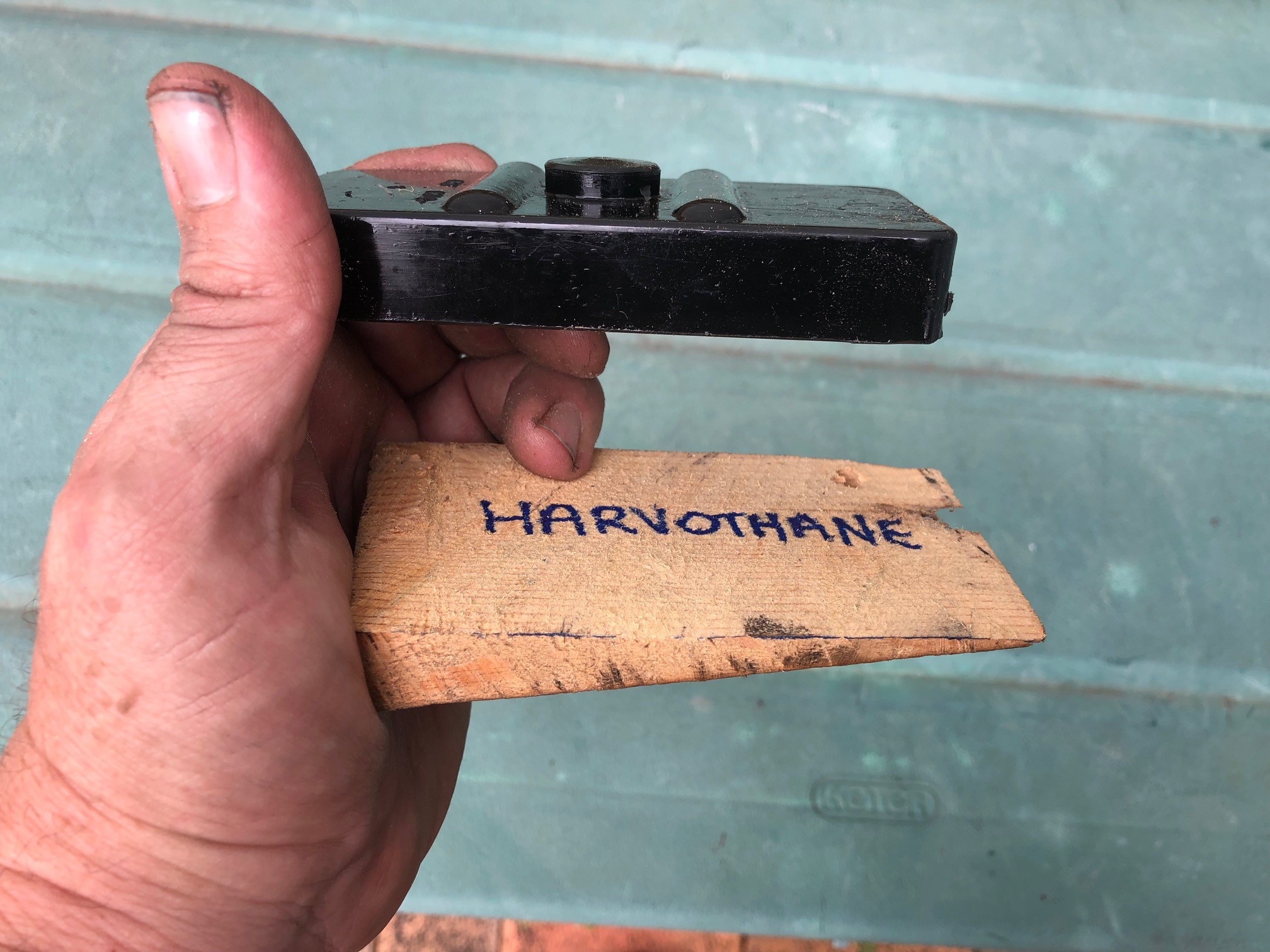

The nolathane diff saddles arrived (very sexy) and I thought about cutting one down into a wedge. Had an epiphany that it would be cheaper to do in wood (as I am likely to stuff it up) before butchering the Nolathane. Made a dummy nolathane saddle out of some scrap (Harvothane). Cut it down into a wedge, and dummied it up.
Harvothane 1.jpg (493.18 KiB) Viewed 6243 times
Harvothane 2.jpg (1.01 MiB) Viewed 6243 times
The Harvothane wedge fits great (it will effectively be half of a Nolathane wedge each side). The traction bar sits horizontal when under static load. All good.
