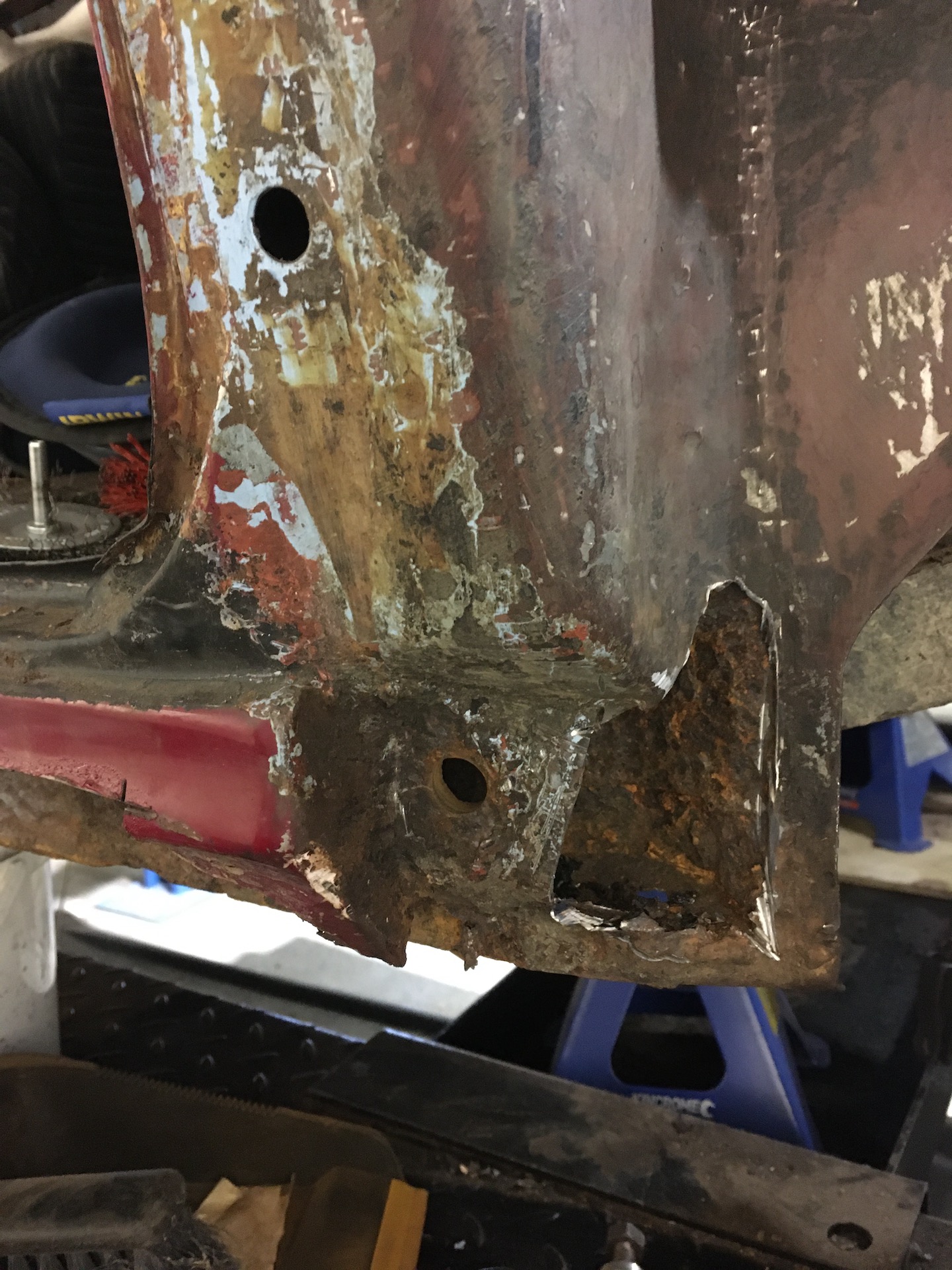

Then I got to the A pillar. Both inner and outer A pillar sections need work, as well as the subframe bracket. There is also a bit of rust in the floor around the A pillar that has been badly patch over.
Scott
Posts: 11301
Re: Ol' Rusty - FB/EK Sedan
It is a big job but the replacement panels help. Inner can possibly be saved? Patch from the inside and paint and protect well.
