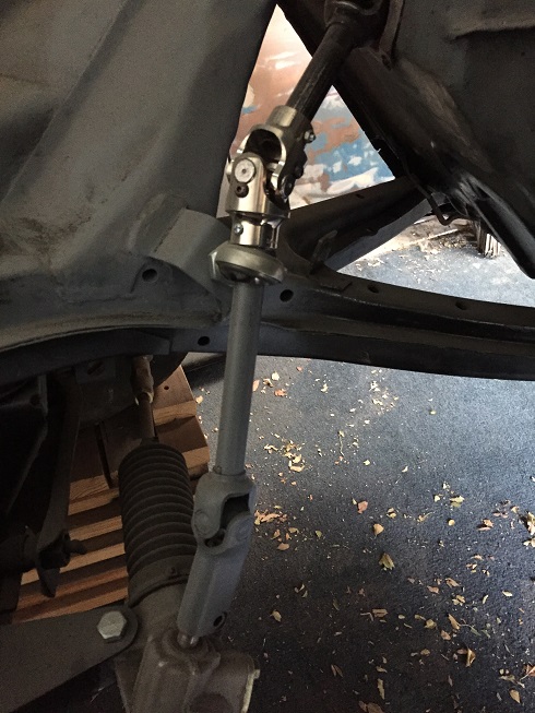

Don't mean to hi jack the thread Roger but I have done the rear mounted rack and pinion thing twice now first on my FC V6 sedan and then on Frank same manual rack as yours Roger but mine was from V6 Conversions, I ended up doing the same as you with the linkage on the FC it was really frustrating trying to connect it without it binding on the unies I realised it was my steering column that came through the firewall a little to far and that caused the angle to be a bit too acute down to the rack.
When I did Franks I made sure the VT column was in the right spot and didn't have to put in the intermediate uni joint.

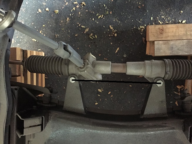

Firstly I did not measure the rack before shortening but a quick measure this morning show it is 925 mm from thread tie rod to threaded tie rod.
The distance from bolt hole to bolt hole is 285 mm

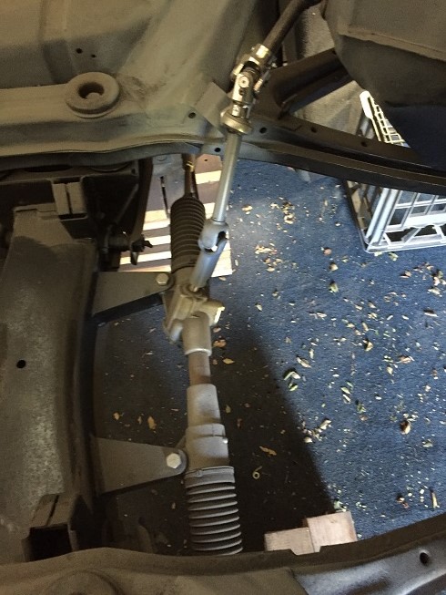

The mount were supplied by Rod Tech and although they appear some distance from the cross member, the rack lines up with the steering arms.
Steering 8.JPG (117.62 KiB) Viewed 855 times
Very important to maintain the same angle as the lower suspension arm.

The angle from the column was too great so I added the mounting.
I needed to position the column, not play with the length or collapsible area and have it so Anne-Marie and I can drive comfortably.
First uni joint is basically just inside the firewall so not sure I could have done it differently.
Trust me, if I did not need the mounting support I would not have used it but It does eliminate the binding.
steering 9.JPG (148.45 KiB) Viewed 855 times

Rear mounted are favoured for better steering geometry, you can retain steering arm and calipers position. Looks like a good setup geometry wise in replicating original and eliminating bump steer. So far that is as good as stock steering.
Where stock falls down is insufficient toe out on turns, which contributes to good ol’ understeer were all a bit too familiar with. If the rack improves on toe out, is precise relative to rebuilt worm and sector, retains lock to lock and is at least no heavier than stock, then I see the point. Rod tech I think they know what they are doing?

275mm crs
285mm rods racks, rod tech, alien retro columns
335mm v6conversions
