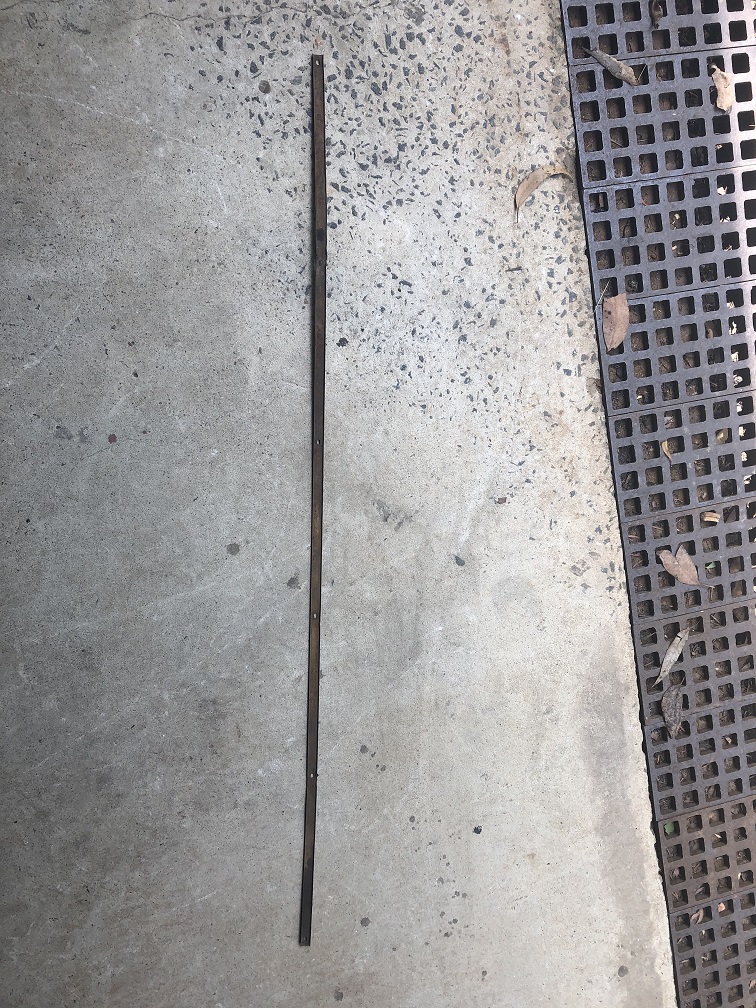

So like this but straight?Image
Re: Photos of floor pan
Posted: Fri Apr 10, 2020 8:06 pm
'zactly

Thanks Rosco- appreciate your thoughts and experiences here. I am thinking that I wont invest in these strips because it seems to me that all they would do us dump everything back on to the inside/back of the bumper. I wonder if the better option is to keep it all open and spend the effort coating the inside bumper with rust protection ?
Posted: Sat Apr 11, 2020 1:20 pm
by rosco
Brett,
preparing and sealing the inside of the bumper is paramount, in my opinion. I even did the insides of my hub caps... I don't do the inside of stainless, but everything else which comes off gets the treatment...
The rubber flap was put there for a reason.. more likely to prevent the rear panel getting dirty from updraft... I don't believe it is necessary, but attention to the manner in which the rear panel is cleaned will need additional care...
By its very location, the panel will be subject to receiving a good liberal dusting and coating of crud.. fine particles - some almost invisible.
Wiping over that panel will cause micro-scratching... and also embed a cleaning cloth/wash mitt with same.... which will add damage to anything it is used on afterwards...
By comparison, I believe this back panel would receive just as much or more of this damaging grit than the lower door/guard sections... by the location of the panel... it probably doesn't have the same self-draining action at speed.. being in a "drawing" location than a drafting one...
To my way of thinking, this flap does not need to be anything of substantial thickness... a strip of just 1mm neoprene from Clark Rubber would suffice and a flat strip at that.... it will bend to shape under the upper bumper section... and will more than likely bend to a more permanent shape with time.
The difficult bits would be those of around the tail-light assemblies... from memory, these are fitted separately on each side and there is some form of over-lap of the three sections (long time back now).
You may find a suitable "molded" piece which can be adapted from a Clark rubber stocked item .... they carry many such items for varying products.. washing machines etc., etc.... there is more than likely something which has an approximate curvature of the lower tail-light radius...
I would fit stainless self tappers to retain these two pieces .. with a simple piece of painted thin flat steel which has been rounded to shape and drilled to suit the mounting holes in the tail-light.
If, however - you make the corporate decision to run "au natural"... and do not fit these strips - I would seriously suggest you seal up the mount holes in both the rear panel and also each tail-light... again, I'd go with stainless self tappers and a good coating/caulking with Sikaflex (love that stuff!).
Yes - if you follow my thoughts on fabrication the seals - it will put you back a bit... but improve a project which will add further to your satisfaction in the build..... and, like so many others of these - not seen by anyone except yourself...
