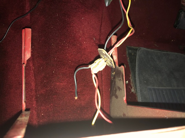

Black wire? we don't need no steeenking black wire.....
Whilst poking my head under the dash for the radio, I bumped the centre console. No hold down screws. Figured I'd lift it off to peek at the heater, as the heater fan doesn't work.
Found the wiring to the heater switch hanging loose, and the black wire broken/dangling.
Brown wire not shown in photo: provides 12-volt positive power from the fuse panel to the fan motor (protrudes from heater casing). Wire in place, and live.
Black wire: connects power from the motor to the heater fan switch. Wire busted, dangling, and waiting to find an earth
Yellow wire: provides an earth for the heater fan motor on high-speed.
Red wire: provides an earth for the heater motor on low speed (via the low-speed resistor).
How this thing has not turned into a phoenix I don't know.

You're going to need a heater fan switch. Got one of those. Do you need a centre console as well? Read post. No, you don't need a centre console. Does the heater fan work?
Re: Harv's HR Holden Premier wagon
Not sure on the heater fan... that's one of this afternoon's tests. The quick look I made makes me think the ducts and demister nozzles are absent. Will have to have a better look whilst fighting the fan.
I suspect I can solder the black heater wire back together again, and remount that bakelite insulator. Might save me having to replace the switch (though thanks for the offer). Console is OK.

While I had my head under the dash, I had a play with the heater. Once I held the black wire back on, the switch and fan worked great - off, slow and fast (I thought it might have been off, dim and flicker
