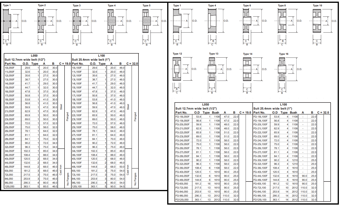

3. Width - The width is shown in the last part of the belt designation. Light pitch belts suitable for McGee injection pulleys are available in ½”, ¾” and 1” widths. From our example, part number 270L050 is 0.50" wide. The belt that was supplied with my unit was ½” wide. As this is very much less than the 1 7/64“ pulley width, you can probably get away with not running flanges on the pulley. If the wider ¾” (or 1”) belts are used, the risk of the belt walking off the pulley increases. To counter this when using the wider belts, at least one pulley should have flanges. If the belt is short enough, each of the pulleys can have a flange on one side. When the span (center distance between shafts) is eight times or more the diameter of the smaller pulley, both pulleys should have flanges.
Similar replacement pulleys are available from Naismith Engineering:
https://www.naismith.com.au/list_products.php?m=42
The table below shows their L-profile belts:
Naismith Engineering L profile pulleys.png (289.2 KiB) Viewed 4699 times
