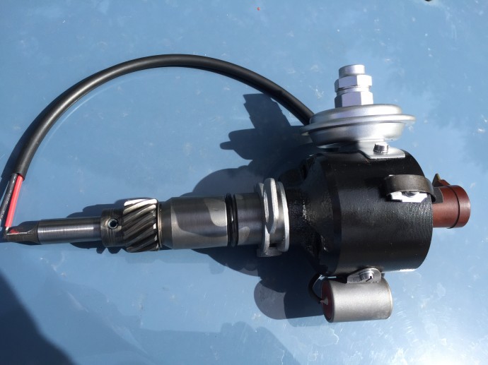

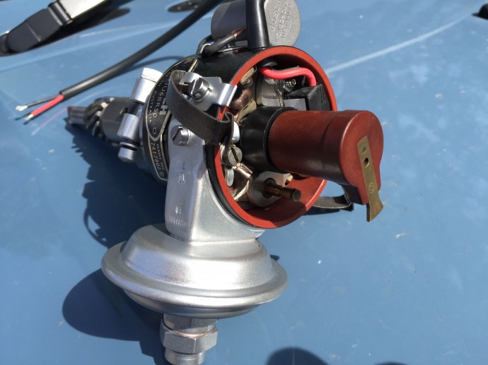

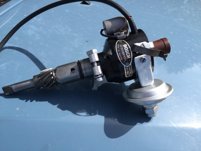

Picked up the dizzy today - full refurb by Performance Ignition services in Nunawading - Pertronix conversion plus a new 3 ohm coil - can't wait for this thing to make some noise again.
Re: WALLY'S EK
What was the dizzy and coil upgrade worth ?,if you don't mind me asking .. Sounds like it will be a nice old cruiser
Re: WALLY'S EK
was 630$ - included the dizzy itself having new bushes and general overhaul - new vacuum advance - Pertroniz point kit fitted and new Scorcher 3ohm coil
I was lucky in that the shaft and gear was all in near new condition.
they cleaned and re-painted the dizzy housing and took great care to ensure all the old badges and plates stayed in perfect condition.
They also set the dizzy up for the motor re-build I had done as the changed cam and compression would require slightly different set up.
I left the condenser on to keep it looking stock but it's not connected.

Dissy looks great Wally. Just one thing, check that you have enough clearance between the rotor and the cap. The magnet ring in these kits prevents the rotor from fully seating to the extent that it may foul with the cap (button fully depressed due to the rotor sitting too high). On both of my cars I have had to dress down the bottom of the rotor arm till it seats as per normal on the shaft.
Re: WALLY'S EK
Thanks Craig - I'll be sure to check that before we spin it up

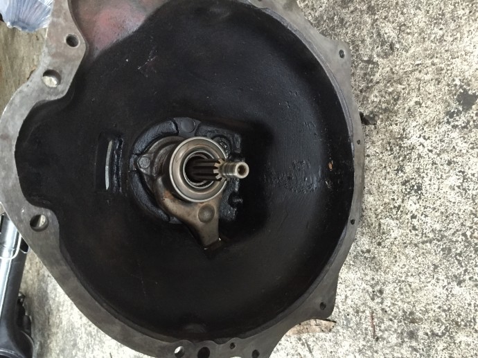

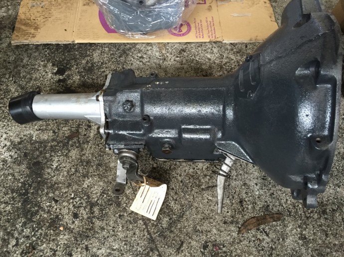

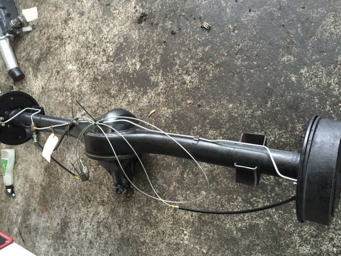

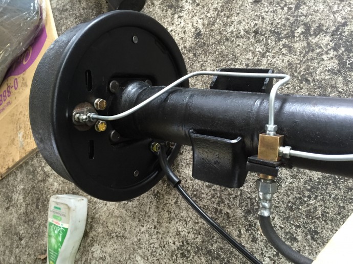

Diff/gearbox/tailshaft and steering column all sorted and ready to go back in this week.
took the opportunity to have a 3:55 centre added - tailshaft was pretty banged up so replaced with a new balanced one
New brake lines and handbrake cable(rusted in the tube plus the tubes were all cracked and falling to bits plus some new return springs - looks pretty sweet
Gearbox had wrong pin bearings fitted so had completely knackered the main shaft - gears were all good though so no major dramas - new bearings and seals and speedo cable connector.
Steering box was in pretty rough shape so needed a fair bit - bushes / bearings and the worm gear were all knackered - years of farm driving.
All done by Barry at Dinkum Autos.
