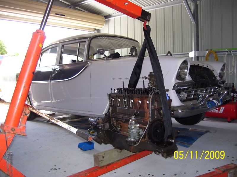

Decision has been made to rebuild the engine now timing gear has failed.
No major issue with engine, other than its almost 50years old.. :D
It does sludge in the cooling system, has a few leaks and is a little fumey.
Nothing crazy is planned, good acid clean and a freshen up with new bearings, seals, etc. May do a little balancing, lightening the flywheel, maybe even a mild "street" spec cam and a bit of head work to ensure unleaded doesnt pose a problem and give it a little extra preformance.
While its off the street I'm going to do a little work to the suspension and driveline as well.. (Just replacing worn bits mostly.)
I need it ready for the next nats, looks like a few QLDers are heading down, so I'd better pull finger.! :shock: :D :D
Engine out..
Timing Gear, minus teeth.. :cry:

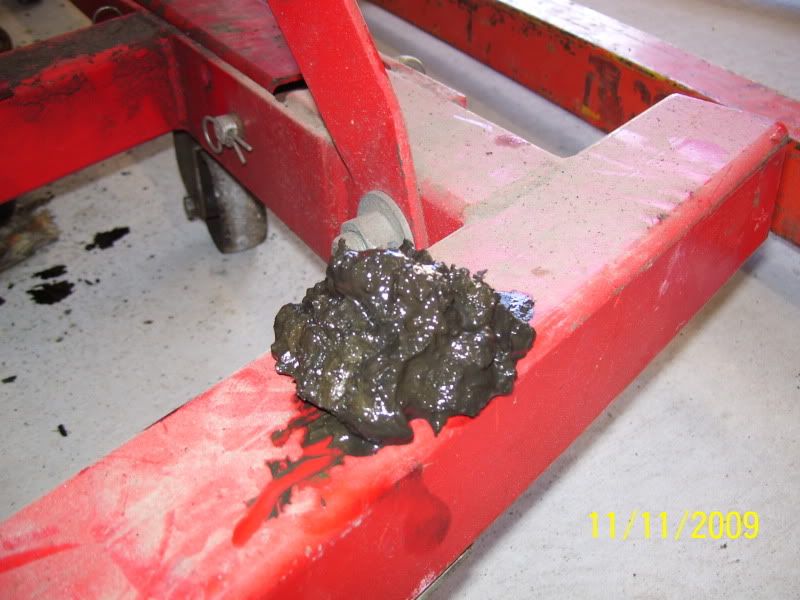

Check this out..
Is almost like mud, not flaky like you'd expect rust to be.
This is what i could reach with my index finger out of the rear most welch plug hole..
Seems more than a normal degradation of cast iron and metal could produce?? Anyway another reason for a full flush and chemical clean.
Gross... :shock: 8)

5 bucks if ya eat some :lol:

I feel sick :cry:

strogger wrote: Seems more than a normal degradation of cast iron and metal could produce?? Anyway another reason for a full flush and chemical clean.
I had my grey block cleaned and all that and still managed to get more crap out by digging around with long screwdrivers down all the welch plug and water holes :shock: , good move to pull the motor out and do it properly, Trev 8) .

YUK !!!
You have to stop letting ya dog hang around in your shed - good thing you didn't step in it !!!
FULL tear down and chemical clean for that old donk thanks very much! Then a nice set of brass welsh plugs and a coat of grey...

Yep, thats the sort of accumulated crap that develops over years of use and applications of various radiator stop leak products etc etc etc and all builds up to create engine hotspots and radiator blockages.
Knock out all the welch plugs, put the engine block on its bum and use a good high pressure washer preferably with added detergent if you have access to one of these washers.Do the head the same way as well.
You'll be amazed at the amount of shit the pressure washer will get out.
I had near half a ice cream container of crap come out of the head and block when I pressure washed my 149 red in my FB.
If you are rebuilding the engine I'd still pressure wash it after the hot tank process and machining process is done as hot tanking alone doesn't remove all this crap and engine machinists often don't clean out the oil passages properly after machining leaving behind amounts of machining swarf etc.

That's true, Terry. I once had a 351 rebuilt some years back. The block was supposedly chemically cleaned.
After I got it back, I was having some overheating issues. When I got the radiator and engine pressure flushed, they found 2 handfuls of metal shavings in the system. :shock:
