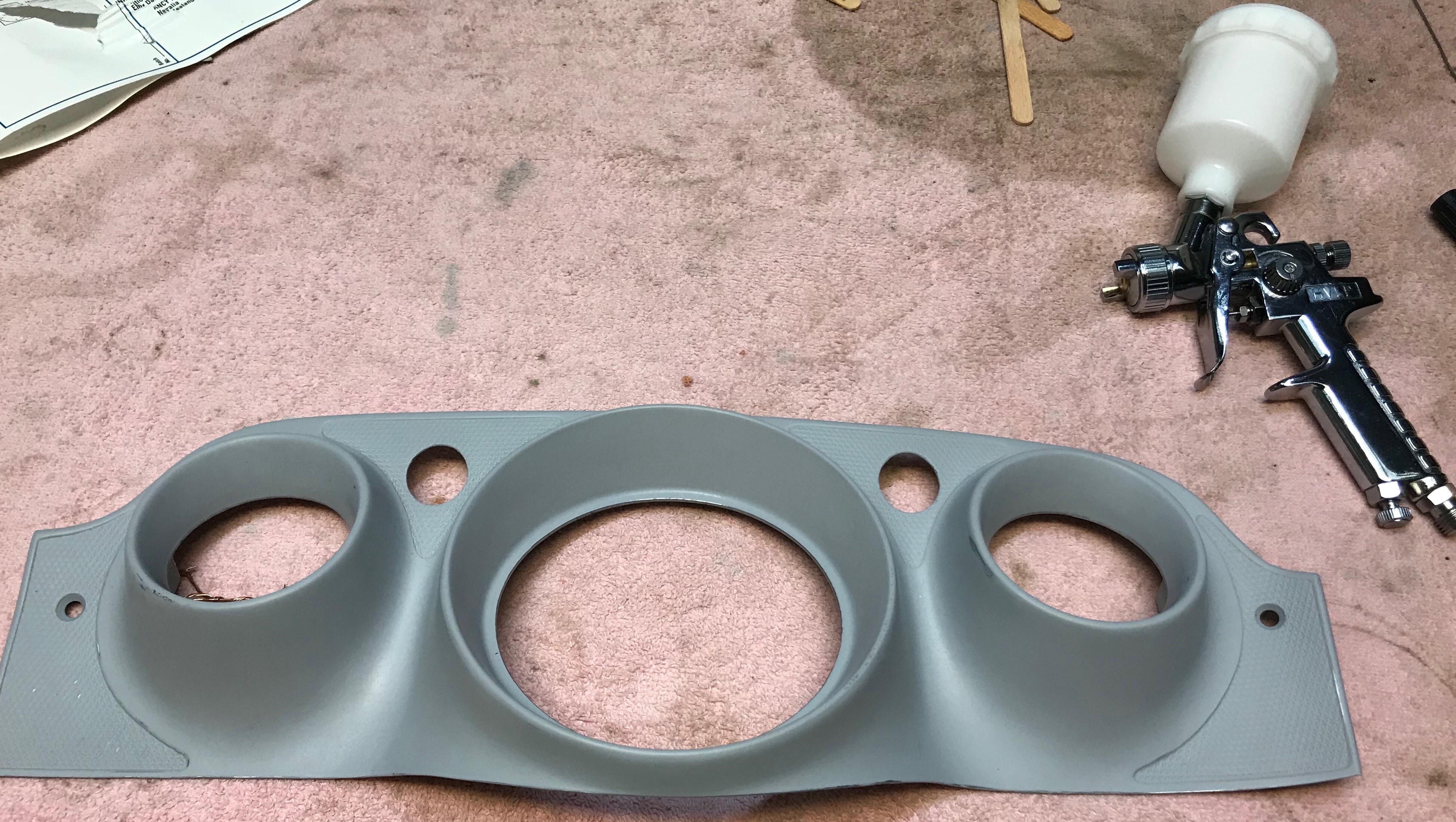

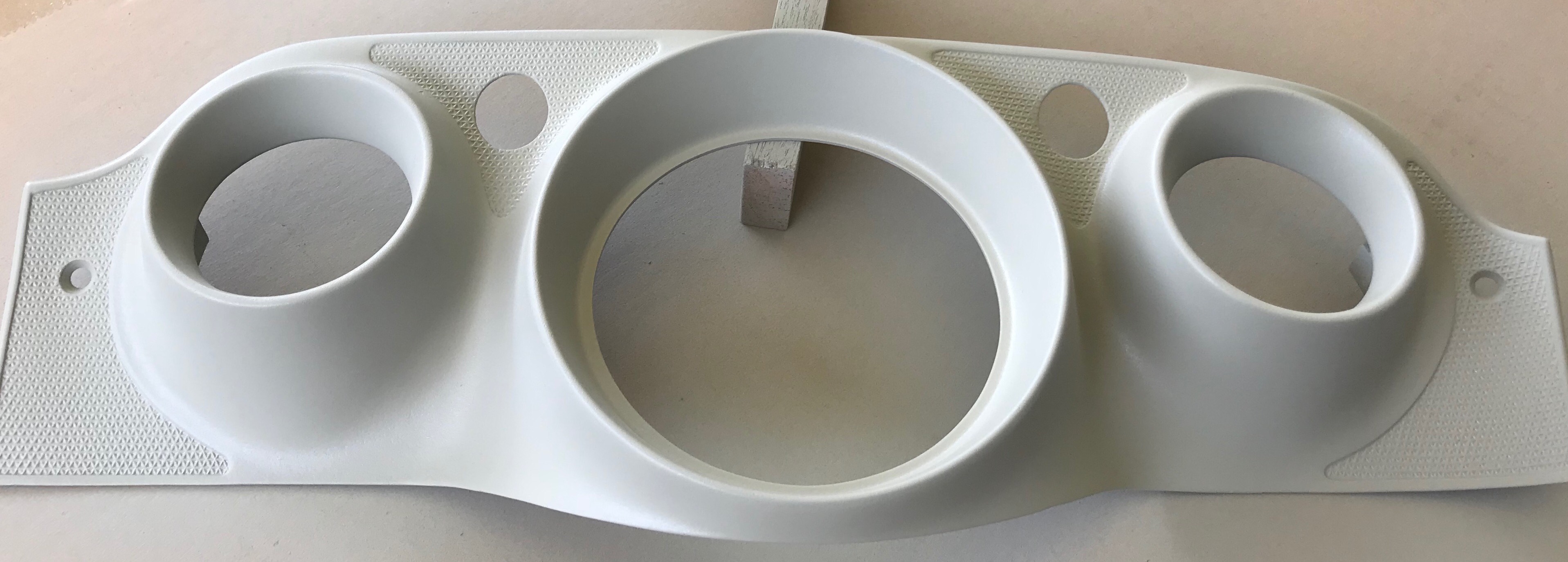

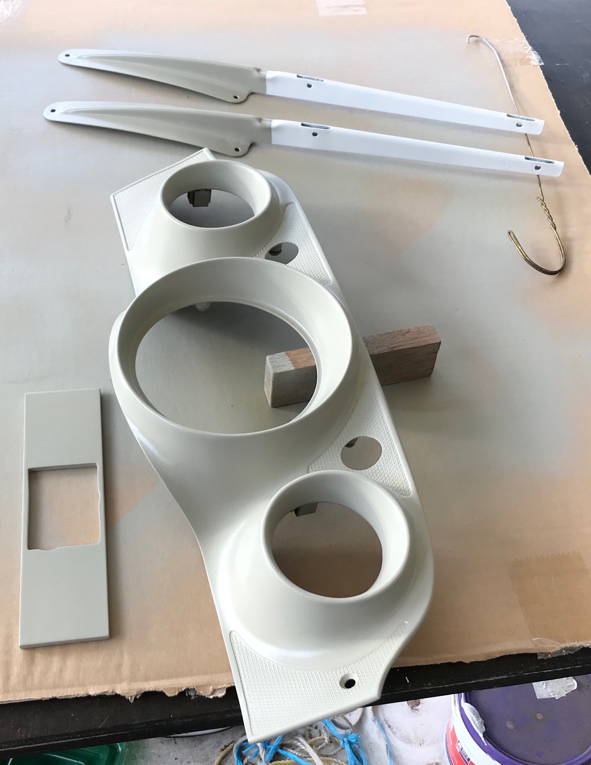

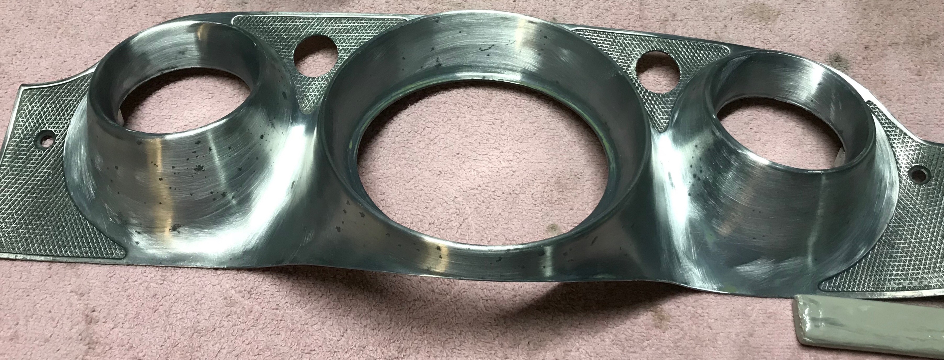

Hi Folks,
I have been slowly putting this ute back to original with a few minor / subtle tweaks along the way. I need to do some spray painting in the future as I am putting my outfit back on the road after 14 yrs of hibernation. As my experience in spray painting has been confined to painting fences (not graffiti painting I hasten to add), just fences around the house I thought I would paint a dash panel for the ute to replace the chrome one currently installed. At the same time I decided to paint the sun visor brackets too.
Some pics of my progress to date, but I would appreciate some advice.
A pic of my spray gun is in one of the pics and I was happy how I had that set up. The depth of colour was ok, no runs and I used wet & dry after 24 hrs & 3 coats finishing with 1200 grade. Applied another 3 coats next day. The finish texture was a little a little rough so used some polish to bring up the shine however I have gone through the colour to reveal the undercoat. I gather I need more paint but not sure why the finish is not smoother. I am using acrylic with thinners at a ratio of 1:1 as per paint directions. I want to paint gloss black on my bike so will need a good finish.
Thanks in advance.
Thanks in advance.
- From the spare parts dept
- IMG_2920.jpg (1.11 MiB) Viewed 1819 times
- IMG_2921.jpg (1.33 MiB) Viewed 1819 times
- Strippped and wet & dry to 800 grit
- IMG_2943.jpg (1.24 MiB) Viewed 1819 times
- Undercoated with 3 coats. Finished with 800 wet & dry then cleaned with paint prep cleaner
- IMG_2973.jpg (1.93 MiB) Viewed 1819 times
- The end result
- IMG_2976.jpg (732.32 KiB) Viewed 1820 times

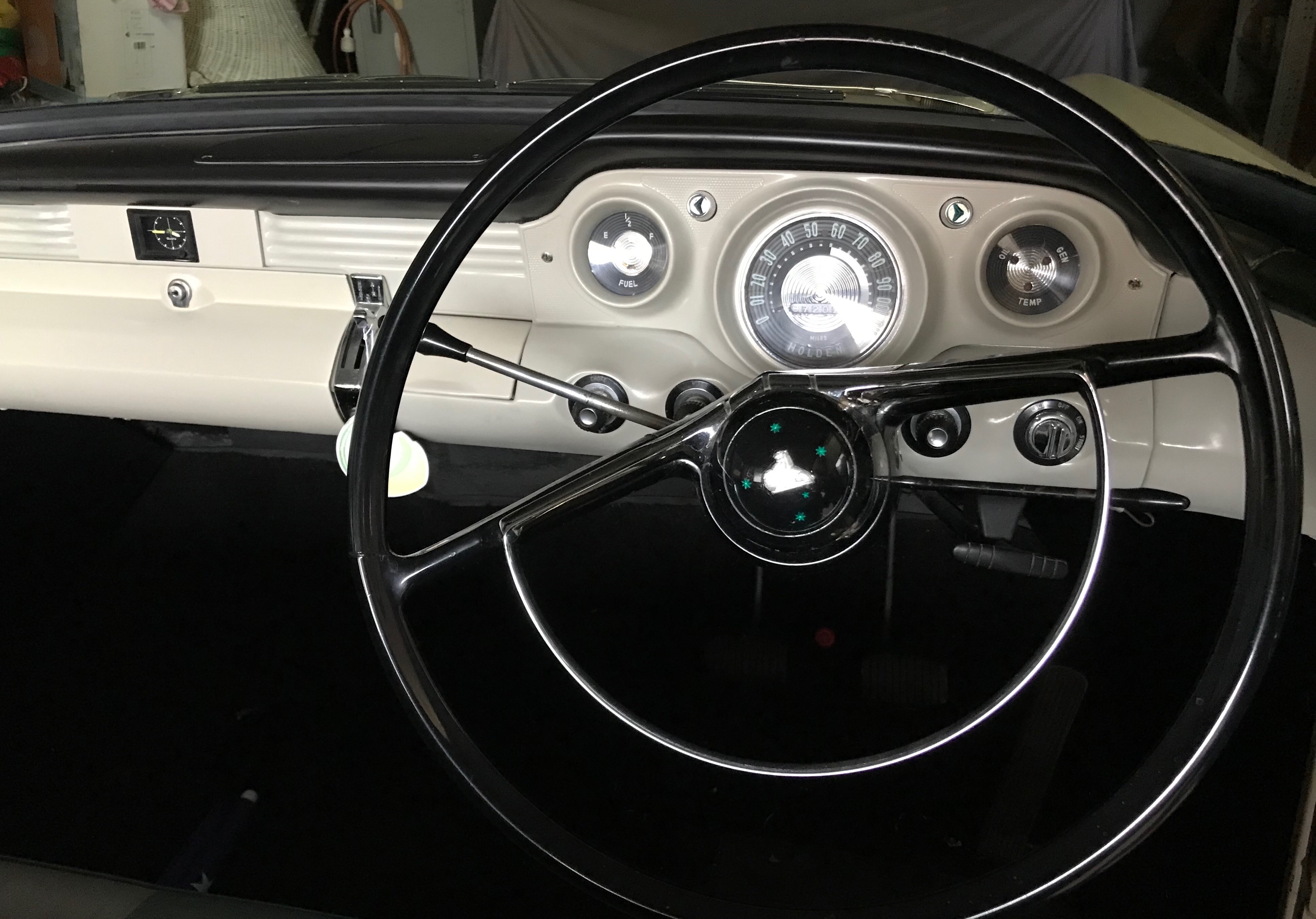

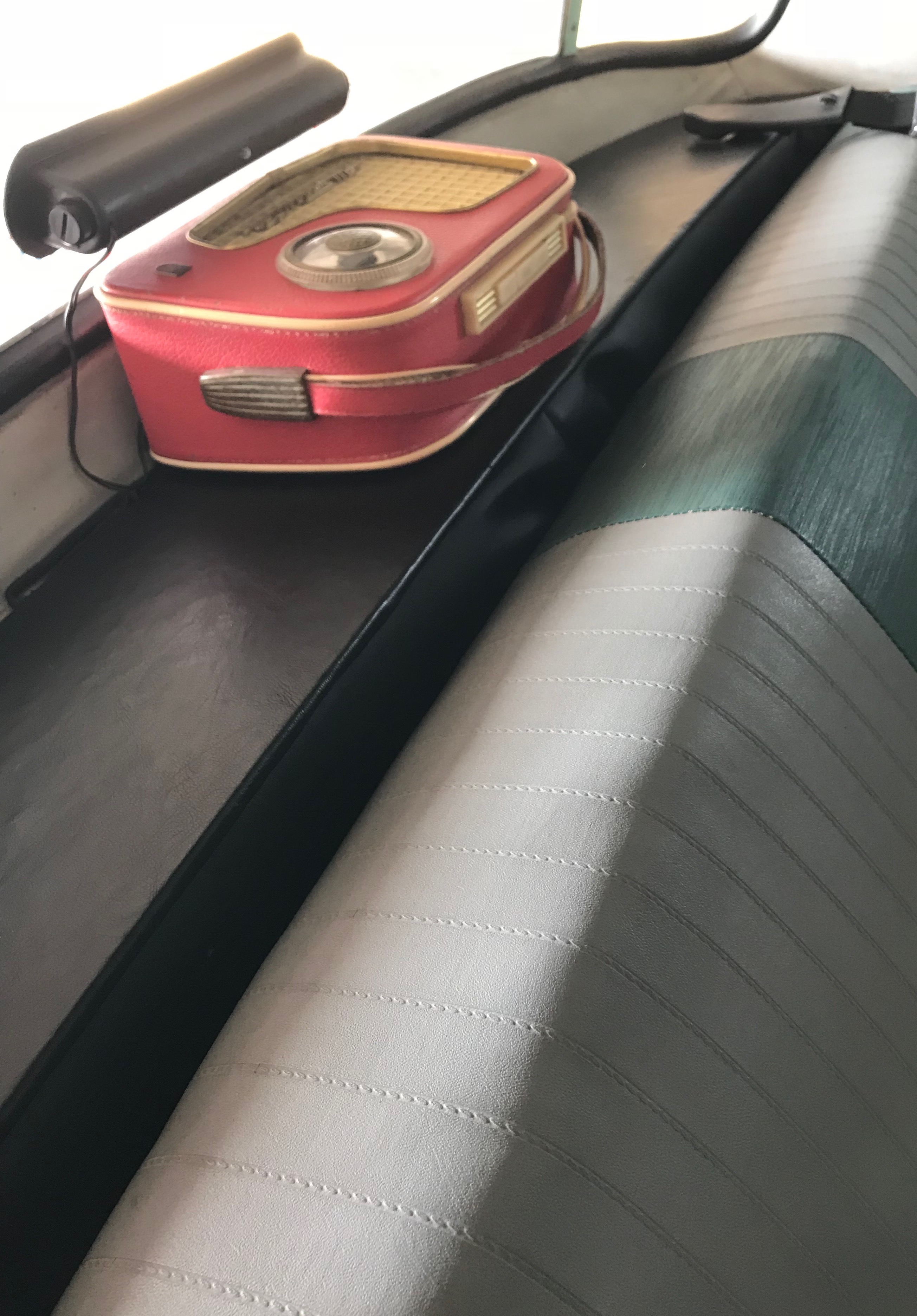

Take 2 with the dashboard painting.
I gave the previous work a fine sand with some 2000 wet & dry and cleaned them all. I increased the thinners to 1.5 parts to 1 part paint. Made some adjustments on the gun and had another go. This time got a much better finish that had a nice gloss level off the gun. After a couple coats I did not do any polishing just let it dry and installed it. So for my first real effort I'm very happy with the results.
I'm not ready to tackle painting a car but certainly more confident to paint mudguards and other bits for my bike later on. A couple pics of the installed dashboard as well as a parcel shelf I had previously made and installed.

I wouldnt be prepping for paint using 2000 grit paper, the work needs some roughness so the paint will key into it , if its too smooth the paint will not bond properly. I would think 600 or 800 max would be preferable ?
Looks good, Stephen. I think the instrument cluster panel being the same colour as the rest of the dash looks neat.
Is that clock cutout panel and clock an accessory that was available back in the day? Haven't seen that before.
John
John
Never mind. I just went back on your thread and found the answer59wagon wrote: Mon May 28, 2018 9:24 am Is that clock cutout panel and clock an accessory that was available back in the day? Haven't seen that before.
I’ve seen it in the flesh and it is very tidy and original with a few tastefully subtle improvements
