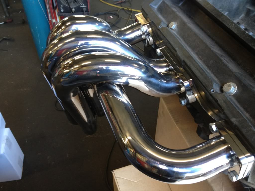

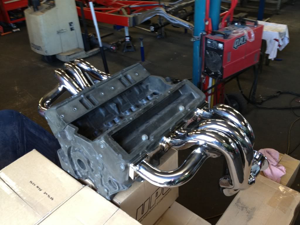

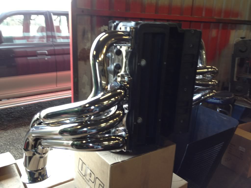

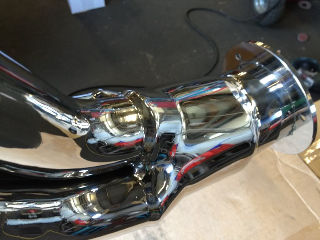

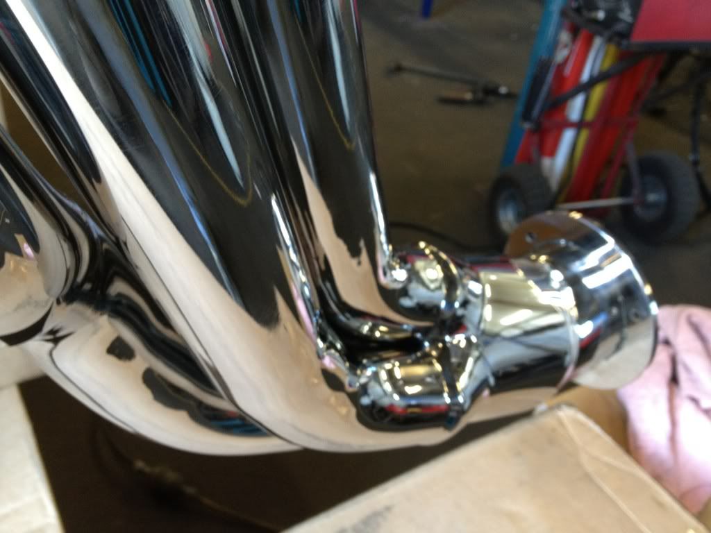

Hey guys, Micks brakes turned up today, look great, I will upload some pics tomorrow, in the mean time, heres a few pics (even though there for a eh with small block) of some stainless headers i have been working on, may inspire Mick to use something similar.

:shock: Nice headers

[quote="undadathum"]Hey guys, Micks brakes turned up today, look great, I will upload some pics tomorrow, in the mean time, heres a few pics (even though there for a eh with small block) of some stainless headers i have been working on, may inspire Mick to use something similar.
mmmmmmmmmm.........I am definitely inspired!! :D :D :D
