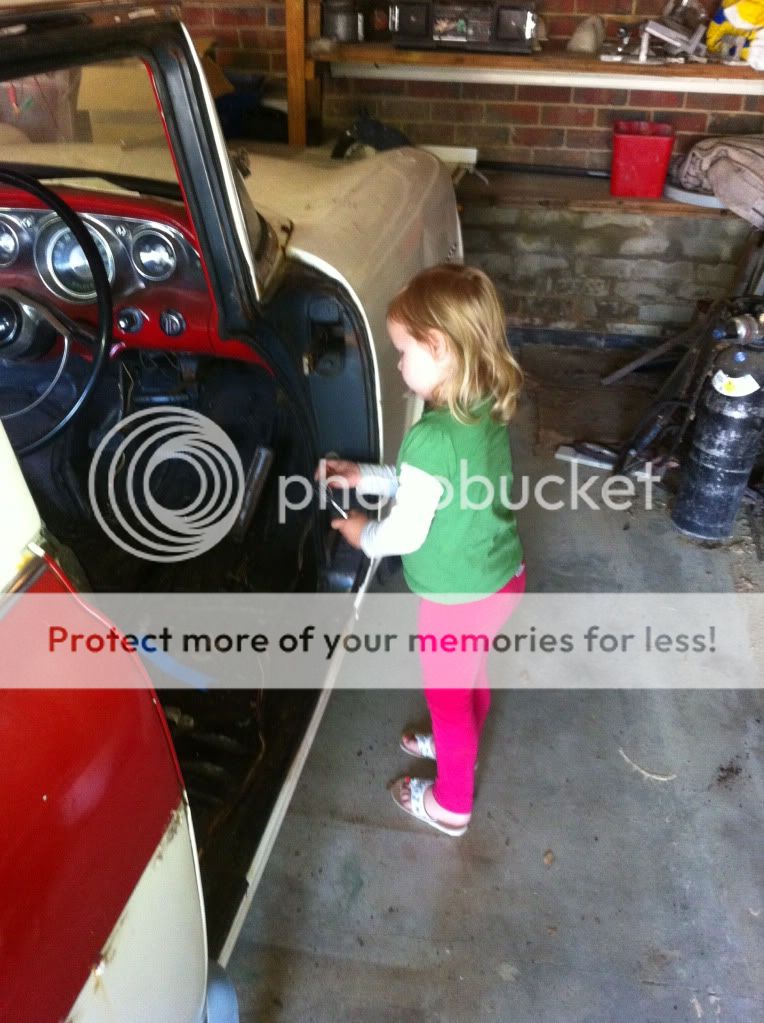

Followed your advice Blacky and it was as you said it was, a piece of cake. However for the two back doors its a little different. I could remove the doors by unscrewing the three Phillips head screws or there are three hard to get to 1/2" bolts. Which ones should i go for? I also managed to get the bonnet off.
This is my niece helping me out.

Mick, Just done this to mine. The rears I took from the 1/2 inch bolts, Theory being that they should bolt back on without to much mucking around aligning them.
