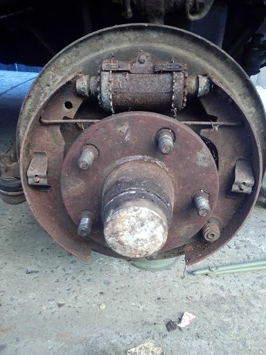

Harv wrote: Tue Jan 19, 2021 3:07 pm A word of caution on those rubber blanking plugs. I fitted some to the FB, and all looked good. At some stage though they caught on the adjuster cap, and canted it. The cap canted the shoe, and all hell broke loose. Squealing, and worn lining. I had a good discussion with Burt Bros about it, and they reckon the aftermarket plugs are deeper than the originals. I can't be sure - I've never seen an original. Worth a good check though once they are in.
Thanks Harv :thumbsup: :thumbsup: :thumbsup: ...
here's how the plugs look with the drum off
plug 1.jpg (61.85 KiB) Viewed 840 times
the backing is 5mm so I halved it
plug 2.jpg (53.66 KiB) Viewed 840 times
plug 3.jpg (56.52 KiB) Viewed 840 times
Patrick
Posts: 11642
Re: Gimme 5 years
That's the way paddy. Originally they would've been metal clips which are no doubt shallower. I've got the clips on my front brakes. Nothing on rears but I will have to get on to that.

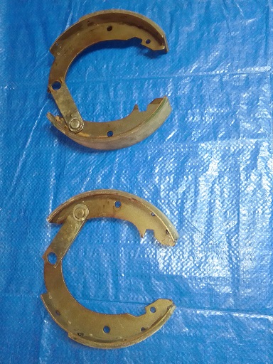

passenger side front brake shoes are near new (although the trailing shoe lining is debonding)
driver's side nothing
Front Brakes 1.jpg (96.26 KiB) Viewed 809 times
I'll get the originals re-lined; but, I've got these ready to go in anyway
Front Brakes 2.jpg (110.59 KiB) Viewed 809 times

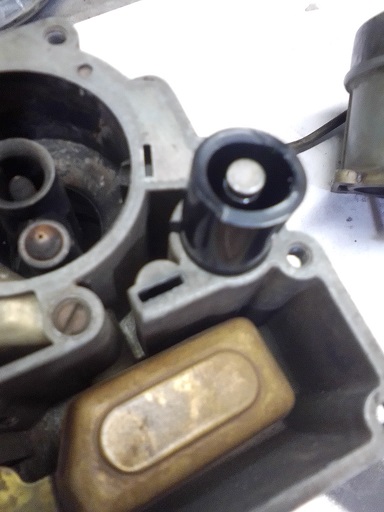

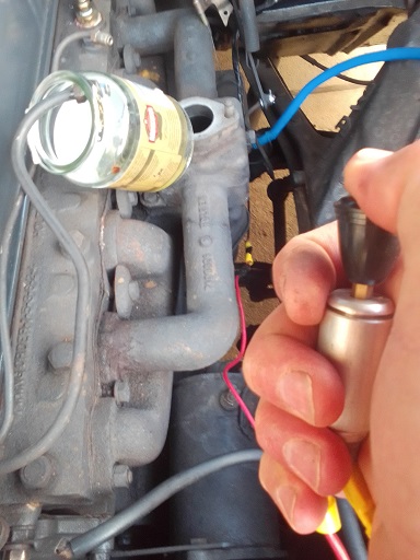

the heat and then the rain has kept me away from the EK for a bit ... today I thought I'd start it up and have a bit more of a listen.
I noticed a flat spot if I blip the accelerator so had a bit of a look ... the accelerator pump was just dribbling instead of squirting. I took the top off the carby and could see a water bubble in the rectangular hole above where petrol is supposed to squirt out. I tried different ways to blow, suck and pump it through but in the end poured some metho in to get rid of it
hopefully it's just a one off - I thought I better check if I got some in the tank so I made up a remote starter and pumped some petrol into a jar - all good.
remote starter.jpg (77.89 KiB) Viewed 721 times
also decided to put a fuel filter in
fuel filter.jpg (85.06 KiB) Viewed 721 times

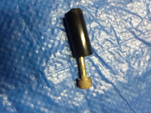

considering I'd been squirting carby cleaner in and using metho, I decided to go back to a leather plunger seal - I had a good one in a spare carby...though I assume they make the new ones out of something durable anyway
I don't have tool 6A20 but I do have poly pipe
accelerator pump 1.jpg (91.38 KiB) Viewed 721 times
accelerator pump 2.jpg (56.96 KiB) Viewed 721 times

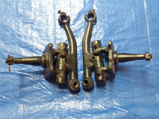

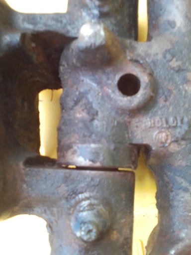

The weather is a bit better today so I made a start on the front end
got out the book - it said to get a feeler gauge and measure this gap - max 4 thou
only 76 thou over
king pin 1.jpg (55.46 KiB) Viewed 685 times
I've got these to go in
king pin 2.jpg (114.79 KiB) Viewed 685 times
Patrick
Posts: 2274
Re: Gimme 5 years
Hmmm.... close but nah, thrust bearing probably collapsed.
Posts: 2523
Re: Gimme 5 years
Hi Patrick, I tried those Rares reco units too and found that the inner and outer wheel bearing mounts had been machined too much by Rares and the bearings were not a snug fit. There's ways around it, but in my case I decided to put kits through my old ones instead. If you go down that track, reamer is here if you want to borrow it. Brett
ardiesse
Posts: 1204
Re: Gimme 5 years
Post by ardiesse »
The king pin retaining cotter pin is missing on all three (yours with the excess clearance, and the two reconditioned ones).
