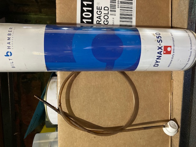

Product recommendation.
This stuff it’s a cavity wax. Smells like a sheering Shed so could be lanolin based
The long tube with it is great.
Drilling small holes or through the small seam gaps and feed the tube in. Has a spray on the end.
Done my sills, in behind where the rear 1/4 meets the sills and k frame.
Blackdog

Posts: 2523
Re: Project 2.
Thanks for posting that info Blackdog. I have used a couple of brands of cavity wax on Wilma and agree those long nozzles are great.
