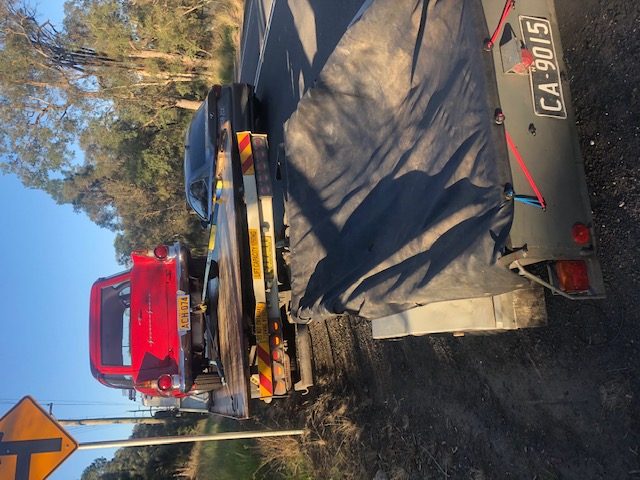

I thought the tuner was mad to question the MSD Ready to Run dizzy. Kept driving the car, ready for the tune-up tomorrow. Put the trailer on, and drove out to Windsor to pick up the leftover parts from Grace's ute's smash repairs. Got out to Londonderry, and put my boot into it coming out of a roundabout. Sluggish, and I started to smell magic smoke. Magic smoke went away, but one minute later I lost all ignition. Popped the exhaust and rolled to a halt. No starty.
Back of nowhere... I could hear banjos :lol: . Wagon got it's first tilt-tray ride home. With COVID in play, you can't ride in the tilt-tray cab, so a wait for a separate cab ride home.
tilt tray.jpg (118.74 KiB) Viewed 1096 times
Quick check last night shows 12V to the coil, no spark. Dizzy has failed, probably cooked a module. If you hear loud swearing from over in WA, it's only me getting the dizzy out.
