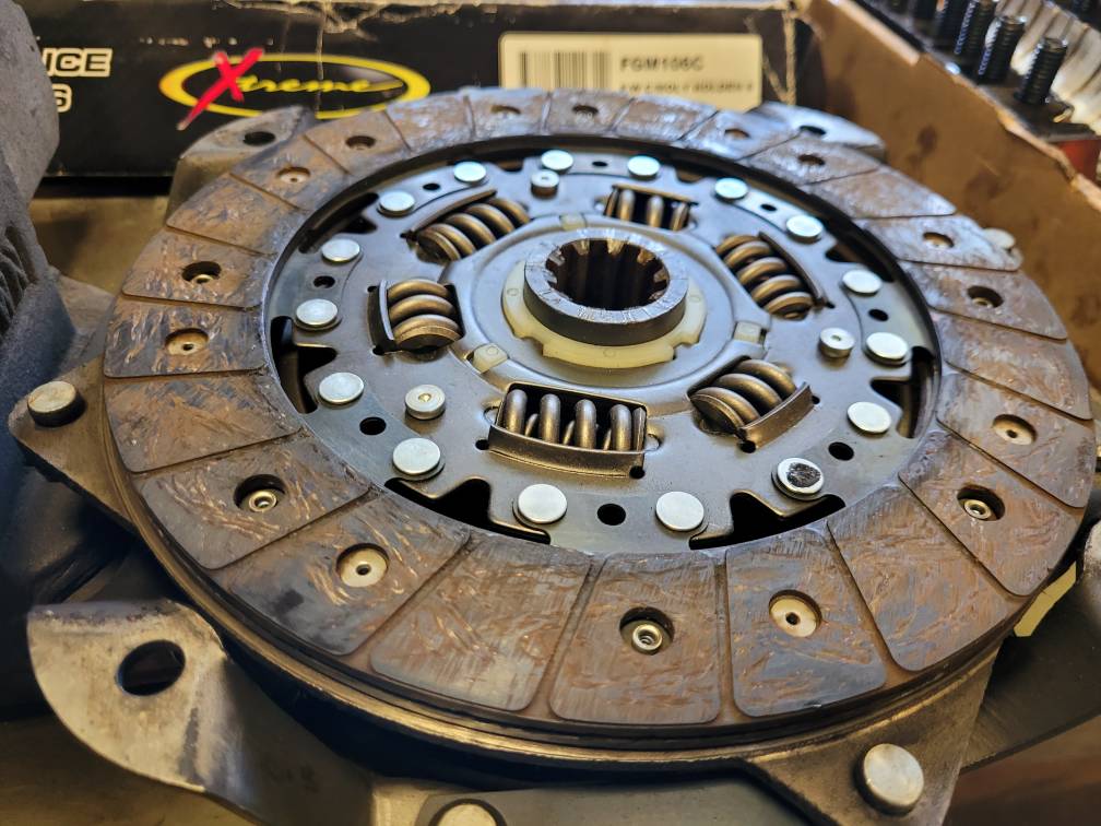

Mate Tim got me motivated. We were going to Dudley's last day, but decided to pull the motor.ImageHapply crank main journals and cam bearings look good.ImageThe rear main cap shell has a line in it.ImageI will replace all but the cam bearings seeing as I've got it apart. I'll replace the driven plate too. It is more eorn than I expected.
