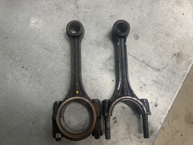

On another topic I keep being told the J conrods are stronger than the earlier models, but I have compared J to B and can not see any difference.
Photo below, J on left B on right

AFAIK, the rods are the same. There were rod changes early on, when the little-ends went from forced to splash lube (later rods are not gun drilled from the big end bearing up through the H-beam to the little end). No change for EJ that I am aware of.
Could be that old Holden furphy - the later rods have 10 years less work or corrosion on them
Re: FB Standard Wagon
The conrod nut was revised for the EJ. It is smaller across the flats and taller than the earlier conrod nuts, and the stamped locknut was deleted.

Cheers Harv, yes well it had me stumped as I could not see any difference so it all good!
Rob that is interesting about the con rod nuts, I had different examples of the nuts A/F being 1/2 & 9/16.
The 9/16 nut is thinner than the 1/2, I actually chose to use the 9/16 as I thought more contact on the face would be better but now you actually mention it I might just switch back to the 1/2 taller nuts.

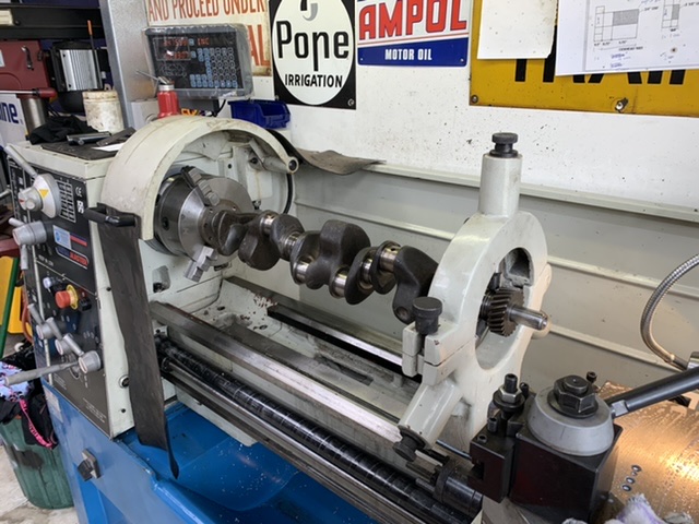

Got the crank in the lathe this morning.
3/8 UNF drill and tap in the snout and a polish of the snout diameter for a less aggressive fit to the Ross balancer.
Snout is a full .001” bigger than the balancer hole
I’ll polish it down a hair to about .0007
- 222FF7A1-FDBD-484D-9D3E-AF1418AAD4B0.jpeg (128.73 KiB) Viewed 665 times

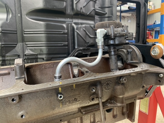

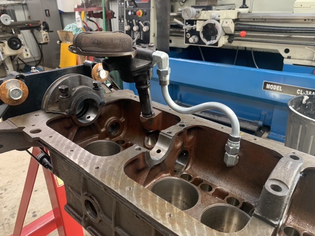

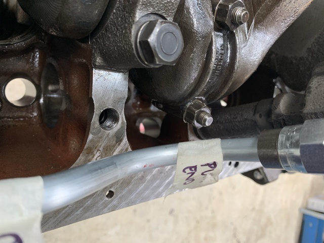

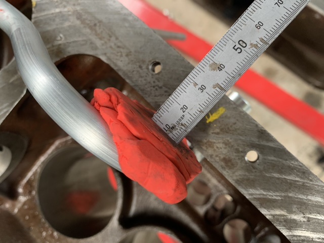

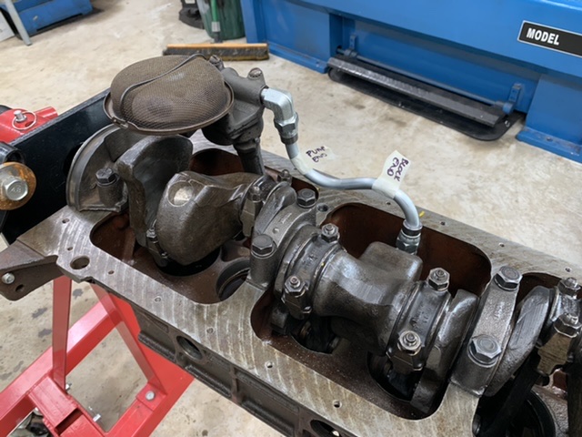

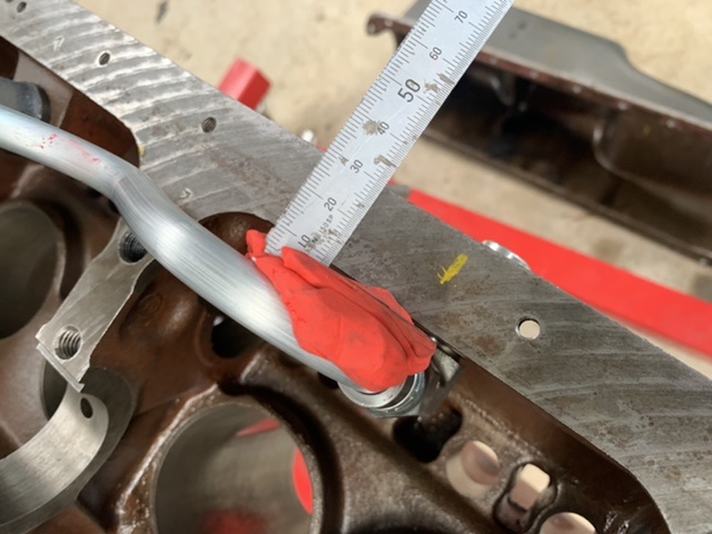

Spent the week playing with the bottom end the get the full flow oil pipes set up.
Happy with the result.
Good clearance everywhere, just need to braze the pipes into the fittings… oxy acetelyne would be handy right now!
- 8FF3BBEA-3818-402A-9A91-B66419B7ED6A.jpeg (122.99 KiB) Viewed 627 times
- 95E4527E-C17A-40A5-ACC4-C1AA41242331.jpeg (122.56 KiB) Viewed 627 times
- FB4478AF-7422-4694-999A-EE539236E201.jpeg (121.83 KiB) Viewed 627 times
- 283292EC-B5E8-4998-B643-5C0BB24F0C5B.jpeg (89.16 KiB) Viewed 627 times
- 428FAA5B-9DD8-4C69-8A54-725D002E7DAF.jpeg (93.79 KiB) Viewed 627 times
- 8DF88B4A-67EF-4E2A-B2D5-35DA4D733550.jpeg (103.65 KiB) Viewed 627 times
- A257FA13-4B63-4B18-8948-74A6DE006D01.jpeg (122.35 KiB) Viewed 627 times
- 64F00080-0E1F-4C45-A407-865863D41328.jpeg (123.15 KiB) Viewed 627 times

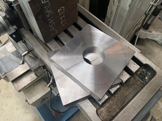

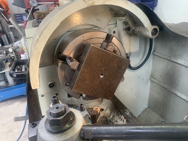

On the machines again making something I don’t want to pay for…
Any guesses?
Any guesses?
- 2D47293A-8757-45ED-B0CA-EC6F32EC0DDB.jpeg (118.18 KiB) Viewed 558 times

If that crank is only sitting there to dummy up the oil system, it could be a rear-main seating tool.
If you ever want dimensions (or to borrow a service tool) give me a yell. I've got a pretty fair stash.

Cheers Harv, yes mate I’ll give you a shout if I need those tools but no cigar for you my friend…
Not a rear main seal seating tool!
