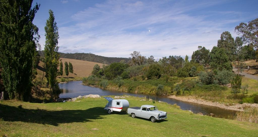

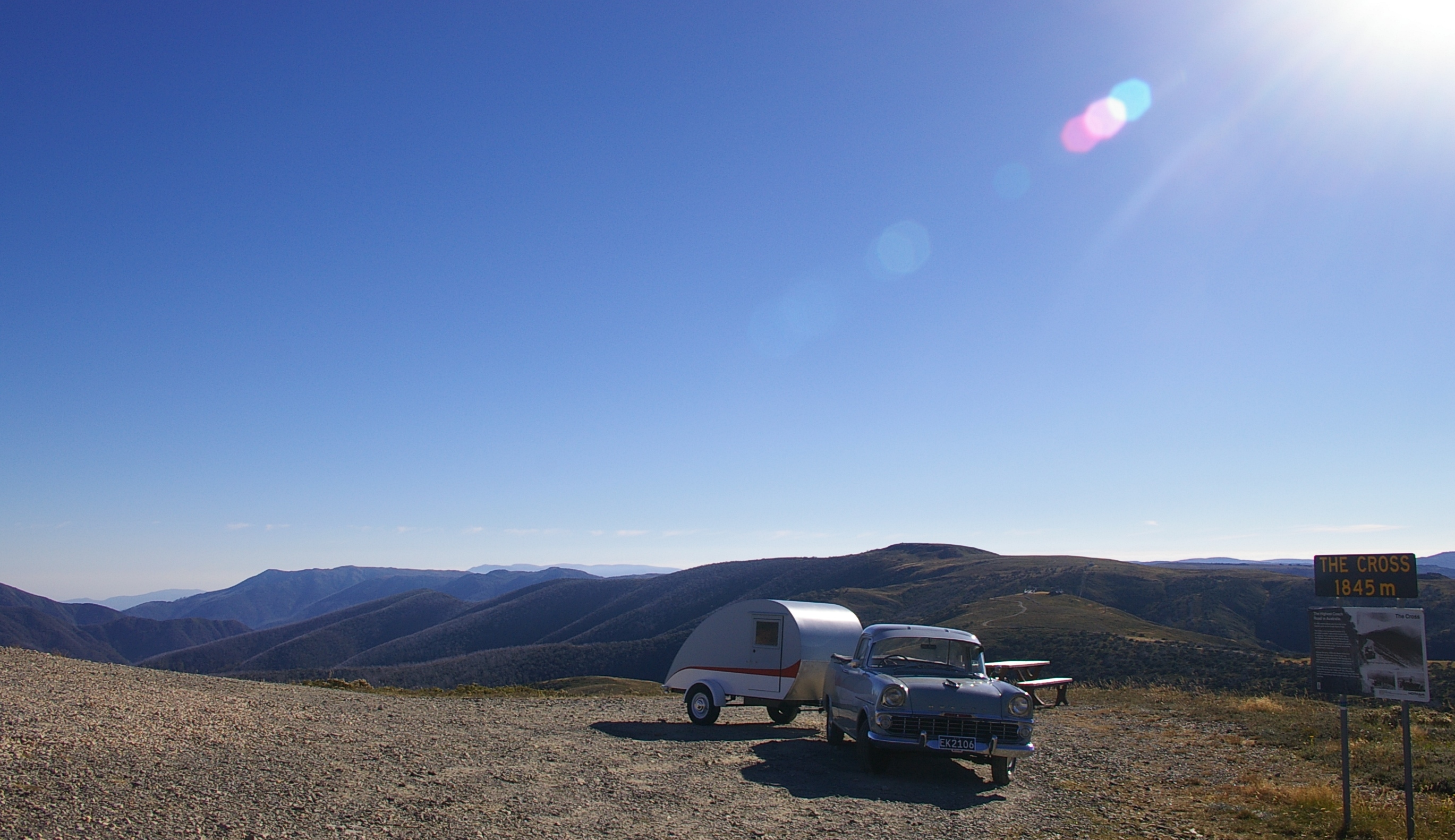

Ok, a good win the other day. Finally got a reply from Rares over the rubber. They did a full refund including the freight and didn't want to see the rubber. They were also great about discussing the issues with the rubber and rectifying the problems. From intial thoughts they think it was a batch run problem so hopefully it shouldn't happen again later on.
This week we finally did a shakeout run with the camper prior to the Nats. All went well especially with the climb to Mt Hotham. It was a good work out for the old bus and after this the WA should be a walk in the park......................touch wood.
- IMGP7724.JPG (1.42 MiB) Viewed 1079 times
Re: Seagull Grey EK 2106
Well done Craig, love that colour combo, we had a Gilflite ski boat except white over grey with a red stripe. Wish I was coming, getting more jealous about a long trip each day.
Hi Craig,
Nice one. Would love to see some more pics of your van set up.
That’s gonna be the coolest rig on the Nullarbor, Craig. Well done.
