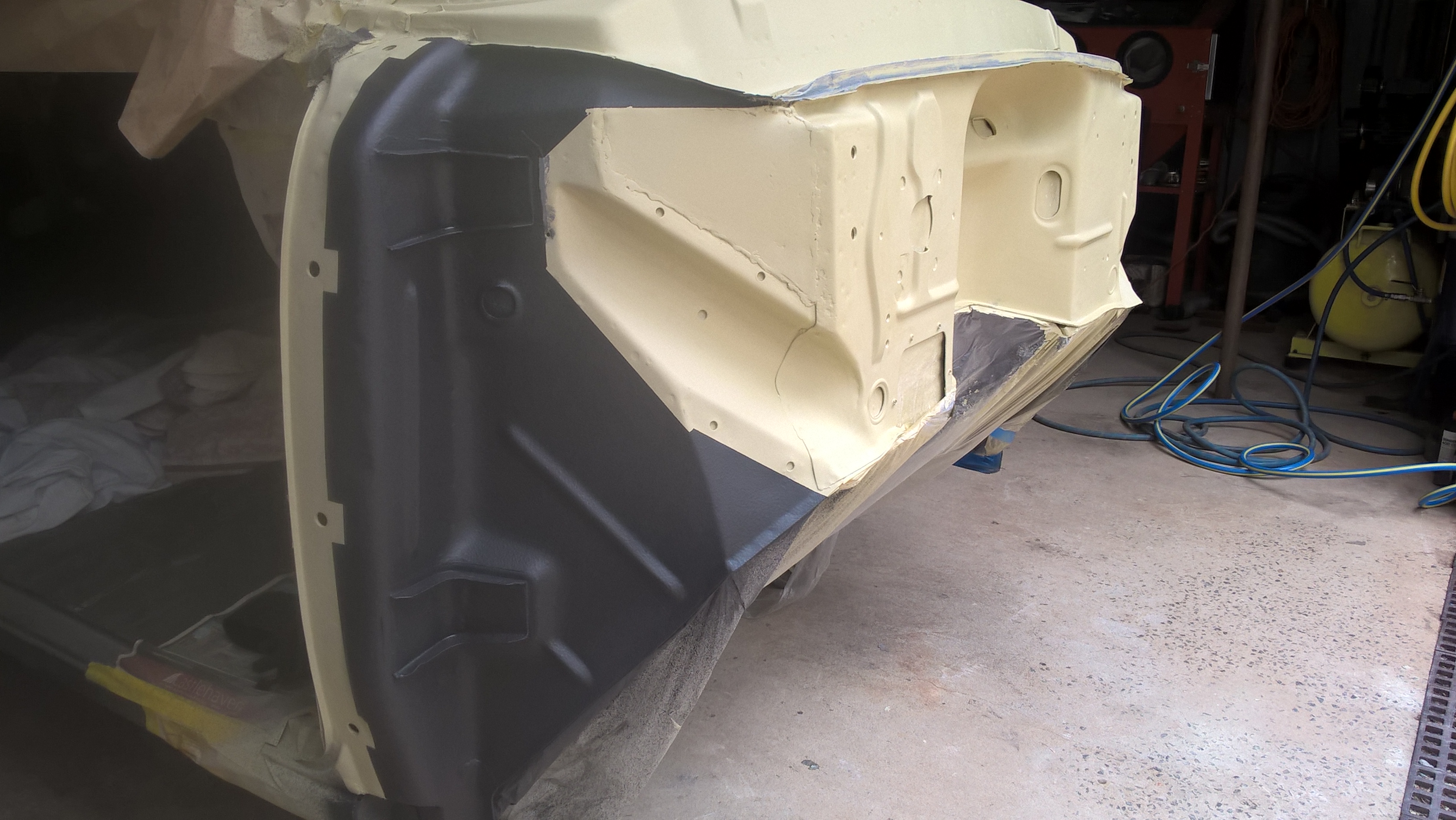

Couldn't paint today cause it was raining on and off and I couldn't take the car out because I bared the firewall ! Its just great to strip back the old paint and have no rust or modifications :yeahhh: :yeahhh: :yeahhh:

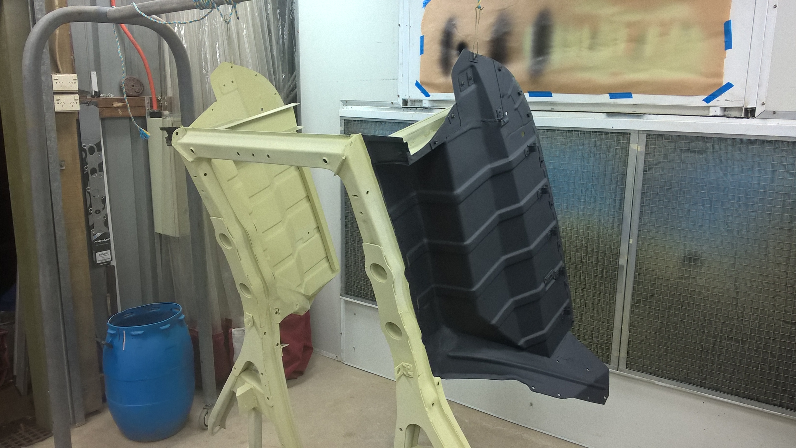

Instead I tidied up the weld marks on the sub frame where I modified the inner guards to suit the rail trim.

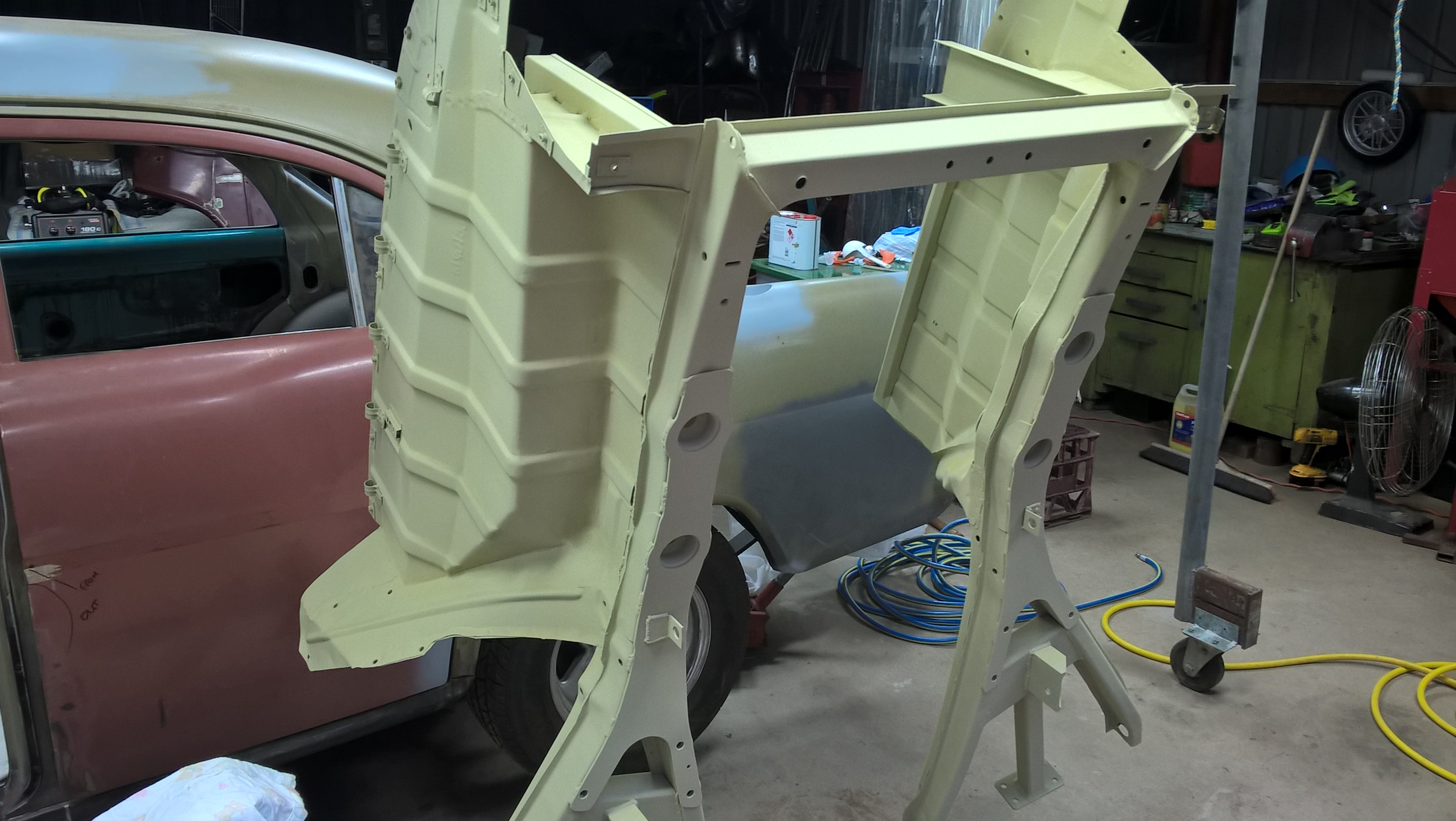

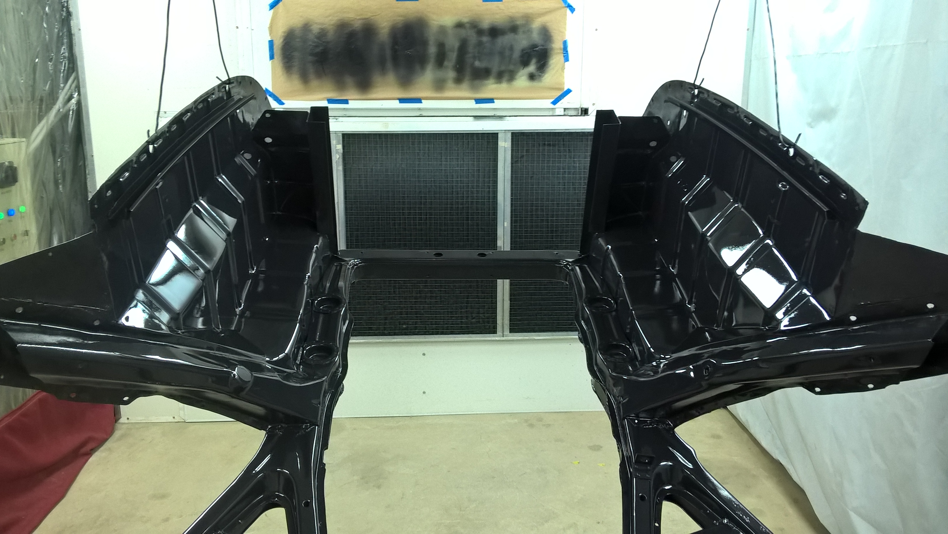

A bit more today, chipping away.
Subframe in hifill and firewall epoxied.
Posts: 2582
Re: Chev EK
Hot today here in Sydney, Soldier on just look out for the sweat !!!!

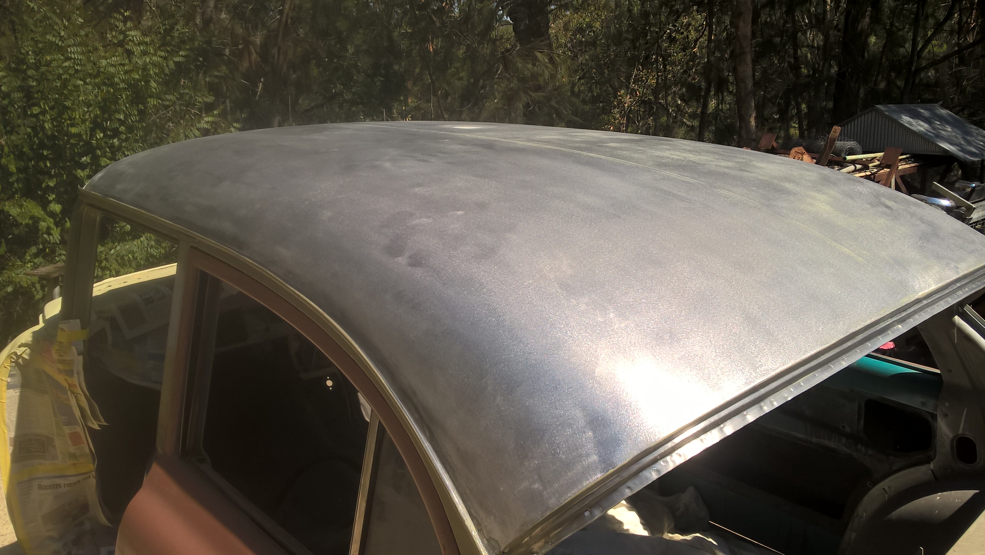

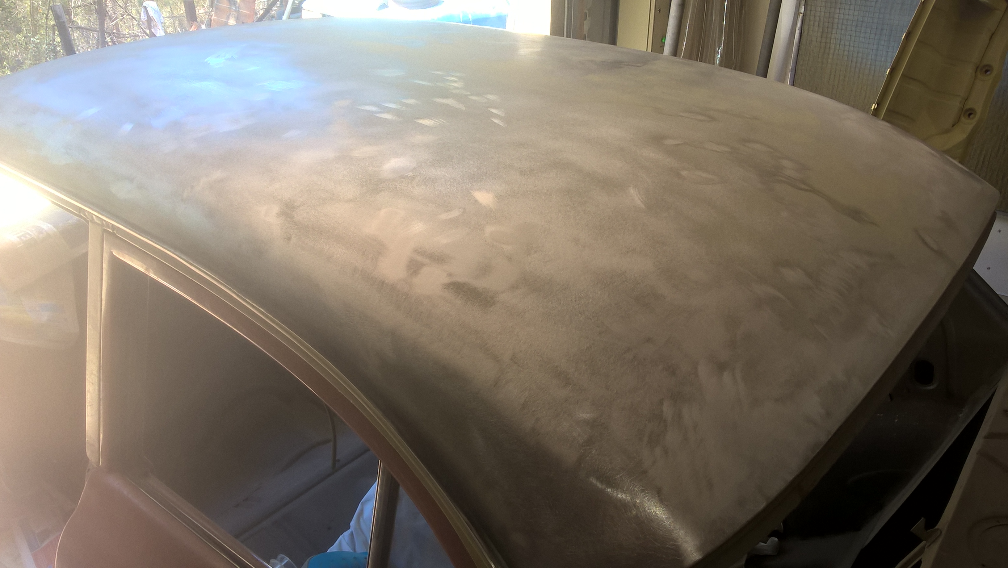

Started the roof today, and noticed a few rust spots starting so once again back to bare metal.
If you look close surface rust under the 11 year old epoxy but worse under the repair primer.
Wizzed once then de oxidine then whizzed again with 80 gritt,
Epoxied and primed in hifill wet on wet.
The firewall is now on its last rub and some colour WHHHATTTTTT ! about bloody time.

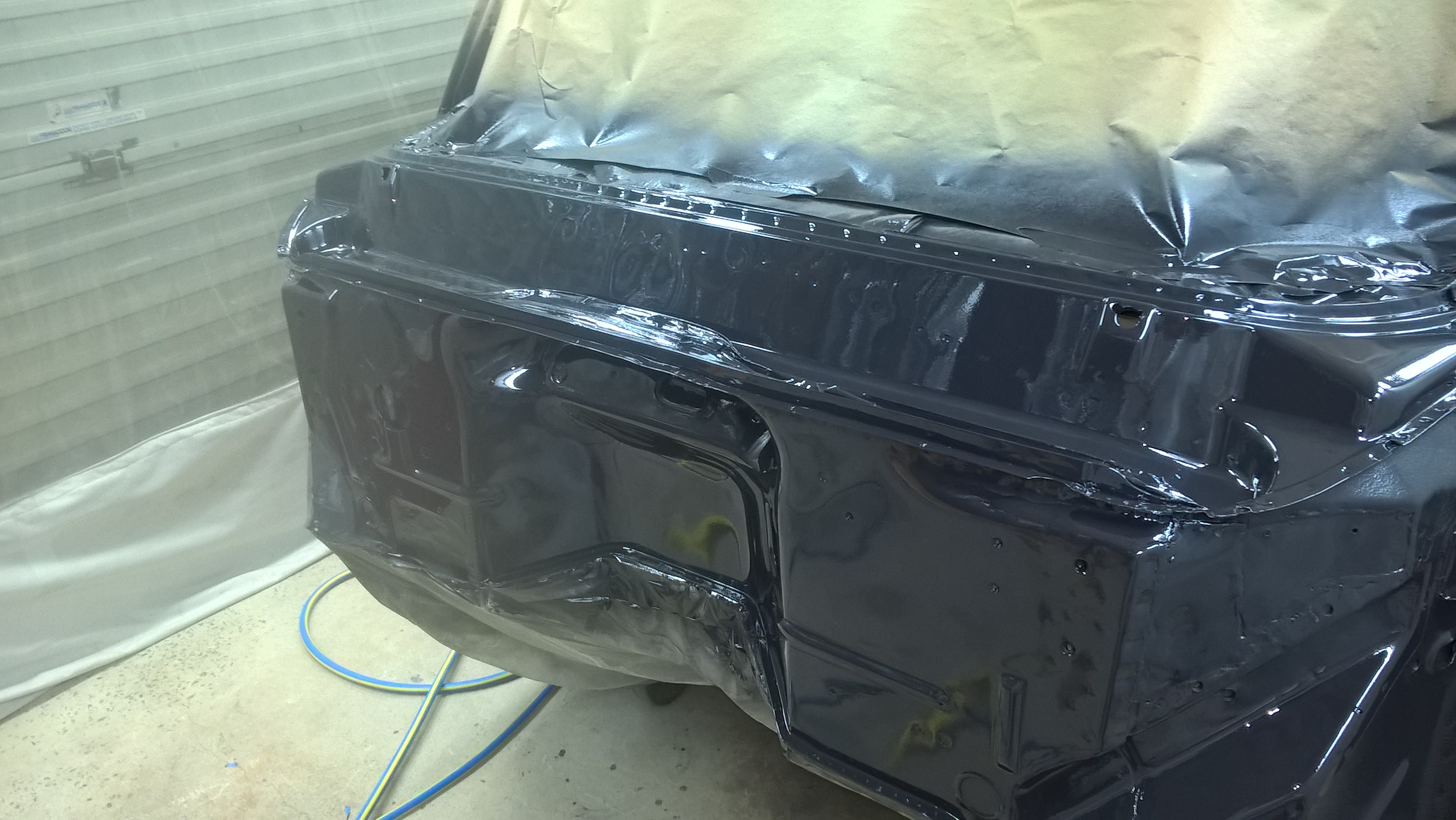

Got up early today cause I could hear the car calling me !!!
Seam sealed, stone guarded then applied some clinker grey 2 pack.
Blew myself away, it turned out better than I imagined, although a couple of dust specs from either the gun or from the masked areas.
My fingers are hurting from all the prepwork so thats it for today, hopefully more over the weekend !

The sub frame has been a royal pain to get straight around the modifications I have done and I have resisted the temptation to paint until its right and that was today ! Unfortunately I got too excited and of course have a few runs complimenting my eagerness !!!!
Oh well more sanding and try again !

Nope nope not good enough !!!
So I rub down and scuff for two days and have another crack :evilll: :evilll:
Now thats what Im talking about !!! success at last beautiful clinka grey in 2 pack !!!!
