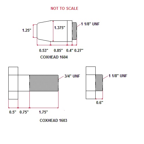

I bought a harmonic balancer puller from Rare Spares. It wasn't that expensive - certainly less than $100.
Now you "just" need to make the installing tool. It has just a short length of the larger size thread, and a shoulder the same OD as the hub, so the shoulder bears up against the hub.

Here ya go Drew,
If you decide to make one, the knockerer onera thingo plus the seal alignment tool too 👍

Cheers Harv for the drawing, I must have saved that pic a while ago as it is what I referred to when making the puller.
