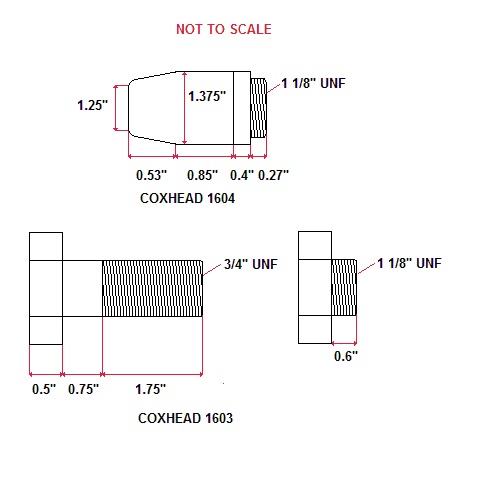

I bought a harmonic balancer puller from Rare Spares. It wasn't that expensive - certainly less than $100.
Now you "just" need to make the installing tool. It has just a short length of the larger size thread, and a shoulder the same OD as the hub, so the shoulder bears up against the hub.

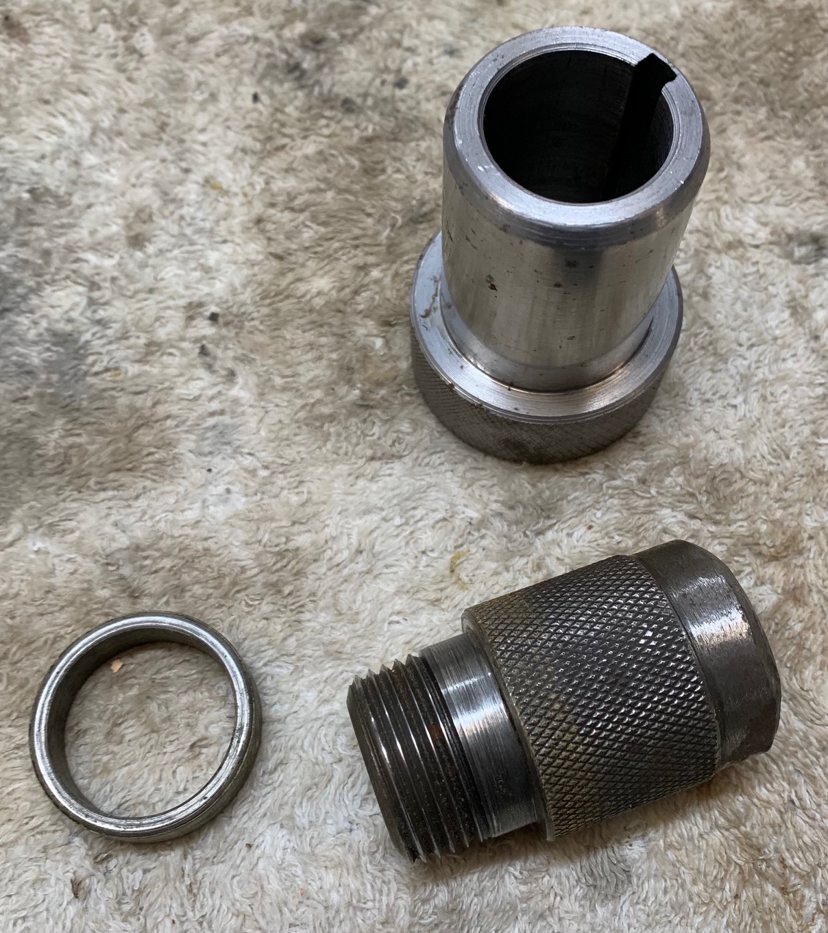

Cheers Harv for the drawing, I must have saved that pic a while ago as it is what I referred to when making the puller.

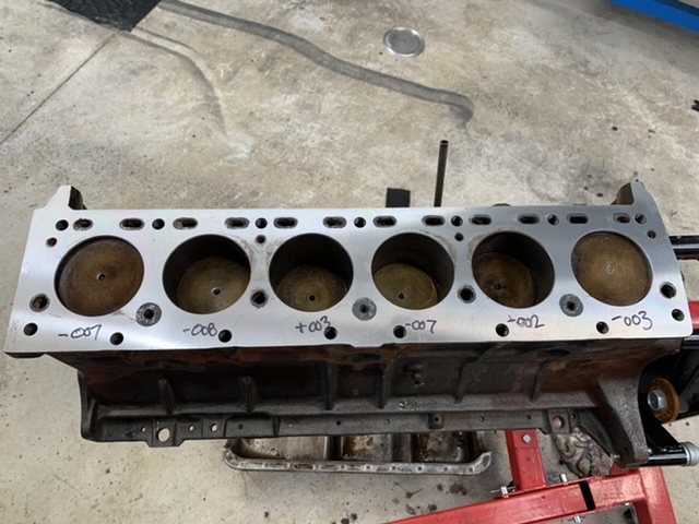

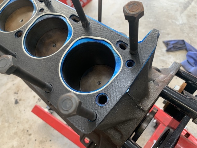

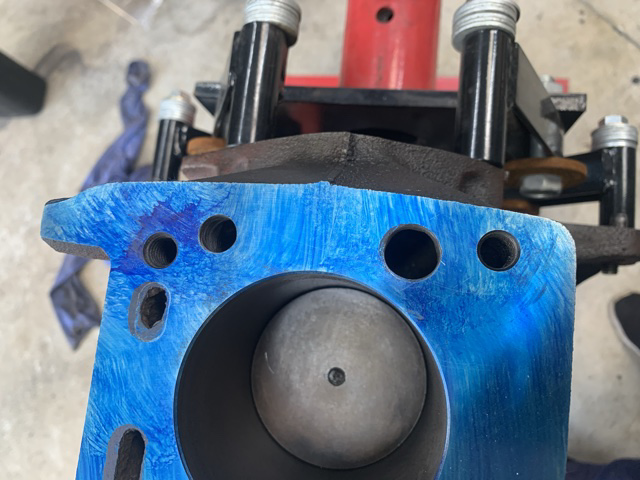

Dummied up the bottom end to check the piston to block deck clearance, just to double check it against my calculations.
I calculated .009 deck height above pistons at TDC, seems it varies a bit but ranges from -.007 to +.003.
All of my rod lengths are the same so I’m guessing there is some thing funky going on with the old pistons to give such a variance in compression height.
I only measured 1 piston for compression height and it was 1.812, from what I can find a factory piston compression height should be 1.820… can anyone confirm/ deny this?
Why would my compression heights vary so much when I dummied up the bottom end with the old pistons?

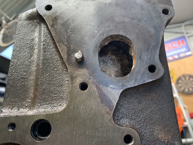

Next up was to drill out a broken bolt for the water pump and I did the mods for the late EJ head gasket.
Drilled out the coolant galleries holes on the back of the engine block so they are bigger.

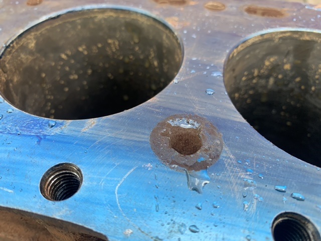

The pressure washer blew a couple of chunks out of the block deck around some of the coolant galleries, that’s why I’d like to get the block decked another .010 just to clean this defect up a bit

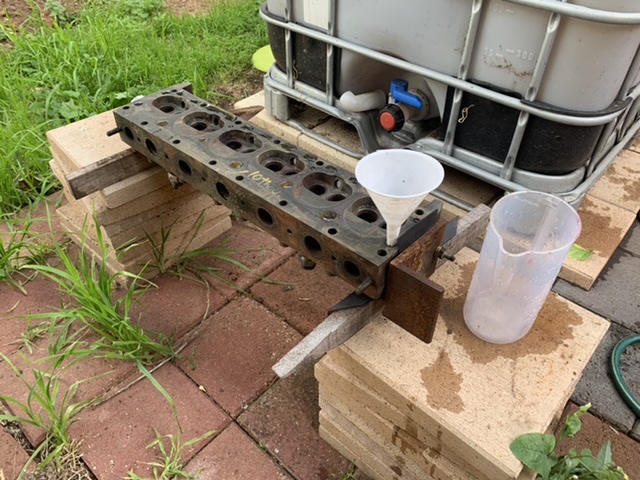

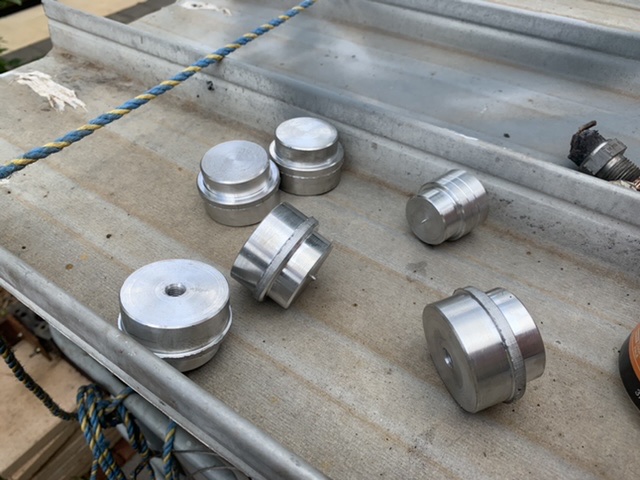

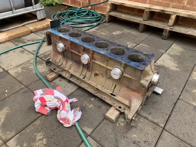

Considering the coolant galleries are so rusty I mixed up some fresh citric acid, turned up some plugs for the block and made some plates to cover the water pump hole and I filled th coolant gallery with citric acid.
I leave it soak for a few days and give it another pressure blast out, if it needs another stab I’ll repeat the process.

Corrosion damage to the block deck around the coolant passages is inevitable. Looks ugly, but doesn't affect sealing at all. I see no reason to machine any more off the block deck.
Piston crown to deck height measurement: if I may suggest . . . the dial indicator's in the wrong place. You would need to measure bang on the cylinder bore centreline, just next to the "countersink" in the piston crown. I reckon that piston-to-bore clearance is getting the better of you. If the pistons can rock in the bores, a measurement at the side of the bore will be inaccurate. Worn big-end bearings will contribute to uncertainty, but not to the extent you're seeing.
Go the citric acid in the water passages by all means, but I find nothing beats a Gerni, and patience.
If you've blued the mating faces of block and head, it'd be worthwhile seeing where the two make contact.

Cheers Rob, I’ll check the piston height closer to center of the piston, good suggestion.
