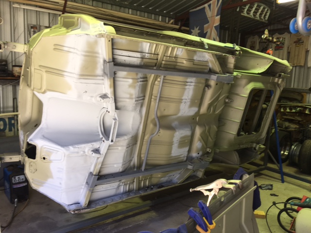

Brett,
I think you may have the no.1 body crossmember repair piece a little too high where it joins the inner sill on the passenger's side. The bottom of the member sits about 1/8" higher than the bottom of the subframe outer leg (reference: "Found Object"), and the floor pan comes to within a couple of millimetres of the upper "step" in the inner sill where the subframe bolts on. So I think the top of the no.1 body crossmember is supposed to be level with or just above the "step".
Posts: 11650
Re: Project 2.
Could be an optical illusion in the photo. I did notice today that said member on my van does appear to run upward toward the centre.
Posts: 2530
Re: Project 2.
Looking at this again now, I'm confident that the crossmember is in the right spot. However I think that the kframe outer leg is sitting too low. The kframe assembly was all bolted up neatly to the firewall and pinned to the other mounts and the outer arm mount pad was positioned to fit the free outer arm which should have been right. But, I'm thinking that while it is in the right spot relative to the outer arm, the outer arm is bent down a bit. This k-frame was one I purchased so may have had a rough life since it was removed from its car 40 years ago. I'll pull it off this morning and check with another k frame. Not the end of the world if I have to slice through it and do it again😅

A bit of progress. These outer sills cause me a lot of grief. The front end tab and closed section never fits properly onto the A pillar outer without surgery and the sill inevitably ends up right on the outer edge of the inner sill bottom at the rear end. It took me about 4 hours of mucking about to get the door and front guard alignment good enough to tack on and in the process the rear quarter is going to require a unique install. None of this matters in reality, but I think I will try adjusting the inner rear half after the outer is set up forward of the B pillar and see if that makes it easier for doing the drivers side.
A photo of a bit of rust work on the way as well. ImageImageImageImageImage
Posts: 11650
Re: Project 2.
It is all progress Brett. I must have been lucky, but I am using repaired original A-pillar bottoms. I did put a lot of work into replicating the original shape and it is noticeably different to yours. The only surgery I require at the front is a few hammer blows and ream out the bolt hole. At the rear I have the same issue you mention at the inner sill bottom but using g-clamps and a bit of cutting of the z bottom of inner sill, easily rectified.
