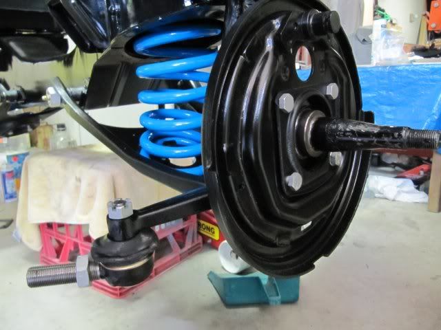

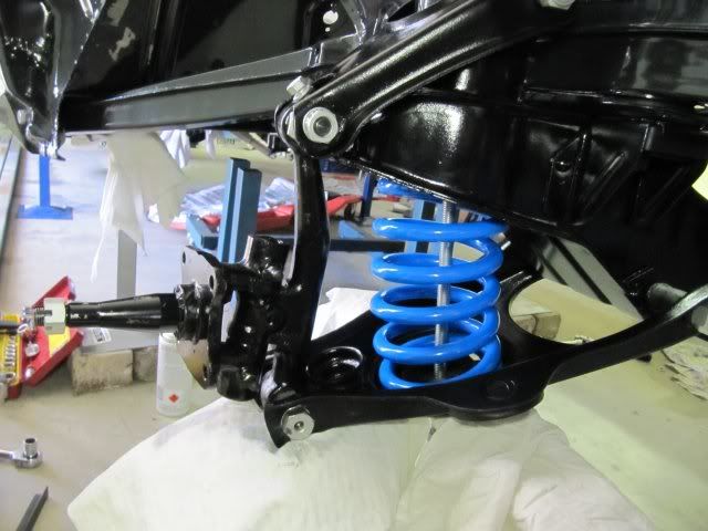

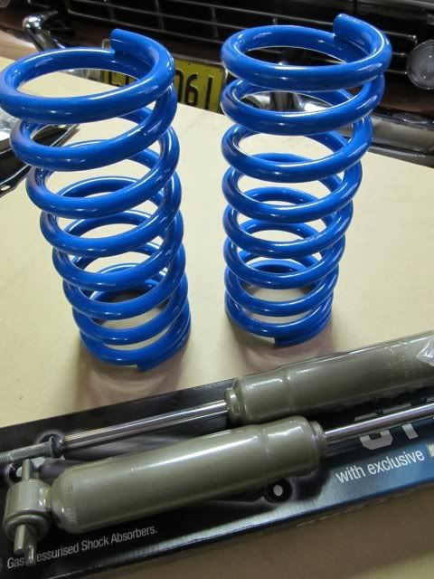

Unpack the Lovells 2" lowered coil springs...I love the look of these...

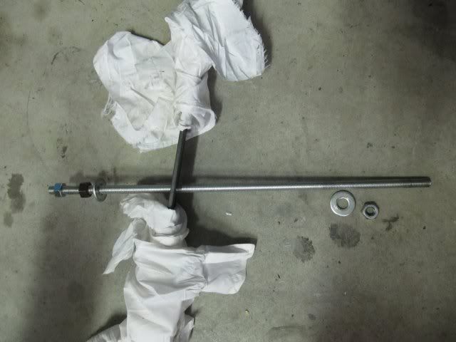

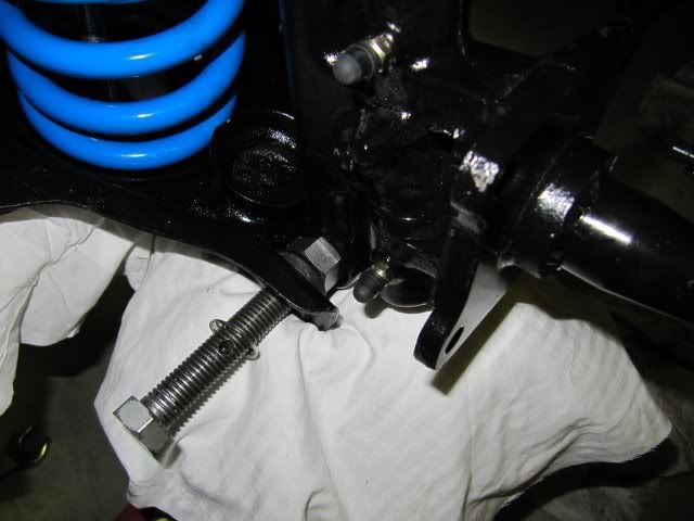

Next was to line up the king pin... First I tested that both the upper and lower pins were a good fit and threaded through easily. With the home made spring compressor and the trolley jack I carefully compressed the spring and lined up all the lower outer king pin holes
Trying to get everything lined up, plus the rubbers seated properly and the king pin centred was painful. It took me a few go's to get it right.

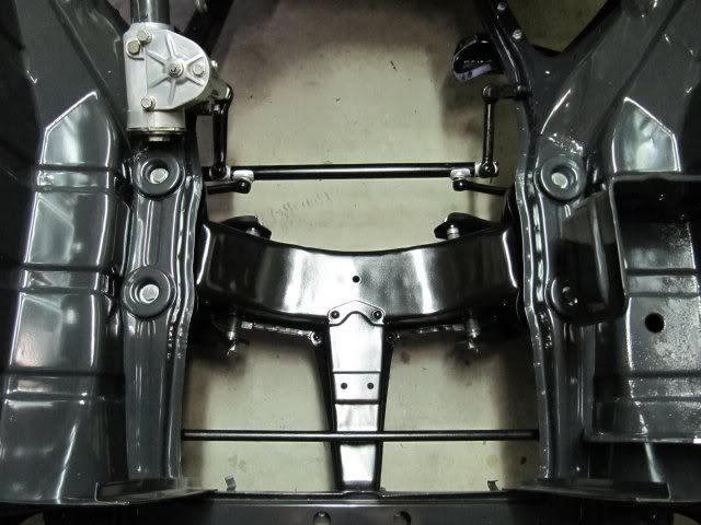

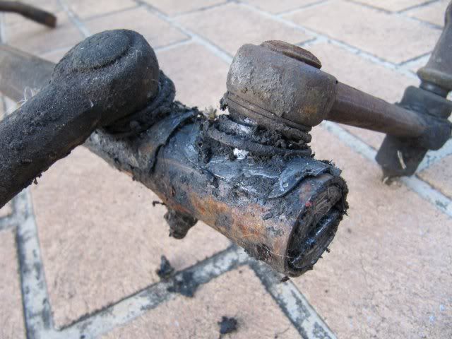

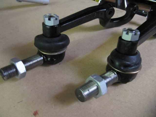

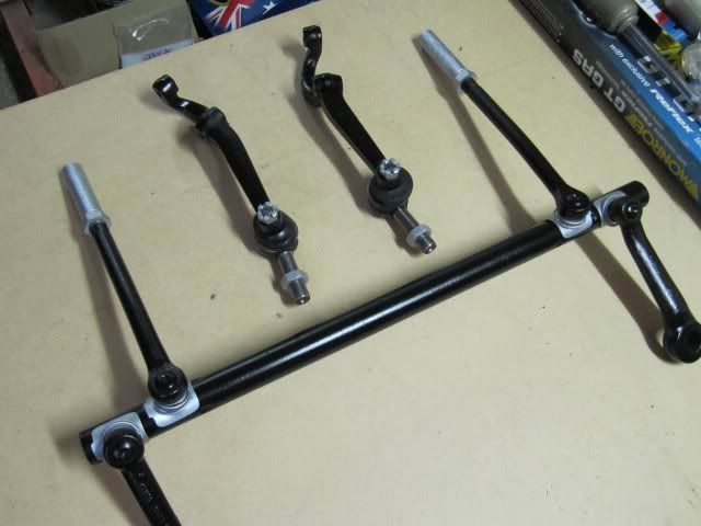

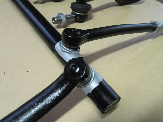

More on the front end...steering and drag links...
Re: Rebuilding of Old Timer (EK wagon)
Some before shots...

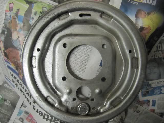

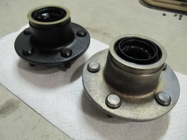

Cleaning, painting front hubs and new bearings.
I'm putting EJ front brakes on to handle those extra horses the hot grey will be pumping out... :lol:

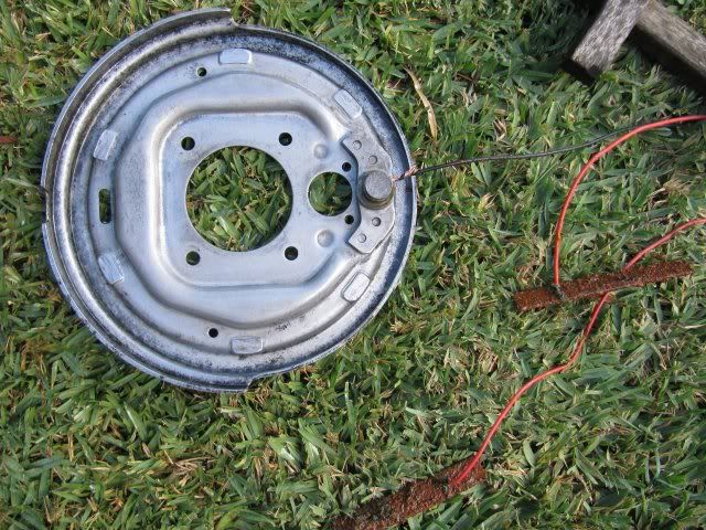

Backing plates before
During
After
Assembly

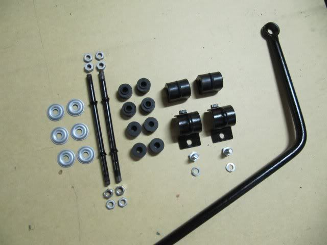

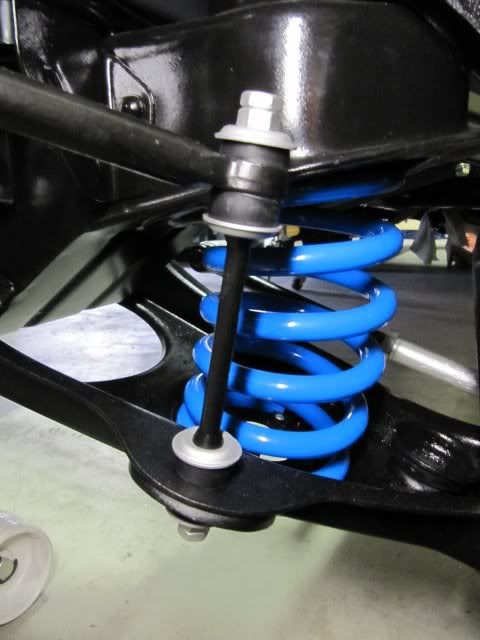

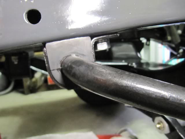

I had some 'fun' installing the front sway bar...http://www.fbekholden.com/forum/viewtop ... 24&t=15040
Got there in the end - thanks for peoples advice.
