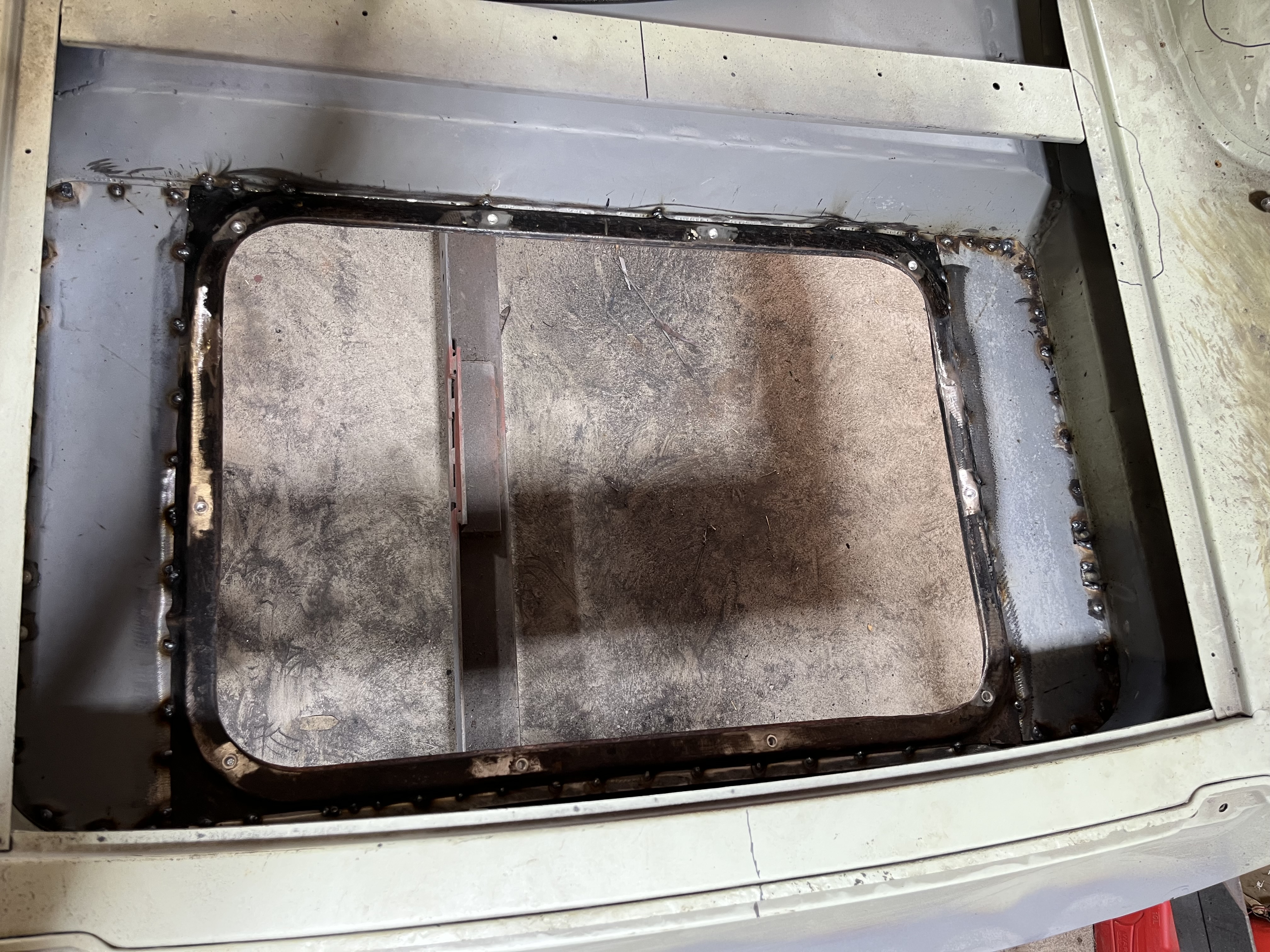

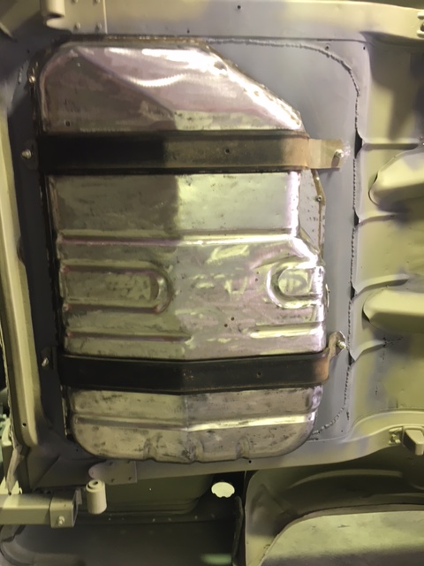

Marked out on my tank where I’m thinking of putting the pump, when I look at Blacky’s tank it looks way bigger :roll: :roll: maybe just an elusion, not going to cut anything out until the pump arrives
Went and finessed the fuel tank surround some more , it’s not welded in yet but I think is a lot cleaner that what I was thinking to do at first.

Looks like it will fit nicely Neil.

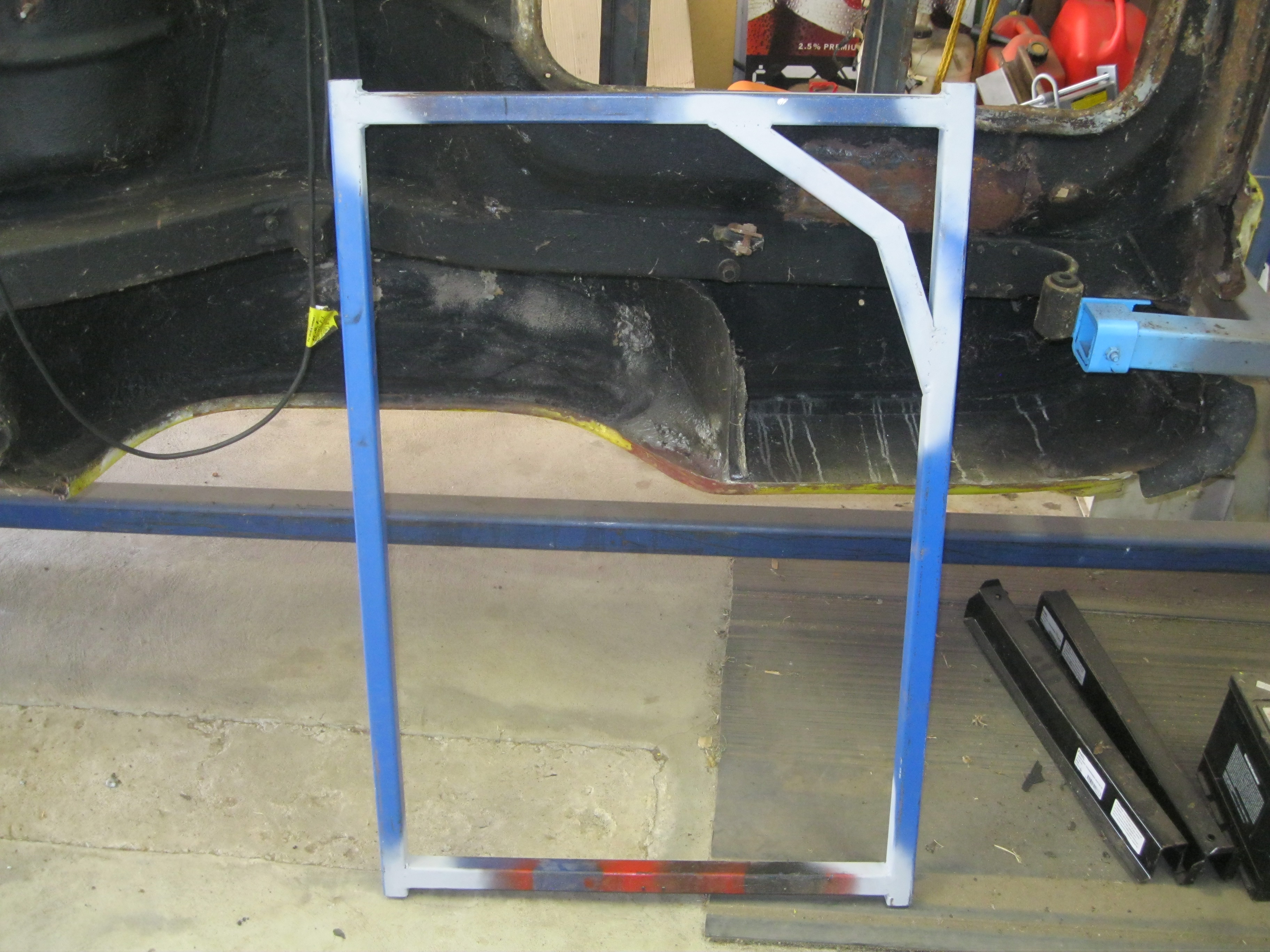

Made a frame like this
cover in the area around it once frame is installed and then the tank fitted looks like this.

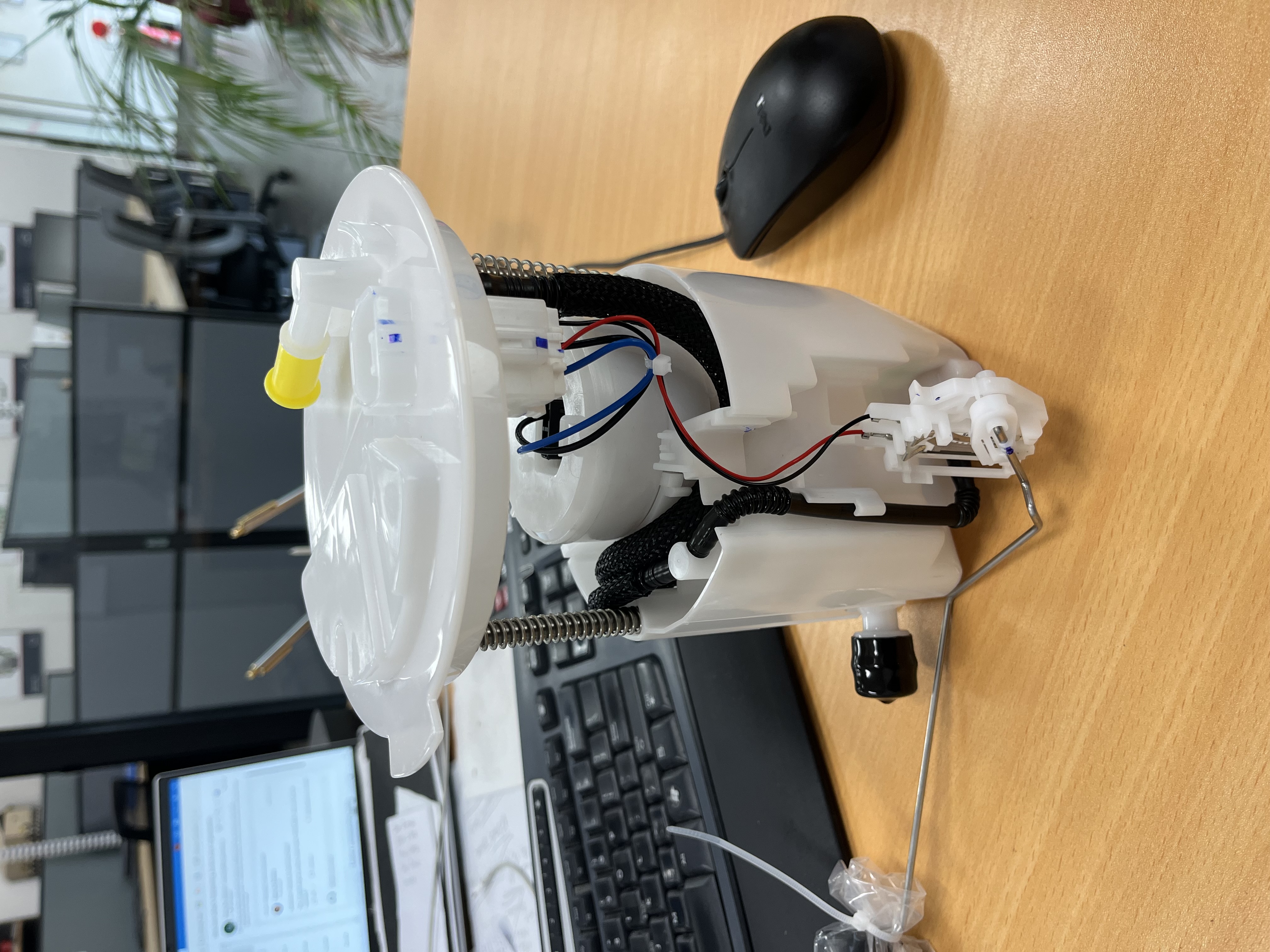

Happy days :clap: :ebiggrin: my fuel pump arrived but it doesn't come with a filter sock which I assume I have to put onto the inlet pipe.

Mr Black solved the filter sock issue apparently the filter is in the bottom of the pump housing, of course Blacky pulled his apart to see how it worked :lol: :lol: :lol: :lol: :lol:

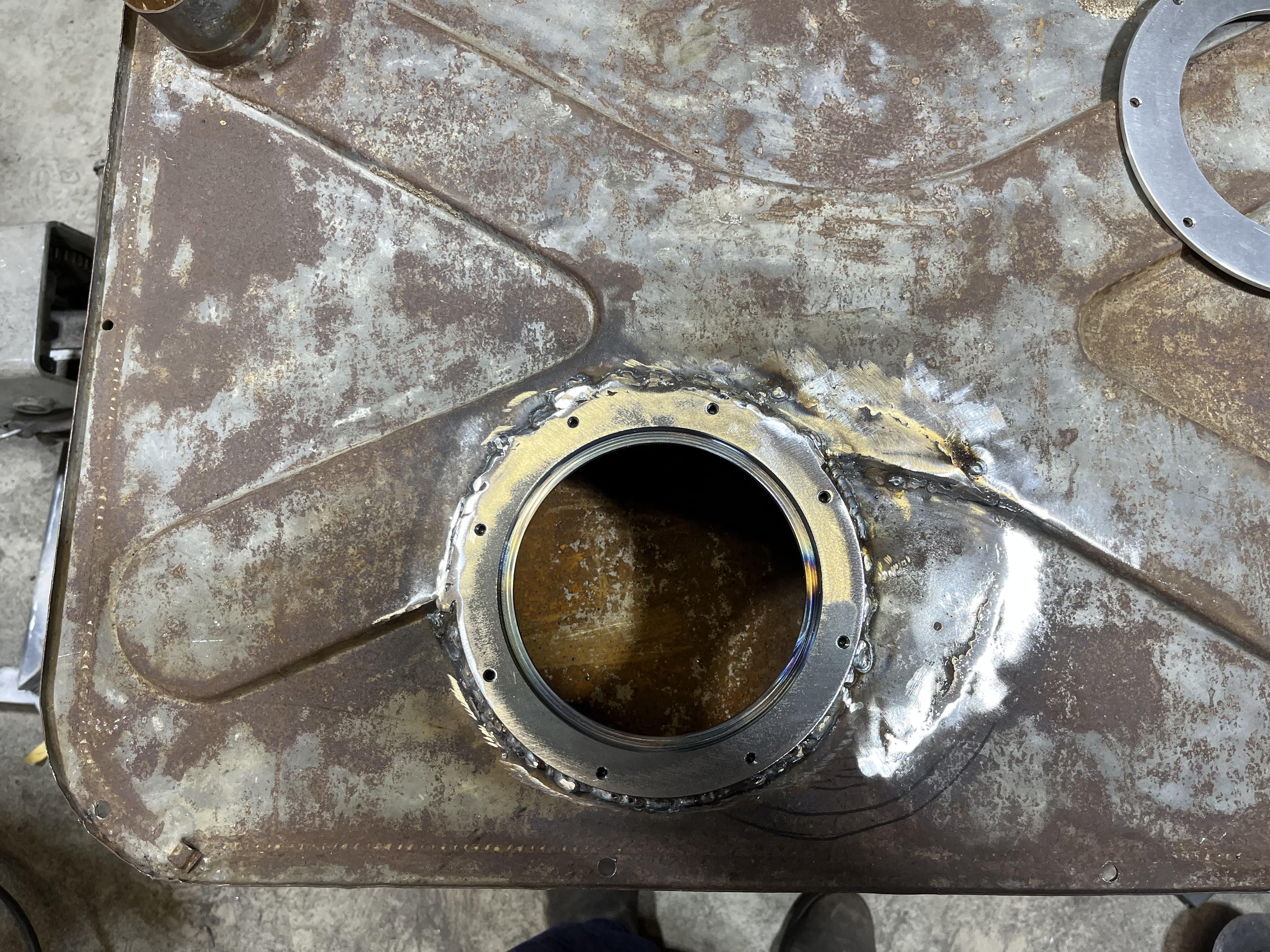

Progress :roll: :roll: two forward one back :lol: :lol:

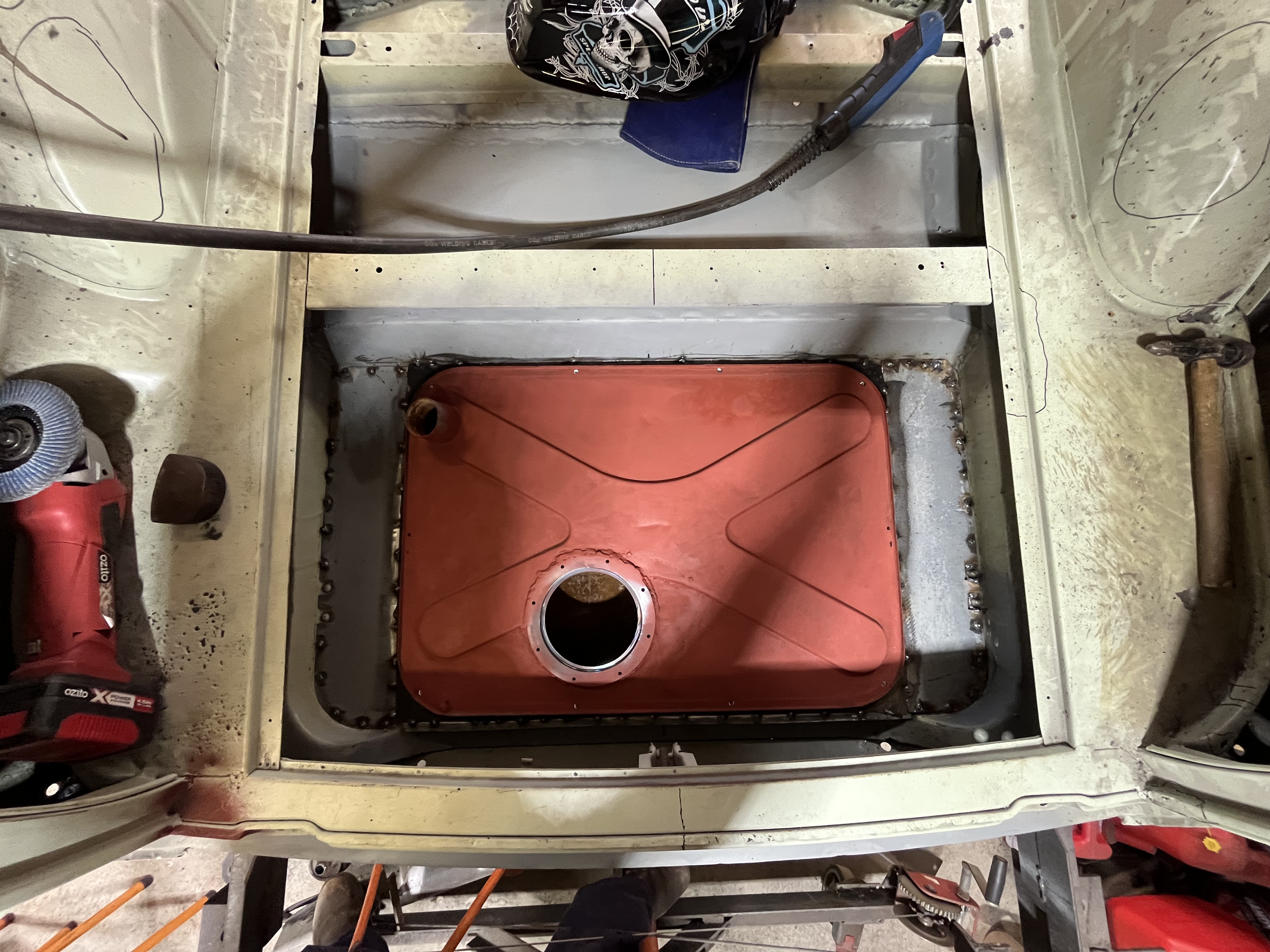

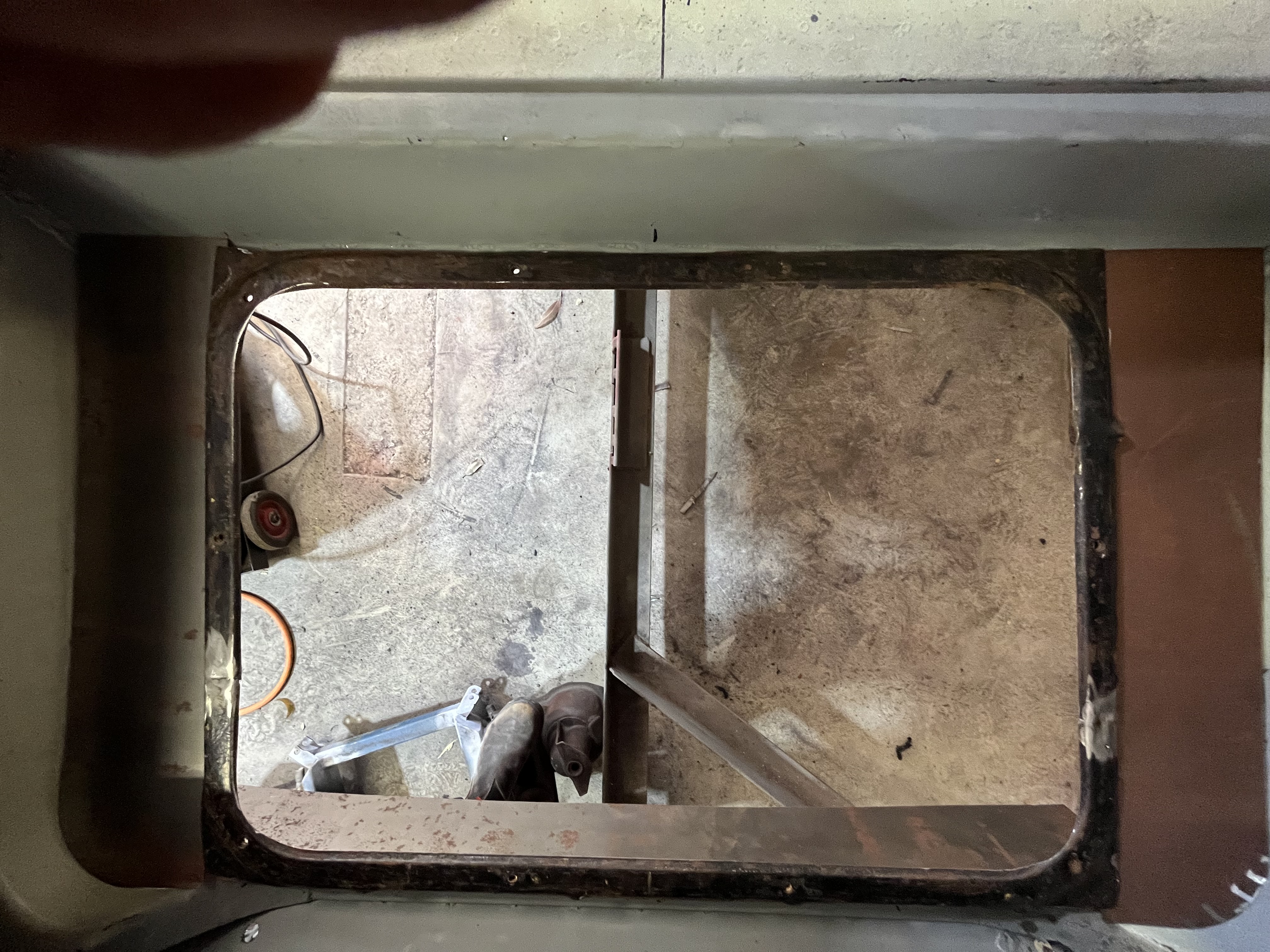

Amateur that I am went to fit the mounting ring for the pump, made my first cut to find that there is a baffle across the tank not w quite in the middle, repair number one to said tank.
Said baffle
Moved across to the side, probably closer to where Blacky has the Rattler tank and fitted the ring
Tacked in the fuel tank surround some
This is how it will look

Looks tidy
