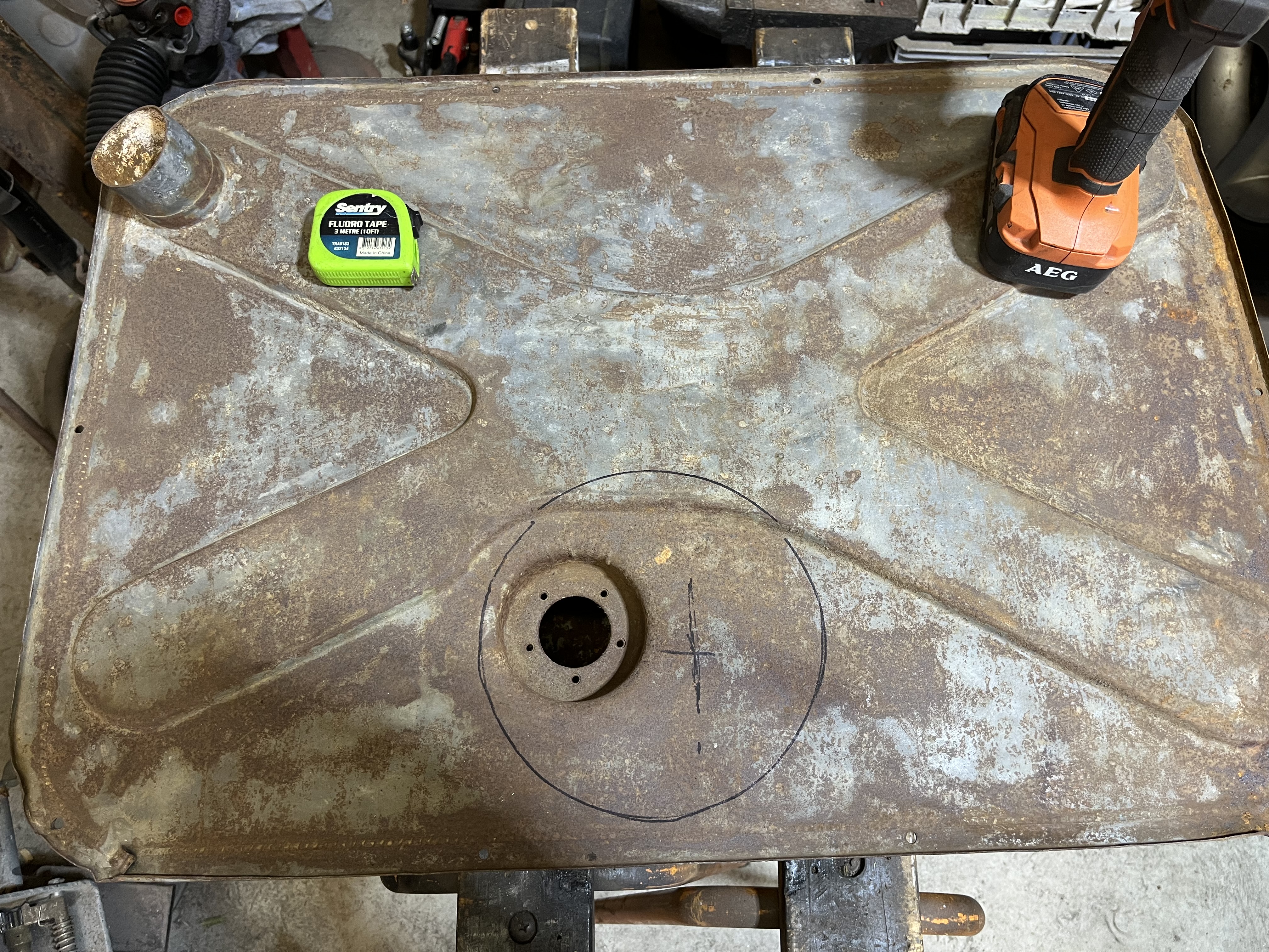

Marked out on my tank where I’m thinking of putting the pump, when I look at Blacky’s tank it looks way bigger :roll: :roll: maybe just an elusion, not going to cut anything out until the pump arrives

Looks like it will fit nicely Neil.

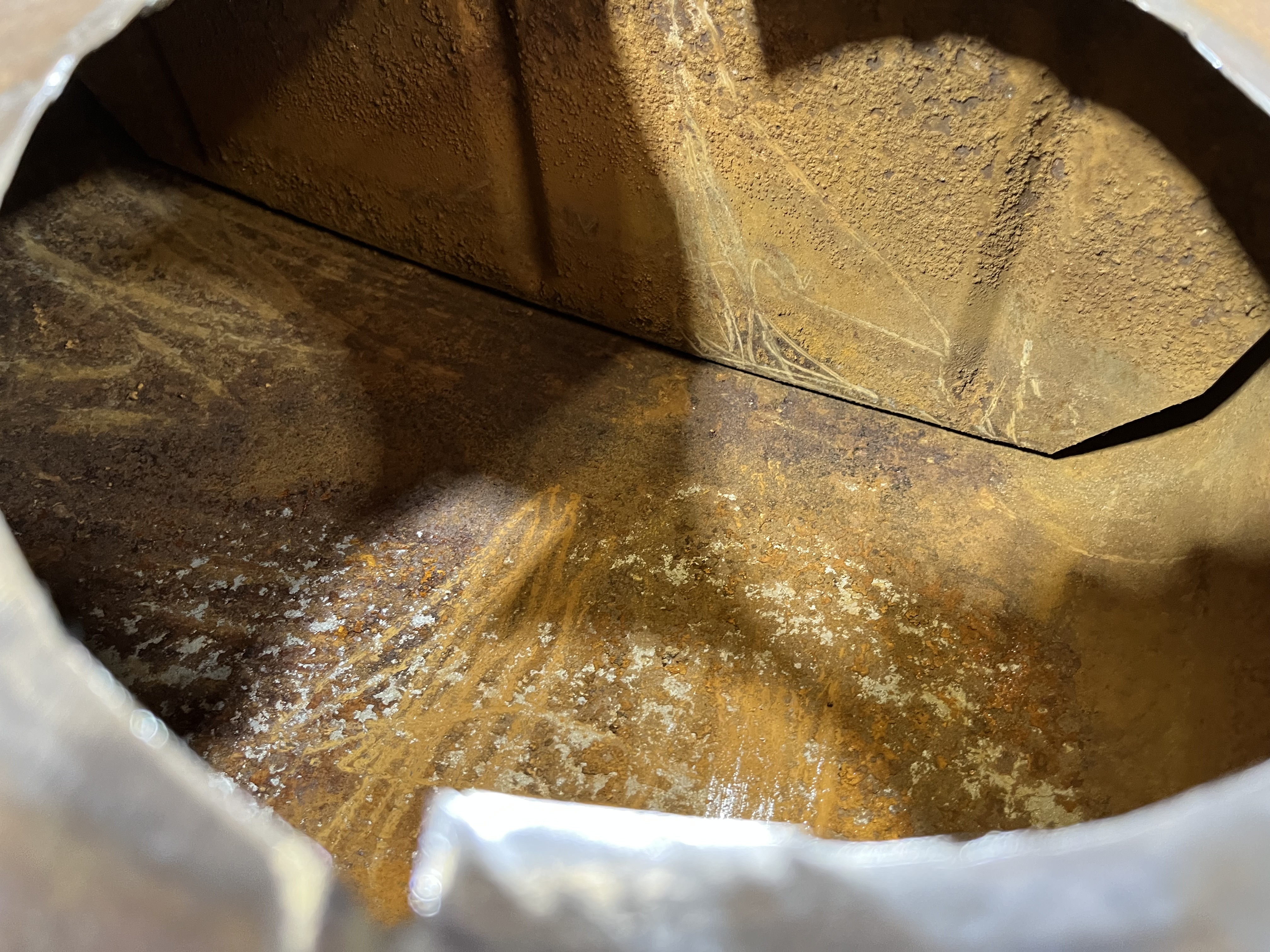

Amateur that I am went to fit the mounting ring for the pump, made my first cut to find that there is a baffle across the tank not w quite in the middle, repair number one to said tank.
Said baffle
Moved across to the side, probably closer to where Blacky has the Rattler tank and fitted the ring

Clay do you reckon I do a citric clean out of the fuel tank, never used citric acid to do this sort of think before.
Posts: 14294
Re: Neil's FB Station Wagon
Either citric acid or molasses 👍
Posts: 2824
Cheers Blacky how much do you think I would need to put in the tank, my idea obviously is to fill the tank and just let it soak.
Posts: 14294
With either method I would make a tank a bit bigger than the fuel tank and completely submerse it - you could do a half at a time though if it will fit into something you already have
